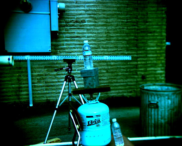

Presenting the most pathetic hybrid shot on spudfiles :roll: :D
Two things of interest, the blow-by starts to move the target before the projectile actually exited the muzzle, and the amount of time the tray gets stuck to the backstop :)
This was at 4x, but with a 2 foot barrel and just 20mL of chamber volume, that's a C:B ratio of around 0.12:1 :roll: so hardly surprising. I'm hoping to take it higher but it will need some mods to allow it to keep the disk in place, watch this space.
edit: took it to 10x, much better :D oh and in spite of the tiny C:B ratio, quite friggin deafening!

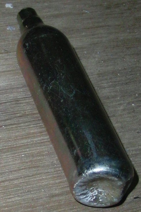

I'll probably take it over 10x too, in the meantime check out the damage to the CO<sub>2</sub> capsule ammunition after just 2 shots :D

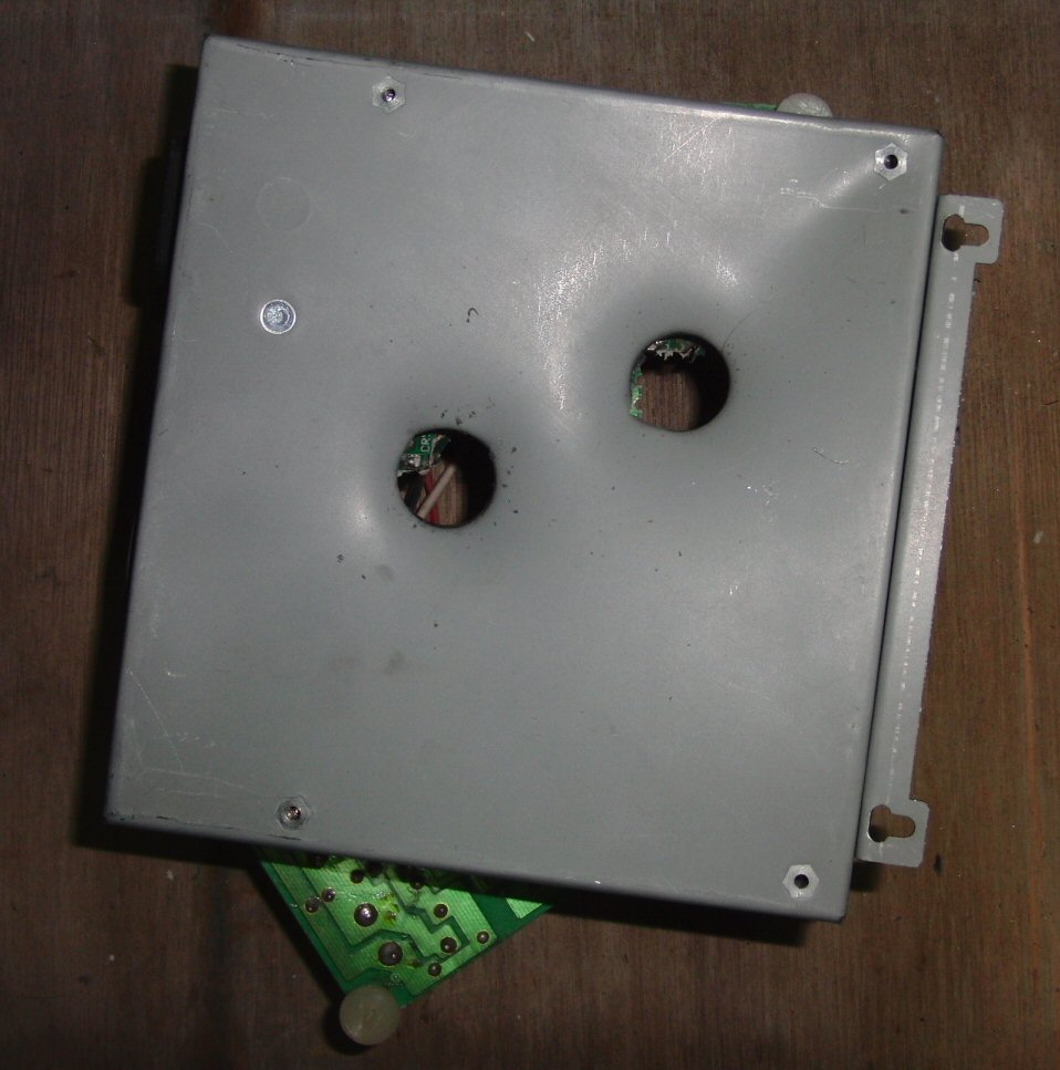

Here it is at 11x, straight through a biscuit tin lid and the 1/2" ply box behind it, would have gone through both sides were it not for the solid granite backstop.

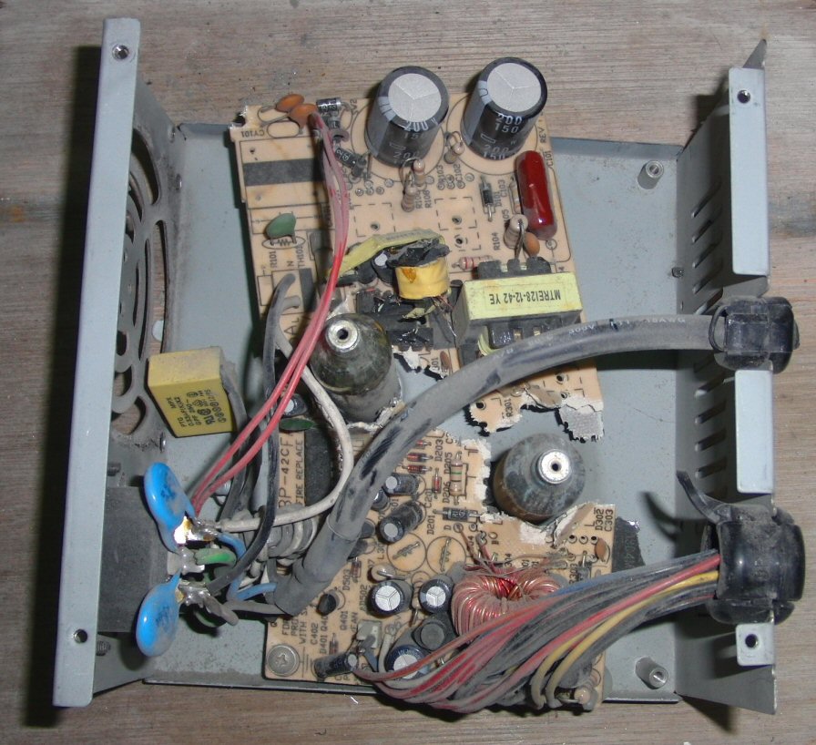

Target is a PC power supply, in both real time and at 420 frames per second, again it doesn't quite communicate how loud it is. My HPA pneumatic 0.75" failed to go through similar metal, hybrids win again :roll:
Here's the power supply after I opened it up, very modern art :) note how dusty it is from years of neglect, which is the "smoke" just visible in the videos after impact.
0.75&amp;quot; holes in sheet metal make quite an impression, especially to someone raised with pen guns :D
0.75&quot; holes in sheet metal make quite an impression, especially to someone raised with pen guns :D

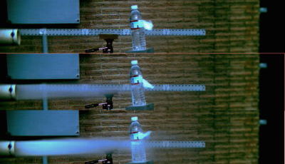

Two things of interest, the blow-by starts to move the target before the projectile actually exited the muzzle, and the amount of time the tray gets stuck to the backstop Smile
I noticed the same thing on high speed shots. Here is a 3 frame sequence from some HS video. The blast is peeling the label off the bottle before the projectile exits.
3 frames of HS video before the projectile exited the barrel.
3 frames.jpg (24.04 KiB) Viewed 2951 times
Frame before the label comes lose.

Hmm... this doesn't actually seem to be indicative of all that much energy. I've shot air rifles at empty CO2 cartridges before, and they usually look like that after just a shot or two.
Would it be possible to get an actual chrony reading?
