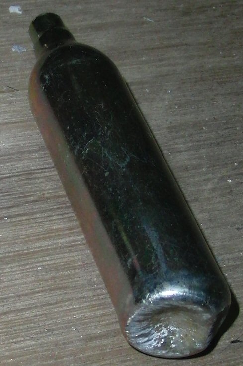

I'll probably take it over 10x too, in the meantime check out the damage to the CO<sub>2</sub> capsule ammunition after just 2 shots :D

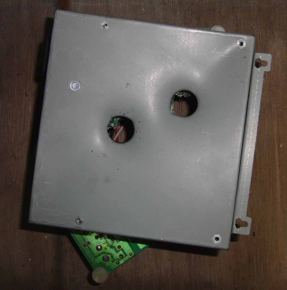

Target is a PC power supply, in both real time and at 420 frames per second, again it doesn't quite communicate how loud it is. My HPA pneumatic 0.75" failed to go through similar metal, hybrids win again :roll:

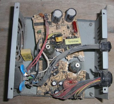

Here's the power supply after I opened it up, very modern art :) note how dusty it is from years of neglect, which is the "smoke" just visible in the videos after impact.
0.75&amp;quot; holes in sheet metal make quite an impression, especially to someone raised with pen guns :D
0.75&quot; holes in sheet metal make quite an impression, especially to someone raised with pen guns :D

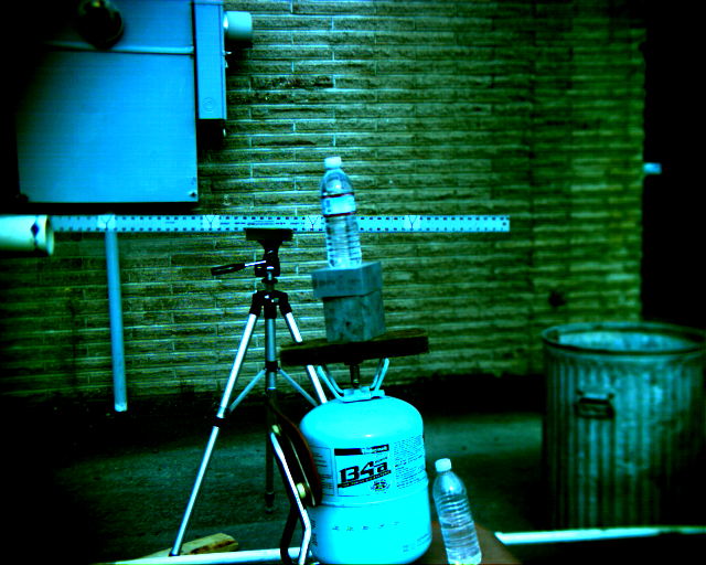

I noticed the same thing on high speed shots. Here is a 3 frame sequence from some HS video. The blast is peeling the label off the bottle before the projectile exits.
3 frames of HS video before the projectile exited the barrel.
3 frames.jpg (24.04 KiB) Viewed 3314 times
Frame before the label comes lose.

Hmm... this doesn't actually seem to be indicative of all that much energy. I've shot air rifles at empty CO2 cartridges before, and they usually look like that after just a shot or two.
