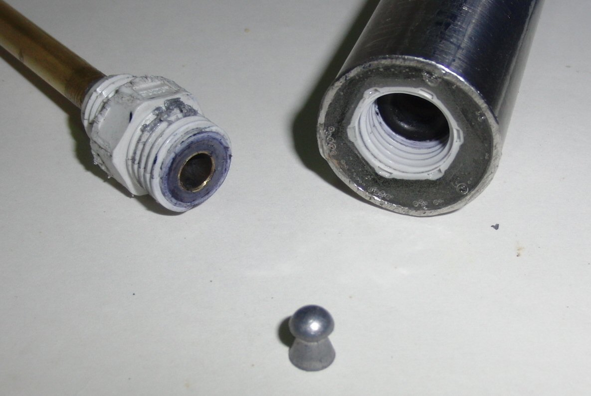

Ammunition is a 0.22" airgun pellet (barrel is 5.5mm I/D brass tube), I didn't chrony it but to be honest muzzle energy isn't that impressive - however as someone accustomed to HPA launchers I'm not easily impressed :roll: a pellet at 6x made a big dent in 0.6mm steel sheet but did not penetrate. My PCPs firing the same pellet at 850-900 fps will happily punch through the same target.

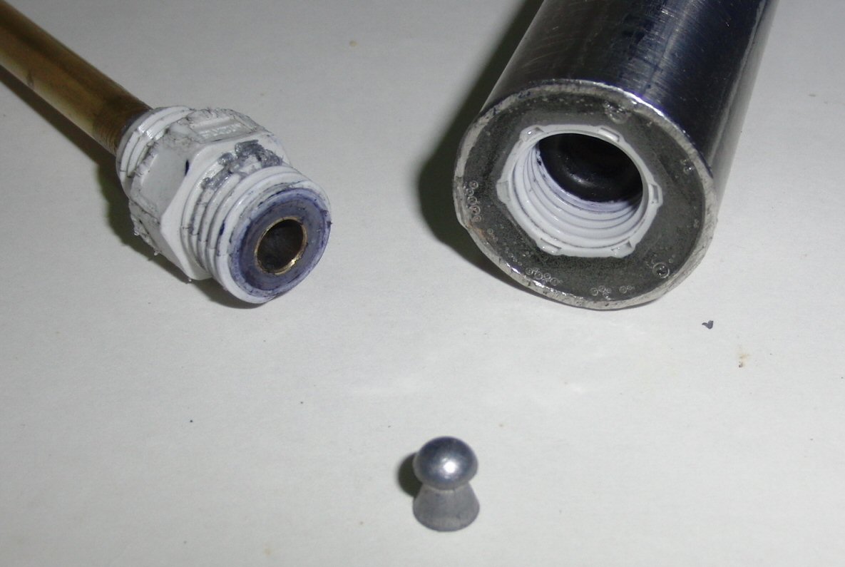

detail of the breech and ammunition.  The threaded portion is taken from an electrical connector set in epoxy, note the chamber wall thickness.

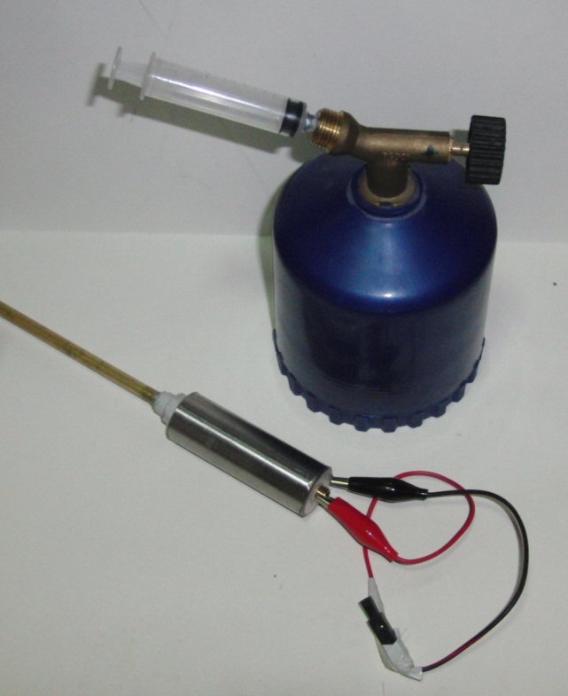

fuelling and firing setup, with blowlamp butane/propane fuel source, syringe meter and cigarette lighter piezo ignition.
