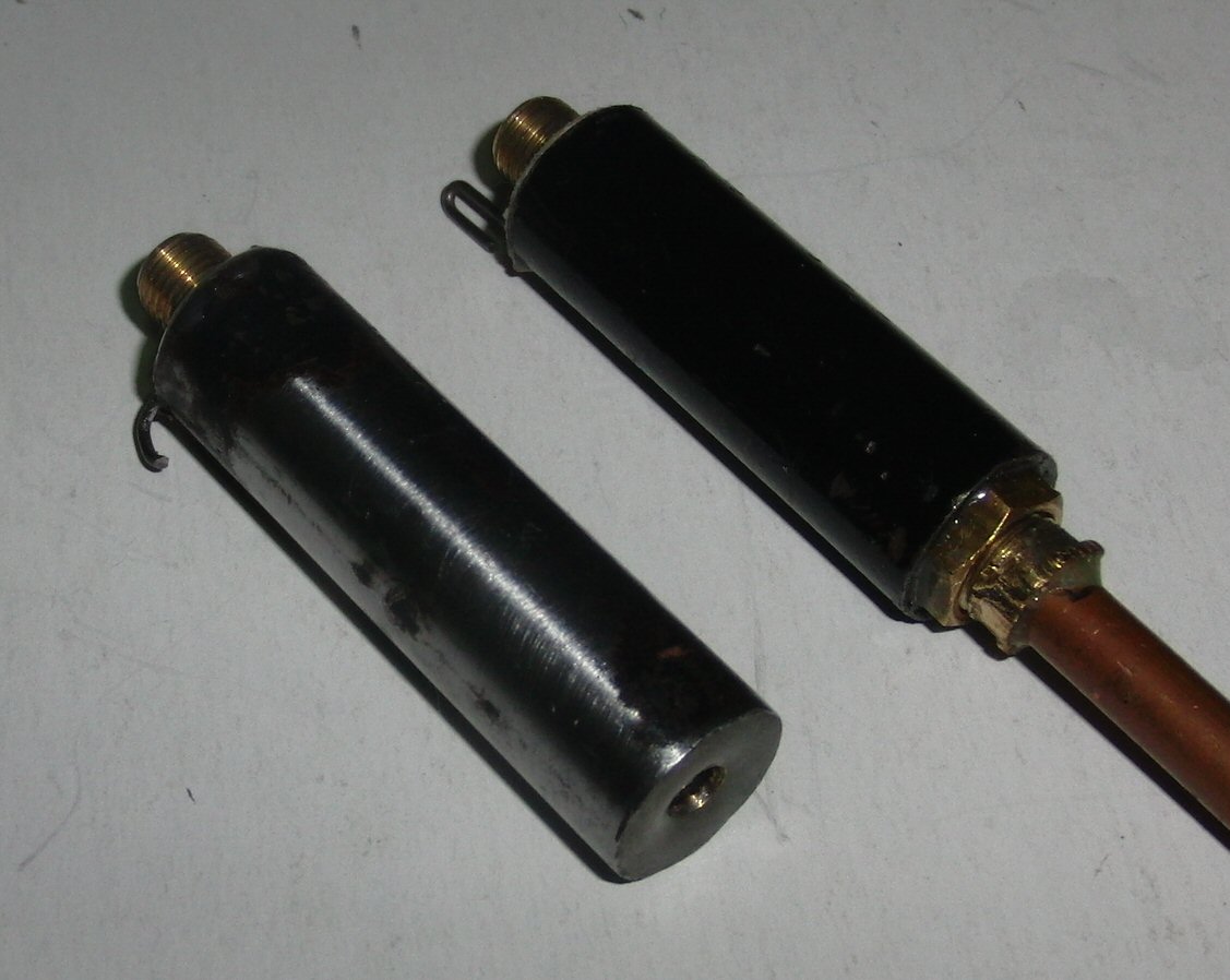

dewey-1 wrote:If you added more epoxy around the valve and the case lead, it may prevent the arcing. Any sharp points and the HV likes to travel to the point because it is more directional versus a circular ball shape.
Add as much epoxy as possible without interfering with the air inflation device.
The problem is the spark gap is too big internally. The micro hybrid is of similar construction and didn't arc externally even at 28x.

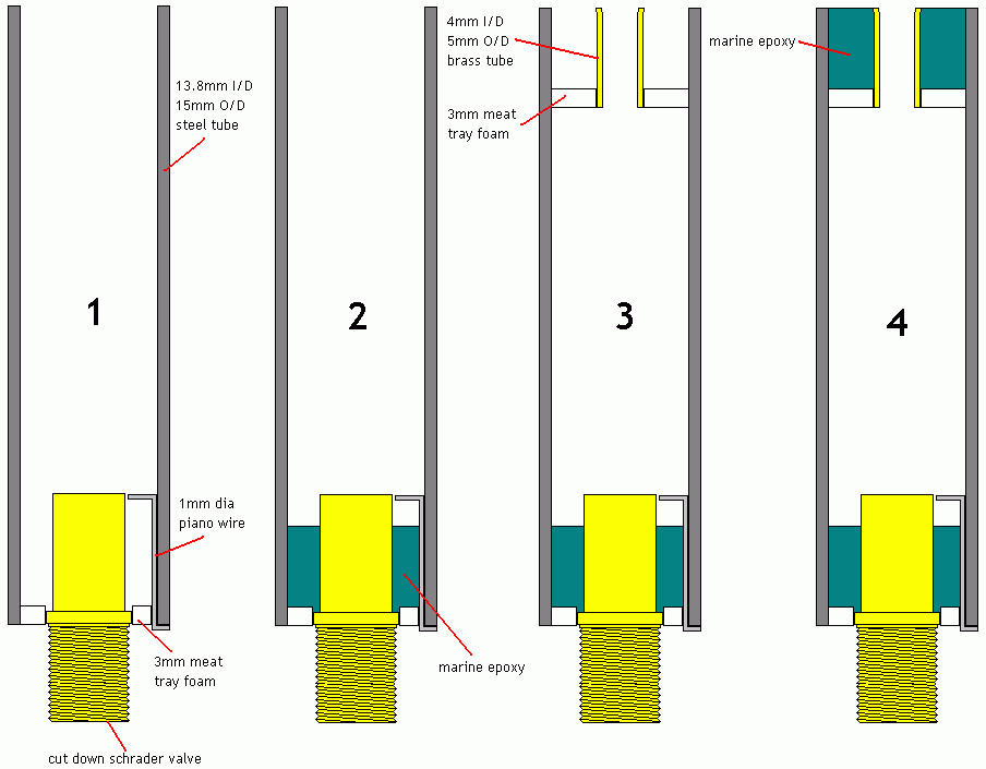

dewey-1 wrote:What are your assembly sequences as far as the epoxy construction?
I think I see where this is going and I like it :) see the attached diagram, basically the components are glued to a foam disk then to the cartridge body using araldite or similar quick setting epoxy, then marine epoxy is poured.
Also what depth are your epoxy pours?
Around 10mm in this case

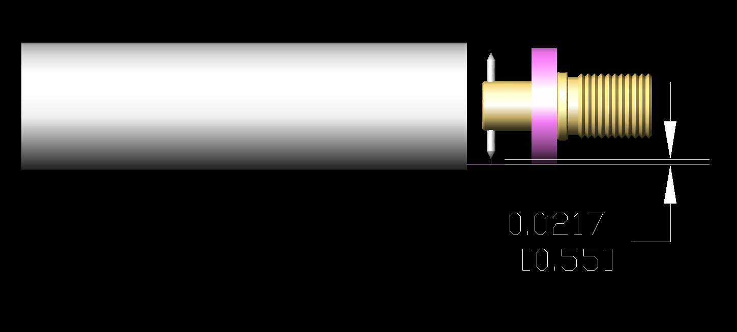

Here is the idea I had for your spark gaps.
Does this seem feasible?
Dual Electrode .55mm Gap
Wed Feb 02, 2011 11:04 am
Plugs don't work in parallel. One will fire and the voltage won't rise to spark the second one. Other than that it should work as a plug if you want the spark next to the chamber wall instead of out near the middle.

Wed Feb 02, 2011 11:26 am
Technician1002 wrote:Plugs don't work in parallel. One will fire and the voltage won't rise to spark the second one. Other than that it should work as a plug if you want the spark next to the chamber wall instead of out near the middle.
I realize that tech, don't forget I was also a Techician back in 1967 .
It is more for redundency as one may wear and also as a method to center the Schrader valve as I will show later.
Fri Feb 04, 2011 2:18 am
I like the idea, much easier to build precisely and the redundancy factor is a big plus for sealed epoxy construction :)

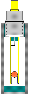

Some progress on this along two lines of development, both still curing:
- cartridge made from 3/4" I/D PVC for a 3/8" bearing projectile, acknowledging that the friction seal is only good for low mixes and compensating with larger volume
- fill rig (basically a sealed chamber with a schrader valve and threaded fitting) that will enable me to fill cartridges without having a schrader on the cartridge itself, possibly using the projectile itself as a "one-way valve" as discussed earlier in this thread. The latter setup (including cartridge) is illustrated below:

Sun Feb 27, 2011 4:10 pm
Pretty cool... although I think some internal pressure will be lost when the ball gets shifted back to the seal position...

Mon Feb 28, 2011 1:27 am
Gun Freak wrote:I think some internal pressure will be lost when the ball gets shifted back to the seal position...
Fair point but if you dump the chamber pressure fast enough while holding the cartridge vertially as shown in the diagram, it should seal up almost instantaneously, in the same way a piston opens quickly in an exhaust valve.
