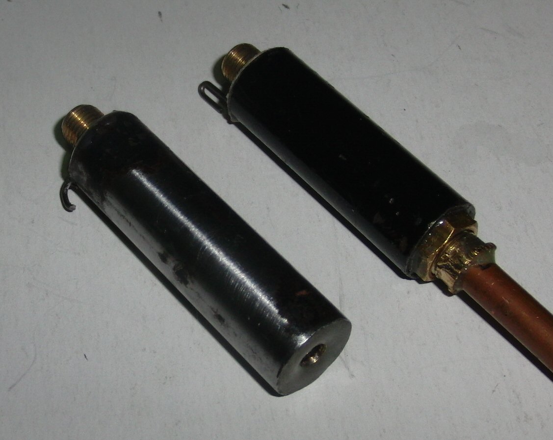

The problem is the spark gap is too big internally. The micro hybrid is of similar construction and didn't arc externally even at 28x.dewey-1 wrote:If you added more epoxy around the valve and the case lead, it may prevent the arcing. Any sharp points and the HV likes to travel to the point because it is more directional versus a circular ball shape.
Add as much epoxy as possible without interfering with the air inflation device.

The micro has literally the width of a paper, with the cartridge I figured it wouldn't take such a high mix so I was a bit more sloppy, there's more than 1mm.dewey-1 wrote:So what was the gap for each one?
sweet!I am doing some 3D CAD drawings for your cartridge.
Length of your Schrader valve (including threaded portion) - 20.0mm
What is the minimum height of threaded area that will work for air fill device - 6.5mm
Cartridge dimensions that you want:
Length: 52.5mm
OD: 15.0mm
electrode OD: 1.0mm, stops at the same level as the schrader as per the diagram.

What are your assembly sequences as far as the epoxy construction?
Which end do you start with?
Also what depth are your epoxy pours? 6mm to ?
A max spark gap I would thick operable is .5mm or .020" down to .2mm or .008".
As I look at the dimensions to make drawings, it looks as though the max difference from Schrader to your electrodes OD is 1.5mm or .060".
You should have at minimum, about 3 times your spark gap opening.

I would definitely be on the lookout for some suitable sized steel, but given the performance of the micro hybrid even at 28x, I'm not sure it would be a worthwhile project to follow through.Lockednloaded wrote:will you be replacing the 4mm barrel with stainless steel so that it will handle more shots before you have to replace it?
It's cereal guyI like the new avatar, try flipping it the other way so it looks like he's saying your post
I think I see where this is going and I like itdewey-1 wrote:What are your assembly sequences as far as the epoxy construction?
Around 10mm in this caseAlso what depth are your epoxy pours?
0.5mm is what I usually aim for, just barely not touching, though again in this case with the cartridge the work was a bit sloppy.A max spark gap I would think operable is .5mm or .020" down to .2mm or .008".
If I have the theory right, it depends on mix number, ie the higher the mix number, the bigger the difference between internal and external gap should be.It looks as though the max difference from Schrader to your electrodes OD is 1.5mm or .060". You should have at minimum, about 3 times your spark gap opening.
I'd like to hear them, currently I'd using springy steel we call "piano wire", I think it's "music wire" in the states.I have some other ideas for the electrode. What is your electrode material made of?
