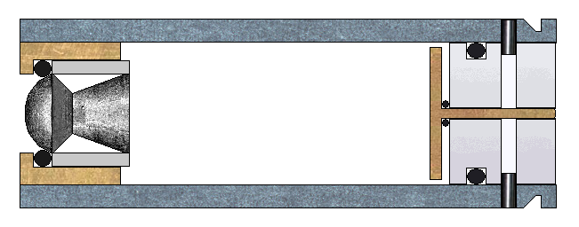

Sat Aug 06, 2011 11:28 am

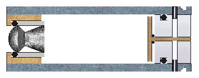

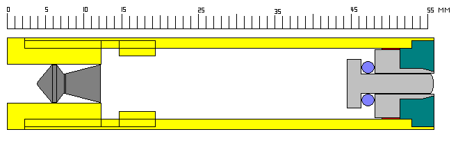

Having another go at this with a more precisely defined spark gap:

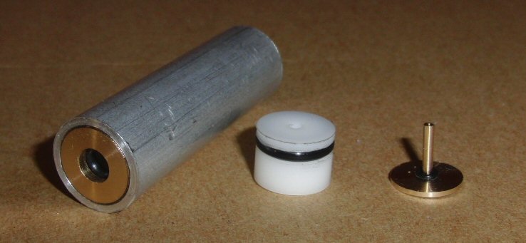

Sun Sep 11, 2011 10:20 am

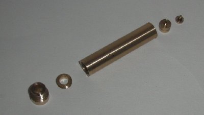

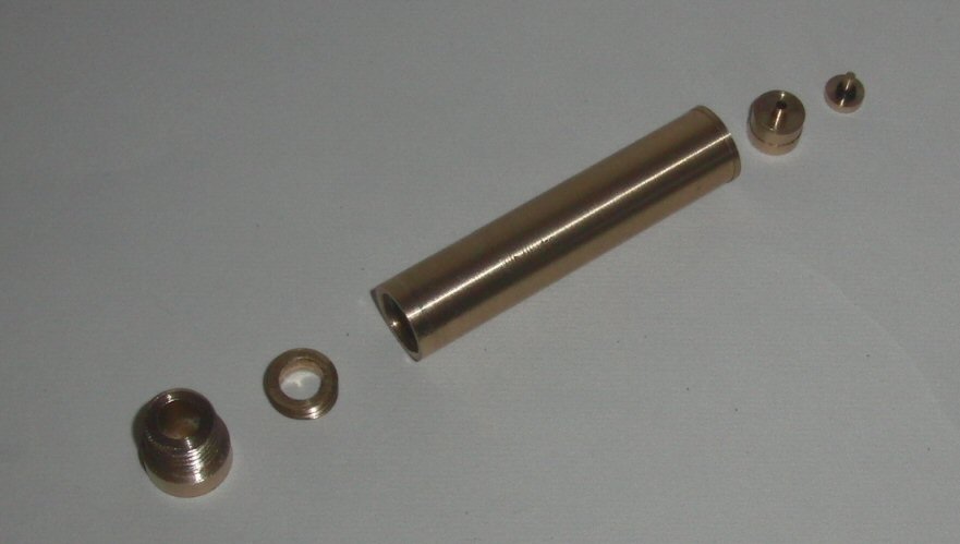

Another <s>blind stab at</s> work in progress on this idea following this discussion:
cartridge with endcap and fill valve/electrode, all that's left is the holes for the retaining pin in both the body and the endcap

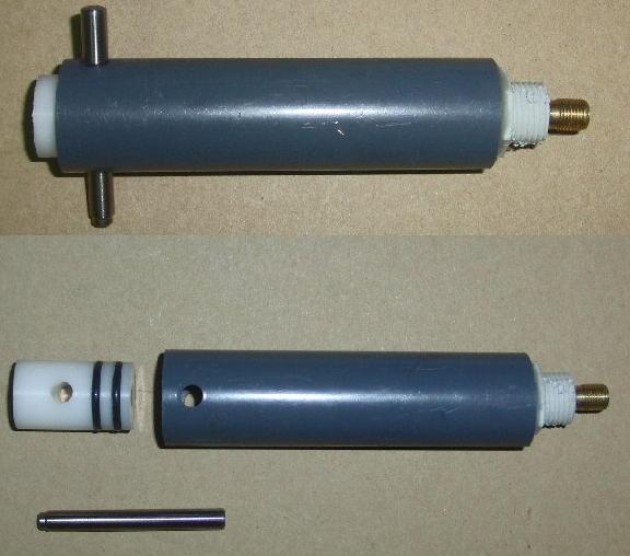

Tue Sep 13, 2011 12:14 am

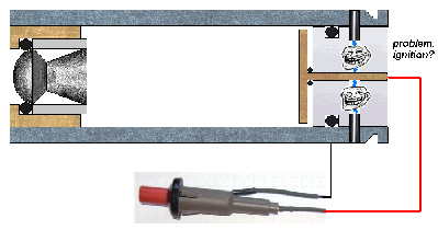

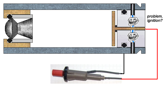

Some mixed results:
fill rig - win! - no leaks, cartridge held pressure beautifully. Still a bit fiddly but it can be refined.
ignition - fail! - click click click... and I think I know why, might have missed an obvious short point with the retaining pins...
Tue Sep 13, 2011 8:14 am
don't tell me there is a hole all the way through the plug...
if yes then FAIL :D

Tue Sep 13, 2011 11:41 am
POLAND_SPUD wrote:don't tell me there is a hole all the way through the plug...
if yes then FAIL :D
There has to be, otherwise you can't push the pins in far enough to free the plug... going to try with some delrin plugs, which will probably shear if I'm lucky enough to get it to work :D

Here it is, closed and open. The schrader fitting is from my original fill rig, now permanently epoxied in place.
Hotwired
Posts: 2599
Location: UK
Tue Sep 13, 2011 11:49 am
if yes then FAIL :D
I don't follow why you're using pins
If it needs to be flush then grub screws or even countersunk screws will be usable.
Tue Sep 13, 2011 11:59 am
Linonophobia :) but you're right, and threading Delrin is a piece of cake anyway.
