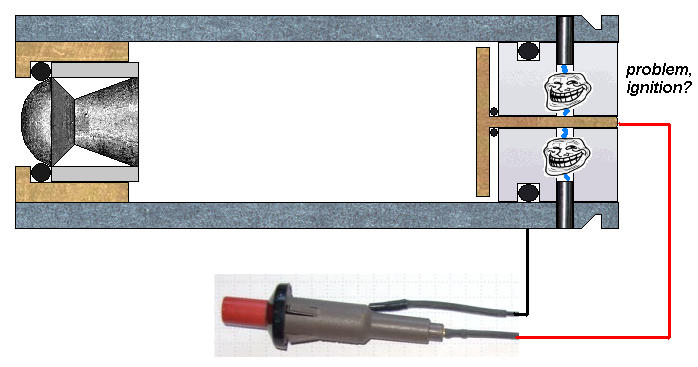

Having another go at this with a more precisely defined spark gap:

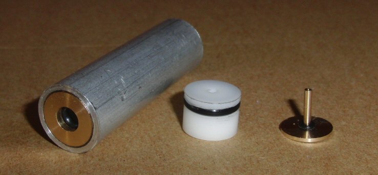

Another <s>blind stab at</s> work in progress on this idea following this discussion:
cartridge with endcap and fill valve/electrode, all that's left is the holes for the retaining pin in both the body and the endcap
Some mixed results:
fill rig - win! - no leaks, cartridge held pressure beautifully. Still a bit fiddly but it can be refined.
ignition - fail! - click click click... and I think I know why, might have missed an obvious short point with the retaining pins...
don't tell me there is a hole all the way through the plug...
if yes then FAIL :D
warhead052
Posts: 1769
Wow, its amazing how such simple mistakes are overlooked. Glad to hear the fill rig worked. Any pictures of it?
POLAND_SPUD wrote:don't tell me there is a hole all the way through the plug...
if yes then FAIL :D
There has to be, otherwise you can't push the pins in far enough to free the plug... going to try with some delrin plugs, which will probably shear if I'm lucky enough to get it to work :D
Here it is, closed and open. The schrader fitting is from my original fill rig, now permanently epoxied in place.
if yes then FAIL :D
I don't follow why you're using pins
If it needs to be flush then grub screws or even countersunk screws will be usable.
Linonophobia :) but you're right, and threading Delrin is a piece of cake anyway.
In my earlier prediction I wrote:going to try with some delrin plugs, which will probably shear if I'm lucky enough to get it to work :D
One carefully calculated 10x mix later:
HAHAHA!
YES!
*ahem*
Of course the delrin pins sheared as predicted and the end plug blew out, but on the plus side:
- the fill rig worked perfectly
- the detent sealed and held pressure, then released the projectile in spite of the end plug blowout.
Good result in my book :) now to refine it, I have some ideas to scribble.
