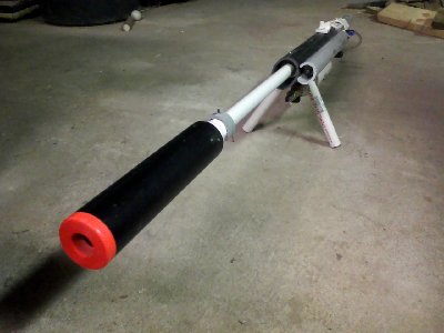

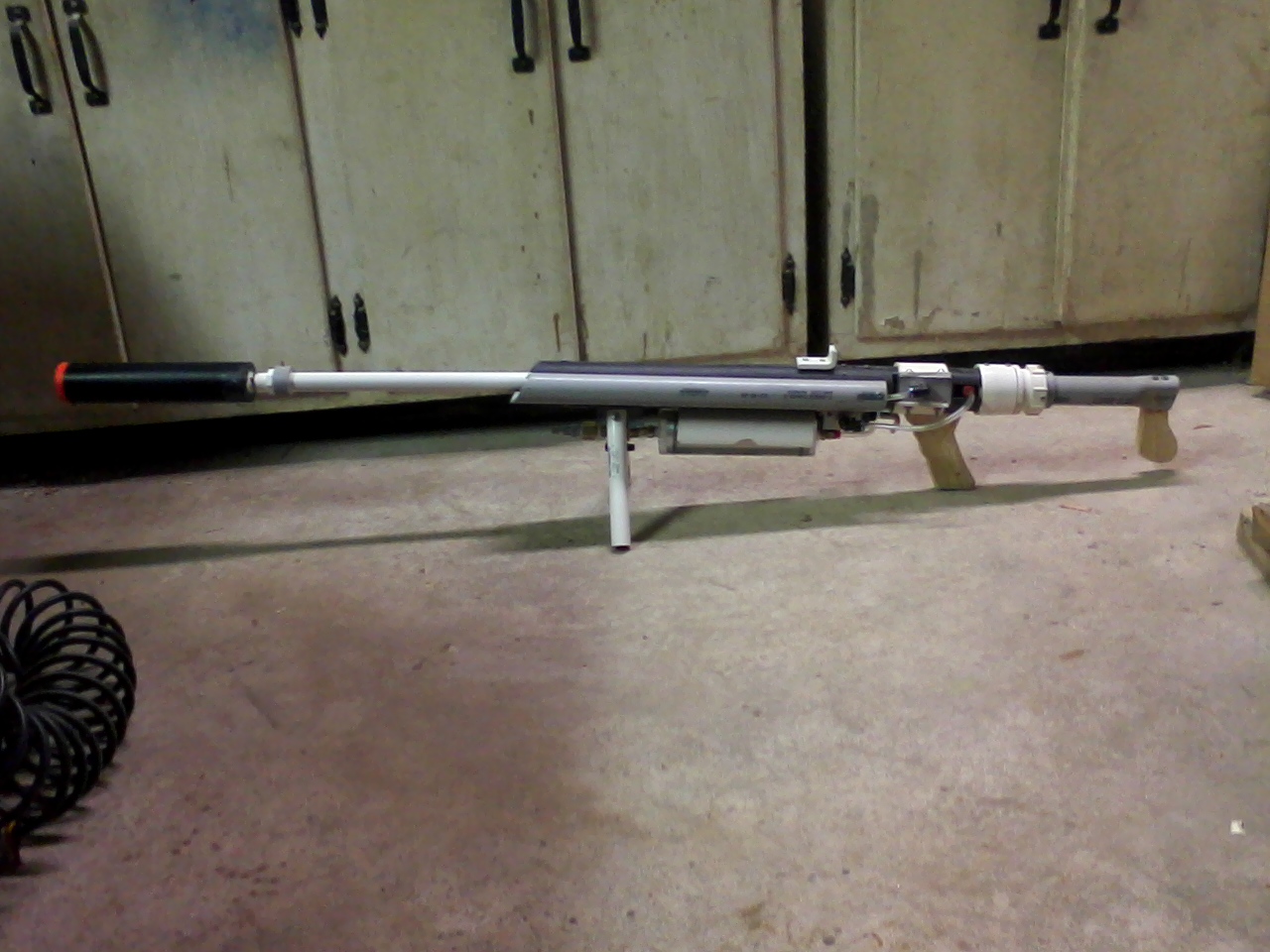

Here is what I have made as my latest.

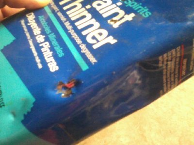

A bolt action gun, fully portable, operating at 120psi. My clippard tank is the biggest limitation, rated for 250psi, so I do not see a need to go too much higher. I have a DCV and QEV operating the pneumatic system. I am estimating 300fps.

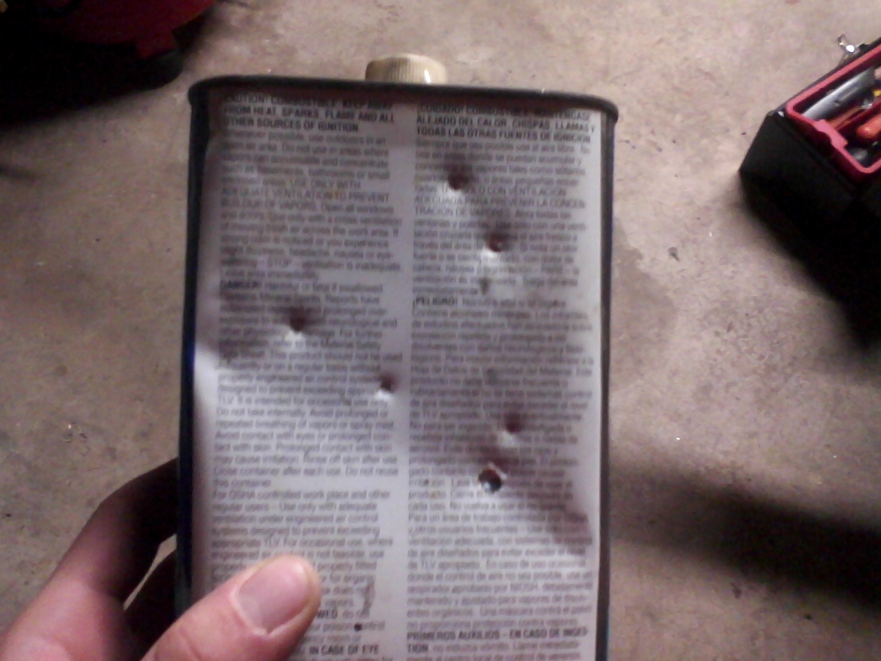

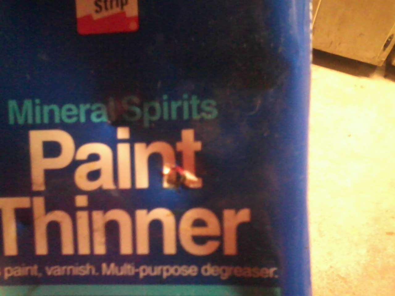

After some test shots at 20ft at an empty paint thinner can i caught ricochet and got a nasty welt, so this thing has some power. I attempted at sights and bi-pod for the first time and both are working somewhat.
What do you guys think, I have learned a lot form this project and I hope to learn more from the comments, so have at it :lol:
UPDATE:
Damage pics on a paint thinner can, ranging from 130psi to 120psi with 6mm air-soft pellets

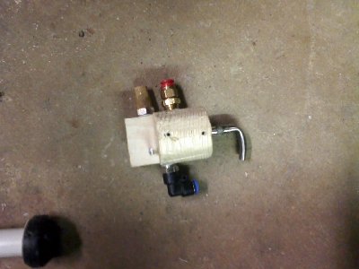

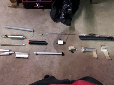

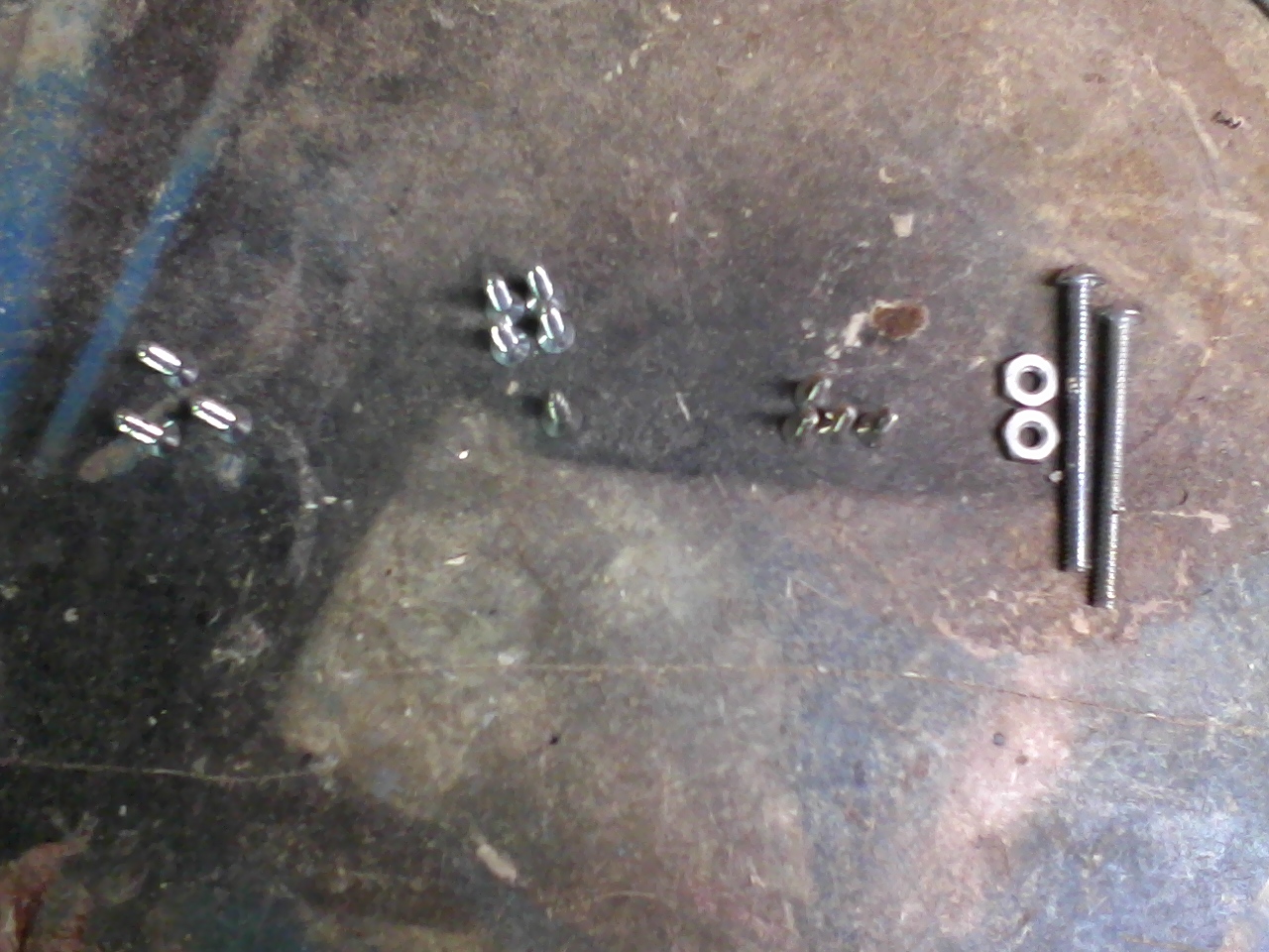

All the parts
All the parts

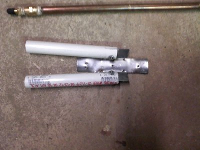

3ft, 6mm stainless steel tube used as barrel

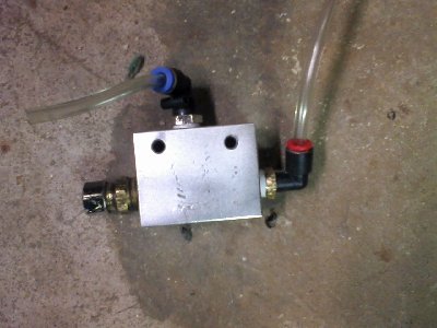

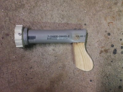

DCV, 3 way 2 position, pull

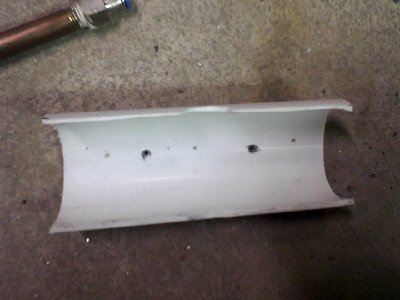

barrel shroud
barrel shroud

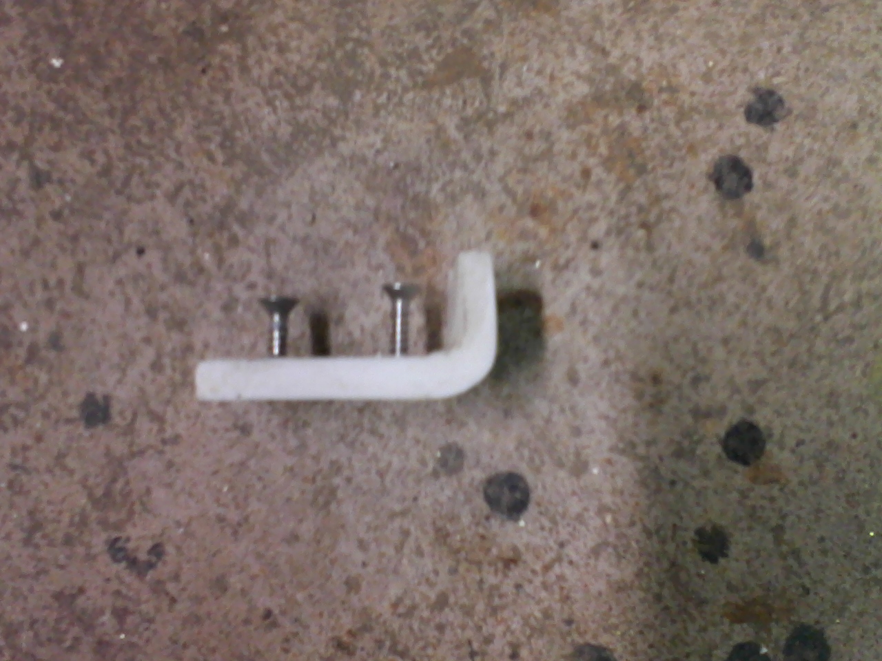

rear sight
rear sight

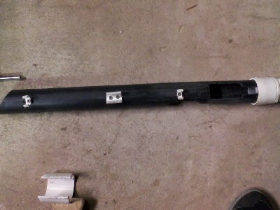

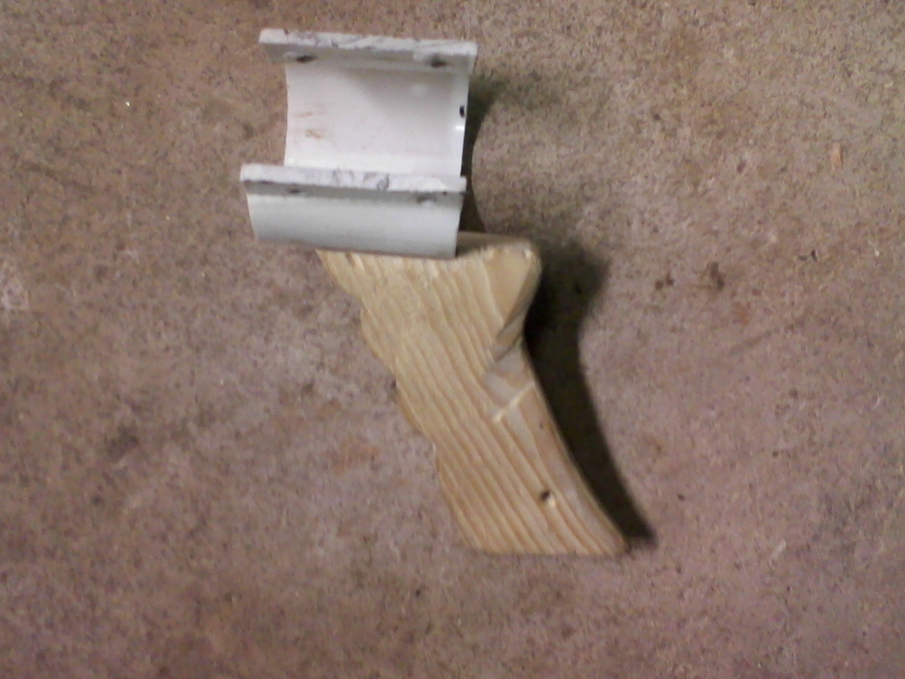

main tank mount
main tank mount

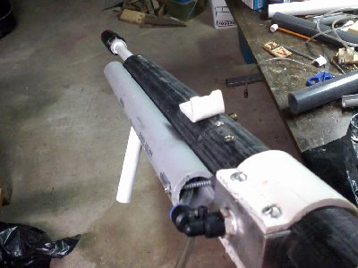

bipod
bipod

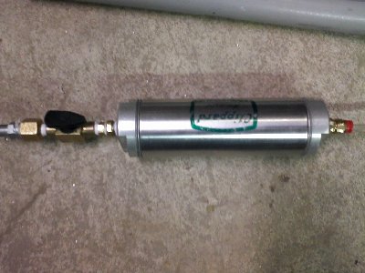

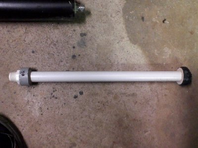

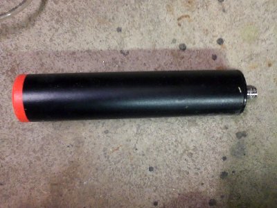

secondary tank
secondary tank
main tank
main tank

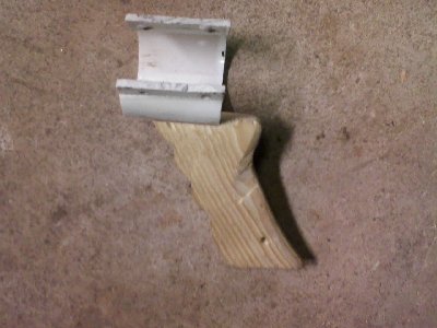

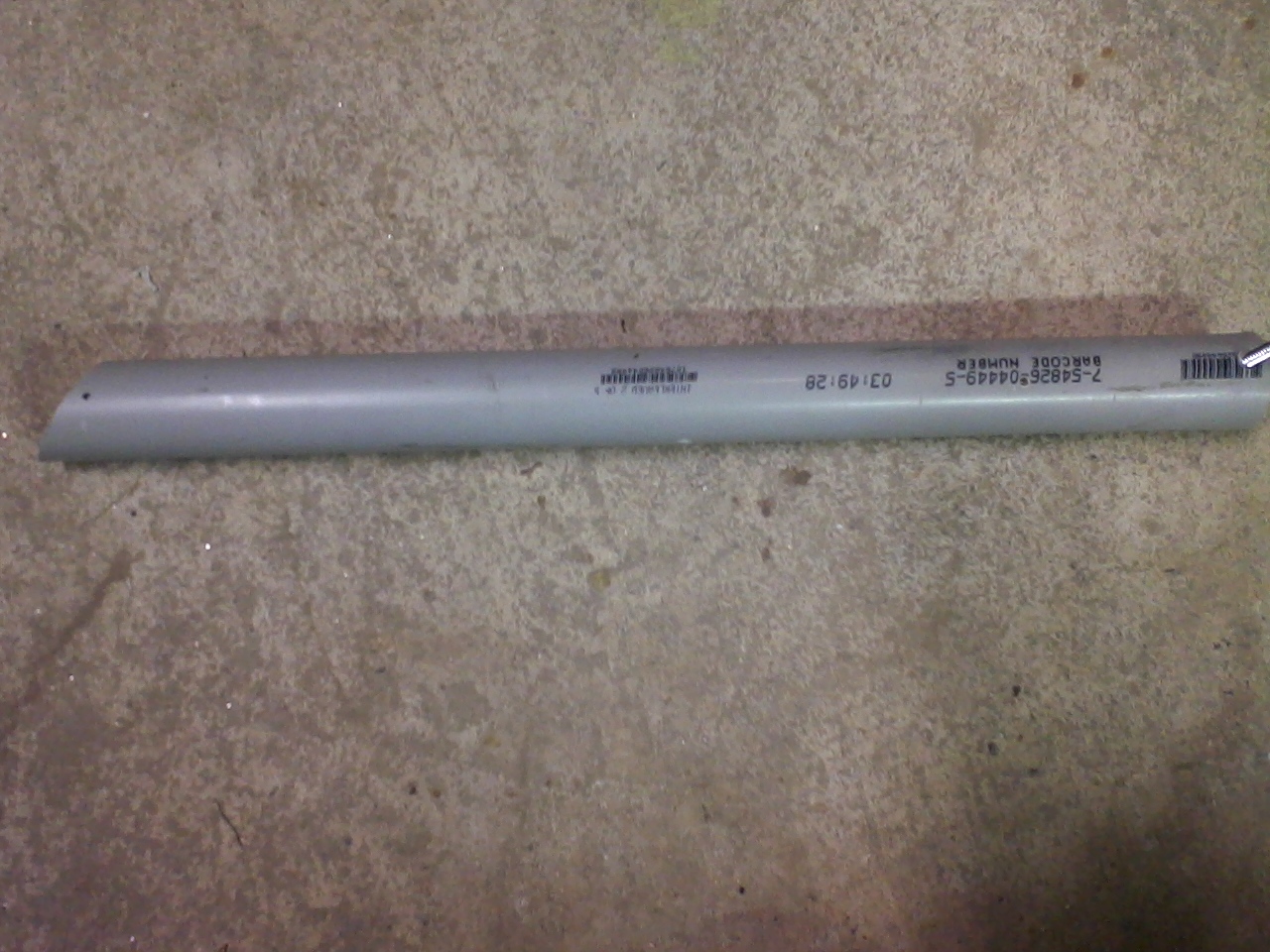

screw on stock
screw on stock
protective cover for the secondary tank, more for looks

that tank can probably take a little bit more but if it xplodes don't quote me :-D
not bad at all
ohh and.... >>>
Reason: Fixed video.
Mon Dec 24, 2012 6:21 am
Veeeery nice effort, lick of paint and a proper scope wount would top it off nicely :) videos?

It looks very familiar to me :lol: damage are not bad for the pressure, I got the same result when using similar pressure. Nice main chamber, what is it?

wyz2285 I'm using a clippard accumulator. We used them on our robots back in high school, this one is rated for 250psi. Thanks for the inspiration
