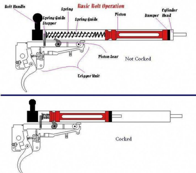

Above wrote ,
Make sense ,
Check out following pic .
https://sniperpedia.com/wp-content/uplo ... 68x432.jpg
*Note: the spring actually goes into piston itself.
Is not drawn in .
Does not sit on back of piston.
As depicted and not seating in piston ( with room for tolerance / loose fit .
It would bind when cocking .
*Also not depicted , the bolt pull handle rear ,
Is connected by which a hole in bolt handle ( loose enough to allow pivoting on a stem so can pivot and guided through external groove guide , when cocking and locking.
The bolt is secured by a screw and washer? into the bolt pull stem .
The stem screws into cylinder .
Make sense ,
Is not drawn in .
