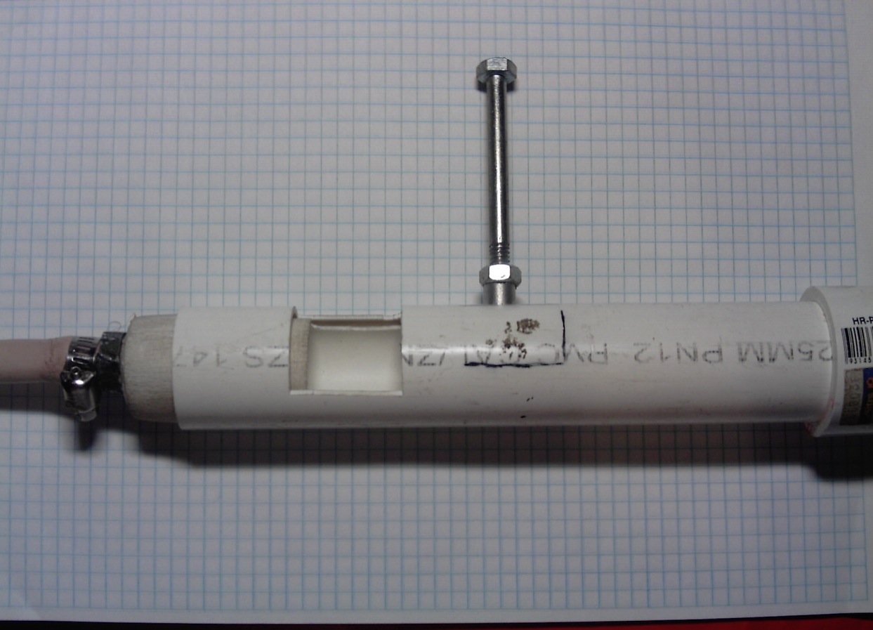

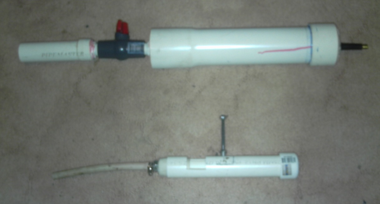

Muuuahhahahaha i have designed another gun.

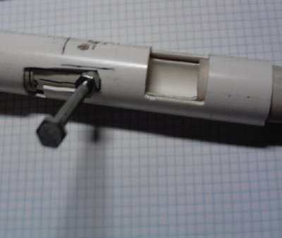

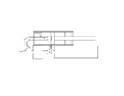

This is a multishot pcp with a bolt action breech loading system, the ammo when it is ready to be loaded is put into the breech by sliding the bolt back and by inserting it into the barrel and kept there by my balloon breech system. the breech is the slid back forward and the balloon seals it against a hole inside the breech on a end cap that has been moddified, air is then put into the secondary chamber from a primary chamber and then that is then sealed off. you then pull the trigger which is some sort of valve..... and the air released then goes up through the pipe in to the breech and threw the barrel. and the cycle is repeated. heres my only drawing of what this should be like, i think this will be my next project some how. i would like to some how connect the secondary chamber refil valve to bolt so when you pull it back it opens the valve and then when you close it, it closes the valve, i was thinking of some sort of gear system and a small ballvalve. If this is made correctly it should by rights have alot of power.
specs:
all pvc, execpt barrel
barrel is 10mm, 8mm id aluminum.
will be pumped up too around 120-150 psi depending on chamber materials and sizes.
the secondary chamber will on a ratio to barrel of c:b 1.2:1 or so
if i have forgotten any thing or i need to add anything to the specs please say.

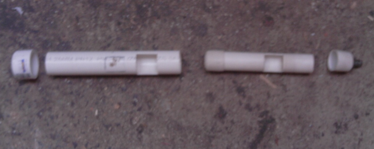

bolt parts
bolt parts

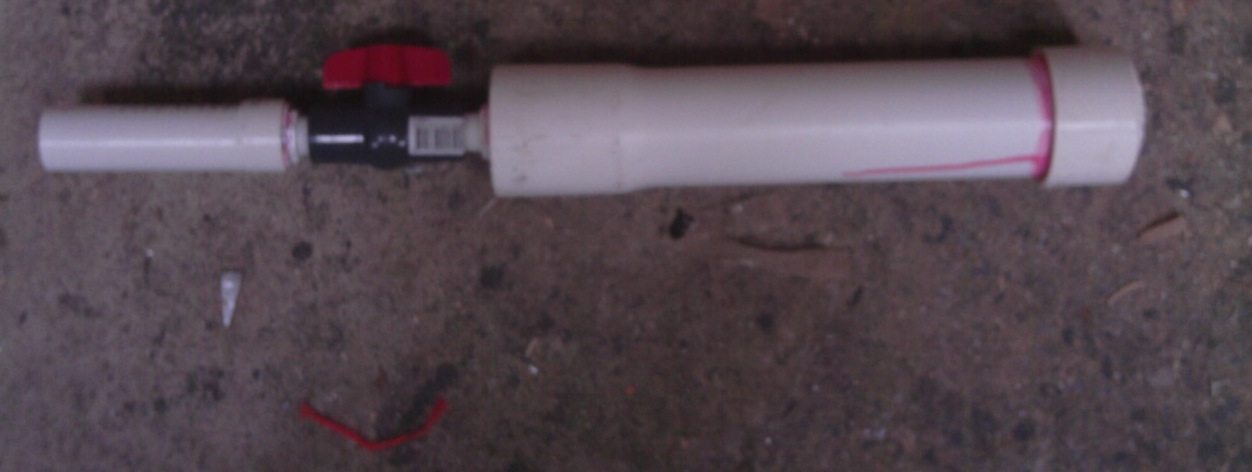

main chamber is huge, and the secondary chamber
breech closed
breech closed

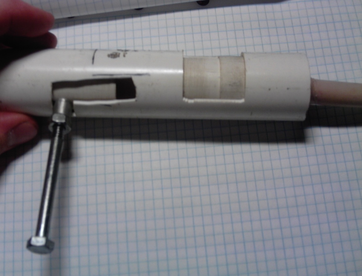

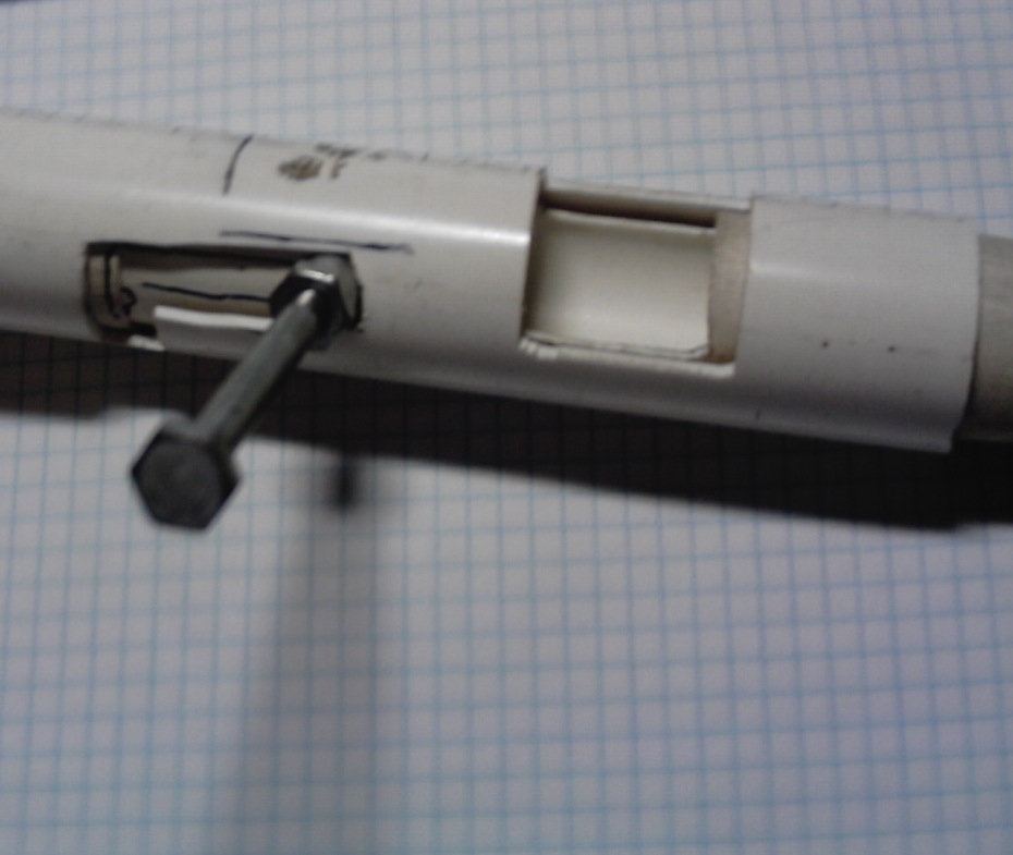

showing bolt open and handle
breech open
breech open

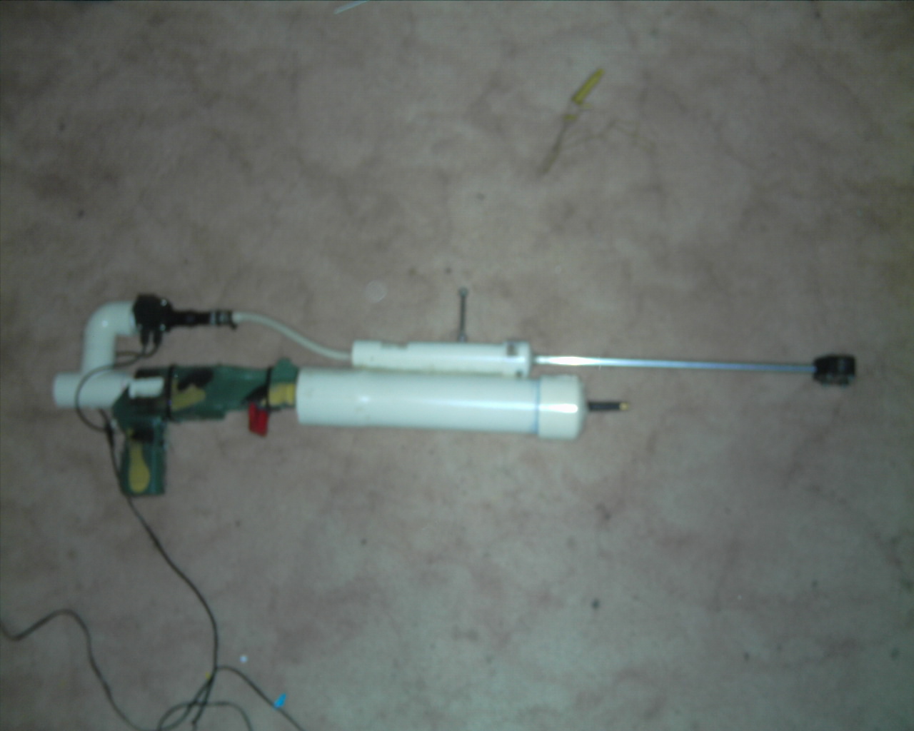

p chamber and s chamber with out second valve, with bolt below
finished  gun w/o bipod

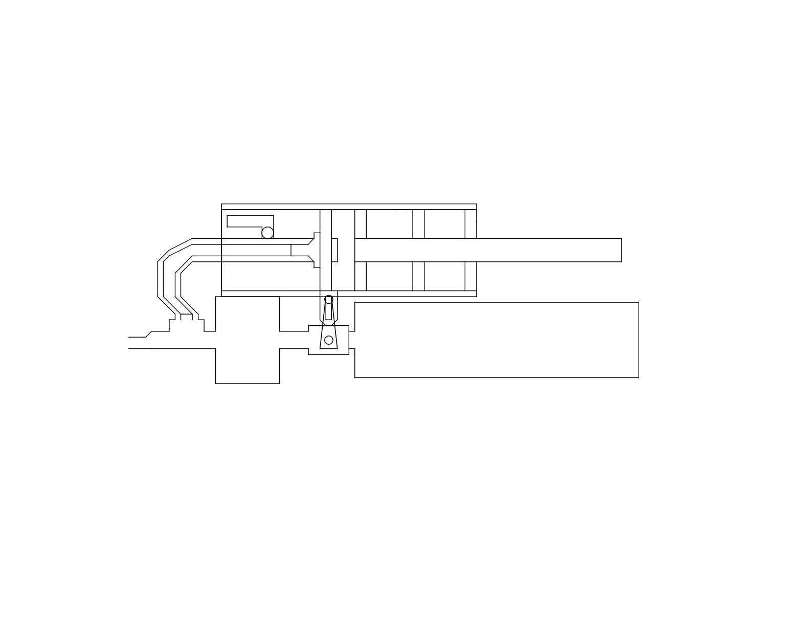

no worrys thanks, hey ive got an updated better diagram of it now bit hard to understand but ill maybe make an animation soon, this is for any one that lives in australia, do you know where i can get a cheap 1/2 qev from.
or more to the point, what sort of valve do you guys recomend i use for this design
