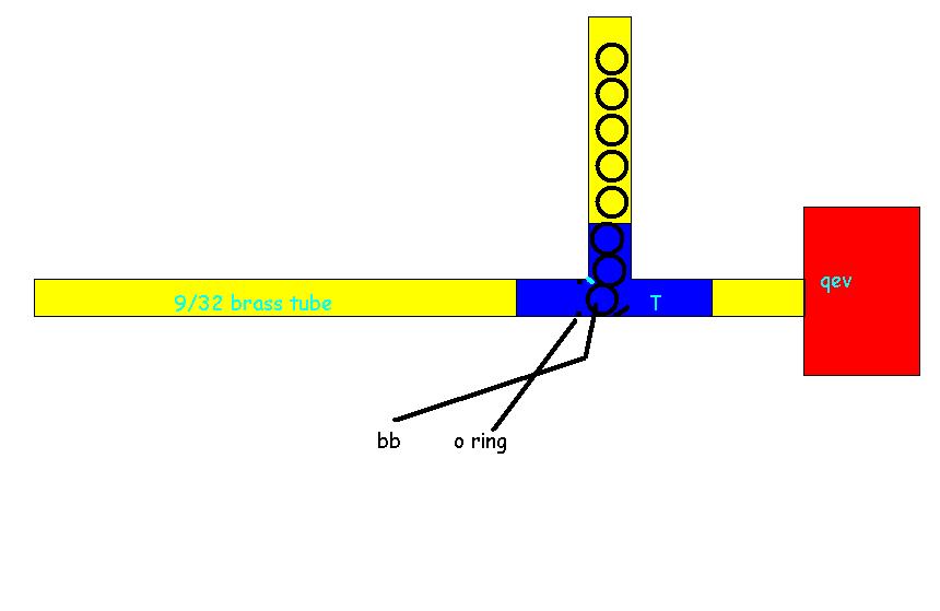

could a very quick and trusty paint diagram be undertaken?
is a spring necessary because i plan to have a stick mag like in the video slightly off vertical or a hopper

It is possible that the feeding mechanism is just a tee with the exhaust port of the QEV on one side, the barrel opposite the QEV, and the magazine perpendicular to the barrel and QEV. (I'm not sure how well I explained that)
That was how I got my first bbmg to work, if you just let a little bit of air go through, it will fire a short burst, but if you let a constant stream of air through, it will be fully automatic.

yes but like the gun in this video i wish for semi auto single shot

That's what you would get with a QEV, since it is only a short burst of air.

no probs jrs im pretty sure i get it, just low on funds at the moment so cant really afford to bugger it up just for learning purposes :D
like this then aye?
like this then aye?

but if he used a bolt he could add a much better magazine than a ~40 cm long vertical tube... so IMO the guy uses an o-ring setup

@carlman yes

a compression fitting is not the best idea here becasue most likely it won't let BBs through... (its ID is lower than the ID of the tube)

its a 6mm compression T, and the tube is 6mm... im only using the structure then epoxy it.

EDIT: 6mm fittings can take 6mm brass tube through it

Me too:) I wonder what the efficiency is as he is using an air compressor. What I dont like though is that the trigger pull (speed) varies the opening time of the valve. This makes it kinda inconsistent. But cool concept anyways.

Carlman wrote:could a very quick and trusty paint diagram be undertaken?
A little late but now that I made a small animation might as well stick it here ;)

Its that simple?
Why havent any of us done this before?
And that Airsoft gun is freakin sweet. Looks like alot of power too...... Although his Chamber is HUGE
Thu Oct 16, 2008 5:22 am
VH_man wrote:Its that simple?
Yep.
Personally, I always wanted to use airgun pellets as ammunition, with this design you're limited to spherical ammunition only and this is why I never went with it.
Not really, but if used at normal compressor pressures instead of 40 psi it would certainly be more impressive.
