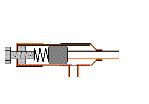

- This is what I'm thinking.
The copper tee could be modified easily with a dremel, and I might replace the endcap with a male/female adapter for servicing. - auto.GIF (3.66 KiB) Viewed 4891 times

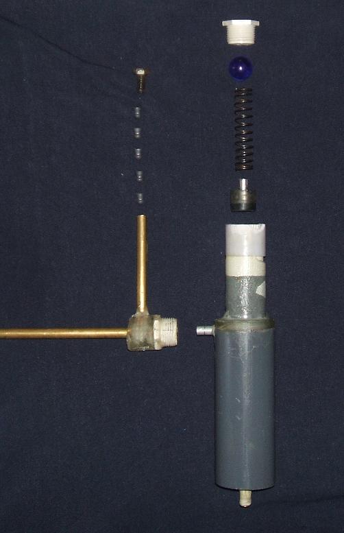

For those of you who wanted pics of the setup, here's an "exploded view" of the valve and magazine units:
That's the point of the design. While it's just covering the piston seat, the spring is enough to hold the air in until pop-off pressure is reached. Once that happens and the piston opens slightly, the whole surface are of the piston is exposed to the pressure and the spring can't handle it, hence the POP!ilovetoblowthingsup wrote:does the spring really seal it with a continuous stream of air coming in? I'm sort of surprised by that.... would've thought it would just stay open the whole time..

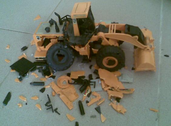

I then took out a little toy digger that I had been wanting to destroy for ages. I extended the magazine in a ghetto manner to fit 30 pellets but as everything was held together with tape it was getting stuck so for the last couple of videos I stuck to the 10 round magazine.
Here's what was left of it, still generally recognisable but now significantly better ventilated
- Image034.jpg (34.81 KiB) Viewed 4809 times
