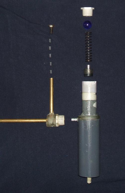

For those of you who wanted pics of the setup, here's an "exploded view" of the valve and magazine units:
That's the point of the design. While it's just covering the piston seat, the spring is enough to hold the air in until pop-off pressure is reached. Once that happens and the piston opens slightly, the whole surface are of the piston is exposed to the pressure and the spring can't handle it, hence the POP!ilovetoblowthingsup wrote:does the spring really seal it with a continuous stream of air coming in? I'm sort of surprised by that.... would've thought it would just stay open the whole time..
Does it have anything to do with the different diameters of the two? (piston tube and firing chamber)
