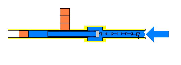

I still prefer the idea of blow-forward than blow-back, somewhat inspired by clide's GB semi I came up with the following, note that the spring is a tension one.
*update* I'm making a prototype of the attached design, should be done by tomorrow. I figure that even if it doesnt work as full auto with a constant flow, it will be a better blow forward valve than the subject of this thread due to less dead space and reduced friction since there aren't any epoxy pistons involved, just tight fitting metal-to-metal tubing.

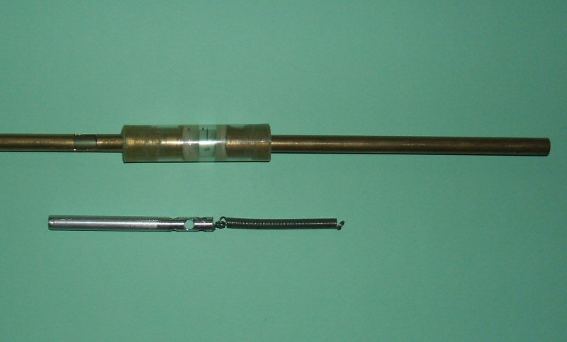

Here's the prototype curing, it'll probably be ready for testing in a few hours.

IT WORKS! IT WORKS!!! FULL AUTO BABY YEAH!!!
*ahem*
yes er, it works. at least the reciprocating bolt does, it cycles full auto with a constant flow of air. I haven'te tried it with ammunition yet, frankly the bolt cycles so quickly that I don't know if gravity feed will cut it.
anyway, in my enthusiasm, the hook holding the spring to the bolt came loose (and out came the bolt flying out of the barrel lolol) so a bit of epoxying is in order, videos to be posted soon :D

spud yeti wrote:If the gravity feed is too slow, will you use a spring loaded magazine, or just try slow the mechanism down a bit?
I'd rather keep it gravity fed, I'll try with a stiffer spring if it doesn't feed.

Whoa! Freekin awesome, dude! At first I was like: "It's just a blow-forward, how the blazes does he think he's going to get auto-fire from it?" Took me a while to see how it worked.
It seems to me that if you run it with some ammo, the increased barrel pressure ought to slow the cycle down a bit, so maybe your grav-mag will still work. If not, you might try steel ammo and a magnet.

You don't need permission to use the design, honestly, have a look here and you'll see that there are hardly any original designs left anymore. The concept I used is essentially identical to this one in principle, just built a little differently.
