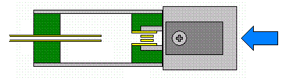

Finally made some progress on this.
After a lot of fiddling around with different configurations, I finally came to the conclusion that any form of forcing cone directing the BBs towards the barrel was causing jams, so I decided to go with a simply cloud, with the barrel protruding into the chamber.
The results were quite dramatic, in the following video you can see that it jammed at first because I overfilled it, but once it empties a little, look at it go!
Next step is to make one with a slightly bigger chamber and the sentry project should be up and running again :)
Here's the internals, simples!

Huh, barrel protruding into the cloud chamber, howd you think of that. It seems like it wouldn't feed well

Lockednloaded wrote:Huh, barrel protruding into the cloud chamber, howd you think of that. It seems like it wouldn't feed well
It seems counterintuitive, but when you think of how a cloud works it makes perfect sense. Some BBMG designs like the Larc M-19 or this one by singularity also use a tube inserted into the chamber to feed. Besides, 800 psi is plenty to agitate the tiny BBs :)
Rate of fire is ridiculous, I was experimenting with a detent seal but the only tubing I have of the right diameter will not release a BB even at high pressure. Still, when you think of real world sentry guns, a high rate of fire is desirable to put as many rounds on target in the short time interval available.

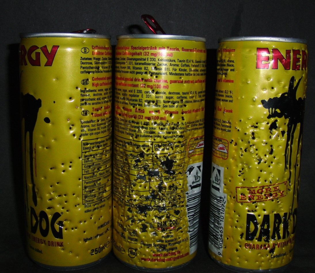

Holy crap that thing is crazy... What was the target? looked like a thin sheet of metal?
Fri Sep 03, 2010 1:59 pm
JDP12 wrote:What was the target? looked like a thin sheet of metal?
Flattened out energy drink can. Works well against free-standing cans too ;)

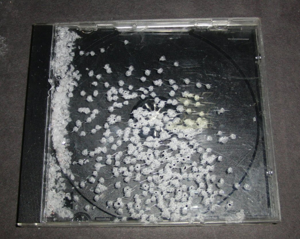

Here, have some clear plastic carnage :)
It's not *that* powerful, in that most shots didn't penetrate the casing, where they did it was due to the "jackhammer effect", but given the size of the ammunition, still quite impressive.
