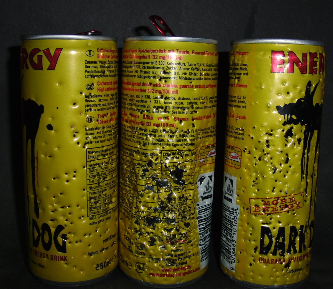

JDP12 wrote:What was the target? looked like a thin sheet of metal?
Flattened out energy drink can. Works well against free-standing cans too ;)

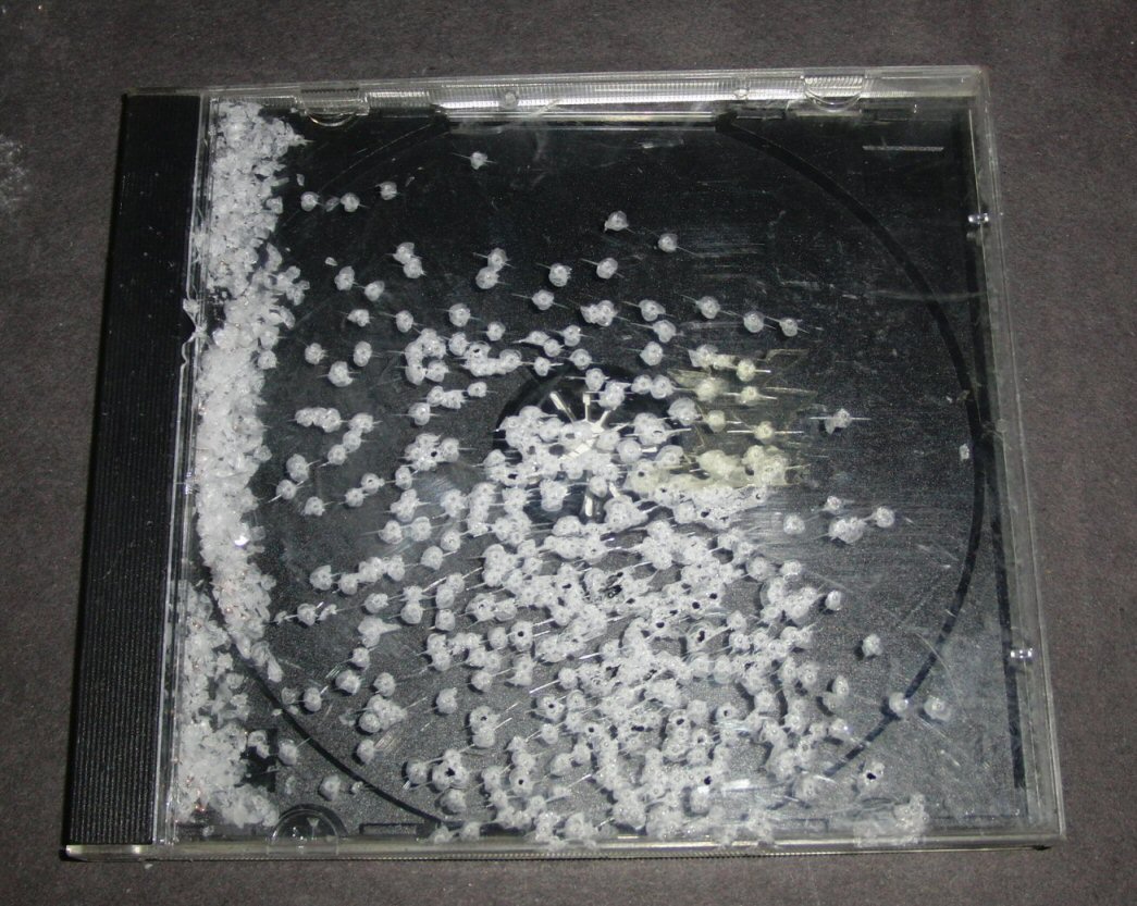

Here, have some clear plastic carnage :)
It's not *that* powerful, in that most shots didn't penetrate the casing, where they did it was due to the "jackhammer effect", but given the size of the ammunition, still quite impressive.
