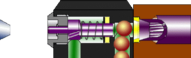

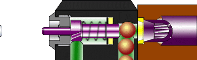

This gun works with a sleeve valve. Once the valve is hit at the back with a solenoid, the valve moves forward taking a bb with it. When it is far enough forward the valve gives a burts of air and shoots the bb. The valve closes and the whole process can begin again. Like this u can get semiauto/auto fire which is very controlled due to the use of a solenoid. At the moment I am working on making this gun feasable. The only problem for me is that the valve stem cant move that freely through the o-rings.

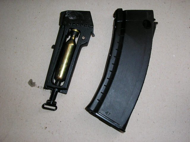

Magazine cutaway.
Magazine cutaway.

The same sort of valve is used in a lot of co2 pellet pistols. It is a fairly simple hammer valve, incorporated into the mag.
Good luck building this valve, it will be difficult with the small diameter holes you need to drill.

The difference is that the Drozd uses a solenoid hammer, not spring-loaded like normal CO2 pistols. This means that it can be set to fire to single shots or full auto in bursts, controlled precisely by fiddling with the electronics.
Ant, trying to replicate this for CO2 would need very precise machining to contain the valves. Are you planning on using it full auto with a solenoid or manually cocked semi-auto?

experament-u2 wrote:i never realized the hammer and all that was part of the mag that is brilyant
It's a bit like the magazine in my yunker, the magazine containts the hammer, valve and effectively can be fired while out of the gun.

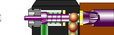

so is the bb shot with the spring or the co2?
Fri Jan 04, 2008 1:26 am
The solenoid hits the purple valve section, which pushes a BB into the barrel and releases a burst of CO2, which fires the BB. The spring then returns the the valve, closing off the CO2 and allowing a new BB to be pushed in place.

experament-u2 wrote:i just found this ant thought it might help
Hey man thnx so much! I was looking/searching for this pic for a long time. I got how the gun worked but this makes it all more visual. I couldnt read those russian sites where it was on so I could never find the real gif.

[quote="jackssmirkingrevenge
[/quote]
The picture that I posted is from the Yunker AK 47 I think. As I couldnt find a good picture of the magazine I used that one. But yeah its all the same. Jack u should check out the new post I placed on valves. The third valve is one like in these the magazines. I noticed that u can tighten the fit'' by pressing on the copper orings holders. Like this you can get the right tension'' for low friction on the hammer but still 100% sealage.

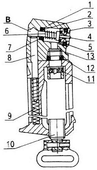

Ok so dumb question..... how's the gas get to the barrel? I can see how the BB does, but the gas?
In this picture
I presume the solenoid taps on part 4, which moves forwards compressing spring 6 and also loading a BB. But how does the gas get round part 4? or is part 4 craftily tubular and complicatedly made?

Sat Jan 05, 2008 10:45 am
The coloured diagram shows diagonal lines through the wider section of the valve which probably indicates a channel that runs from the back out the front, directly behind the BB. The wider section of the valve would be hollow.
