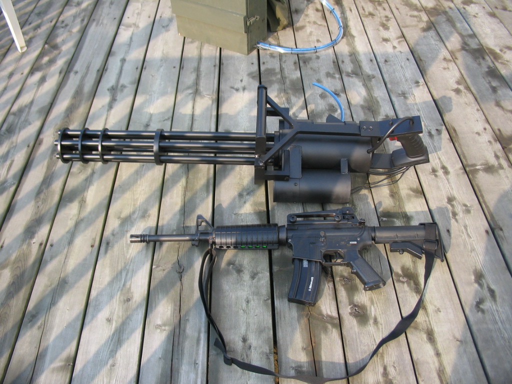

I'm building an airsoft minigun. All is almost done now. Is fire throught a hidden barrel in the middle of the rotating barrels. I have installed an airsoft hop-up units with it.
I'm making test using a shop compressor. Now I'm ready to go CO2.
My question: What can i use to regulate CO2 pressure down to about 90-120PSI.?
I'm looking for something cheap that I could just screw a paintball bottle on it and adjust the pressure.
Or maybe an paintball fixed regulator?
I'm pretty new to CO2 :(
Thanks guys! And here is a pic of my gun :)

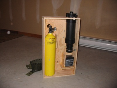

Anyway, this project is in it's third years in the making now. It started out with the vortex block at the bottom of a long 4" ABS pipe vertical feeder located in a backpack along with a small scuba tank. The BB then go through a hose all the way to the gun and into the hidden barrel. It work fine exept for one thing. BB start spining sideway because of the curve of the hose from the backpack to the gun making a "hop-up" effect be sideway. At about 30-40 feet they would start going right turn. And I mean like 45 - 70º!!!!
So now I placed the block inside the gun. inline like it should be.

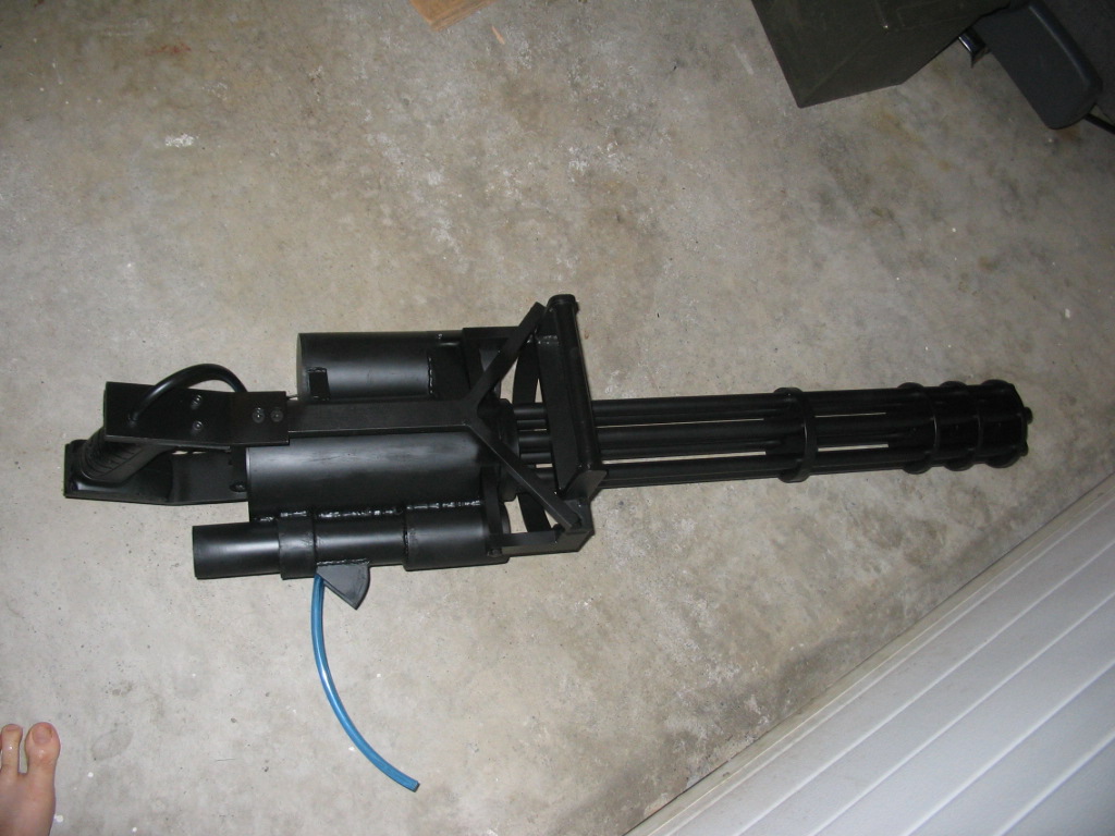

Here's some more pics :)
