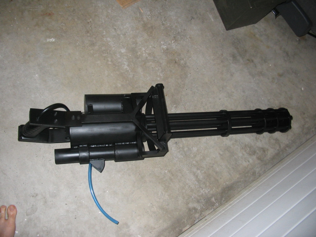

Hi guys!
Just new to this forum :)
I'm building an airsoft minigun. All is almost done now. Is fire throught a hidden barrel in the middle of the rotating barrels. I have installed an airsoft hop-up units with it.
I'm making test using a shop compressor. Now I'm ready to go CO2.
My question: What can i use to regulate CO2 pressure down to about 90-120PSI.?
I'm looking for something cheap that I could just screw a paintball bottle on it and adjust the pressure.
Or maybe an paintball fixed regulator?
I'm pretty new to CO2 :(
Thanks guys! And here is a pic of my gun :)

Any videos of this with the barrels spinning?
By the way, nice foot, and welcome to Spudfiles.

Someone had done something similar here (hidden central barrel) though the pictures are dead now. It would be cool to see actual functioning rotating barrels but can't fault your effort, let's see it in action!

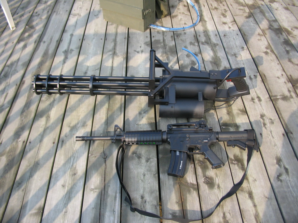

Here's some more pics :)
