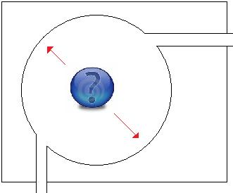

i found a big piece of plastic(not sure what it is, its hard and white)and i want to make a vortex block out of it.
I have 8mm lead bb(i got a bag of 2000 for 8 bucks at my gun shop) and a barrel that is prefect for them.
my question is how big of a hole do i need in the vortex block?
its going to be inline vortex if that helps.
thanks in advance all help appreciated.
how big should the hole be?

- vortx.jpg (9.92 KiB) Viewed 2325 times
Im no expert when it comes to vortex designs but it is my understanding that the "hole" can be any size however the air in and air out holes must align with the outsides for it to work (for obvious reasons)

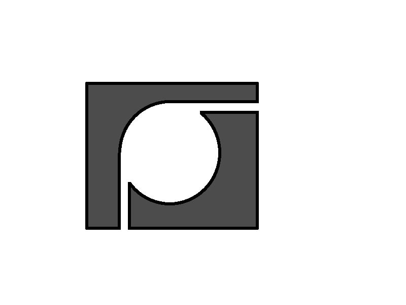

- vortex.jpg (19.01 KiB) Viewed 2317 times
At least twice the size of your projectiles, about 3/4" should do in your case.

@jmadden91
thanks, lucky you told me i would have just drill the hole
@jsr
sweet i have a 3/4 spade bit would it give a a smooth surface.or do i need to get a forstner bit like he used in the burnt latke bbmg how to.

You don't need a super smooth surface.
A spade bit will give a pretty smooth surface if you firmly clamp the plastic and use a drill press.
If the surface is not perfectly smooth it will probably wear smooth pretty quickly.
