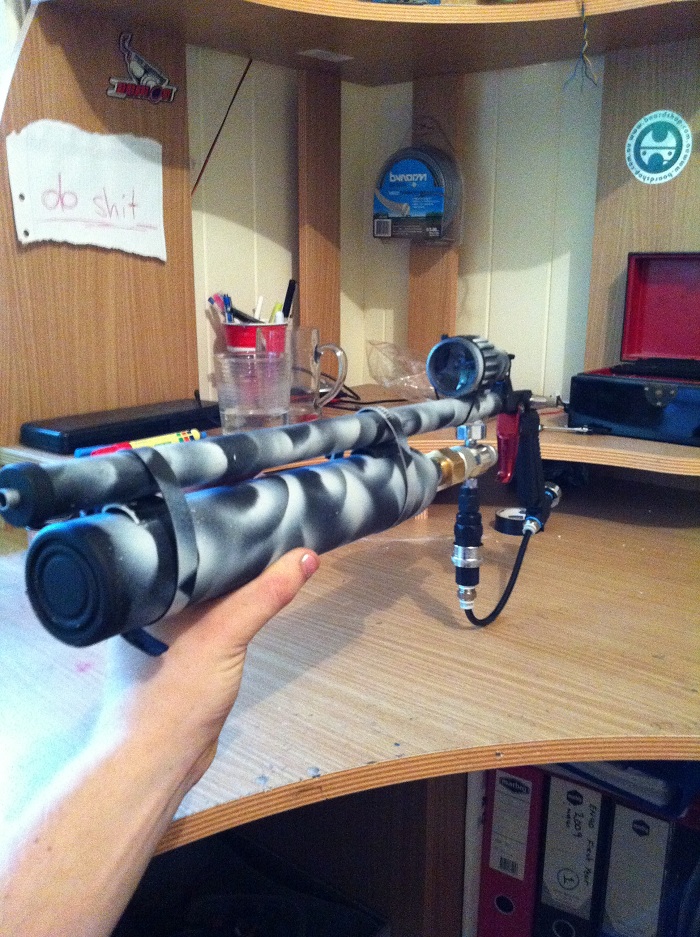

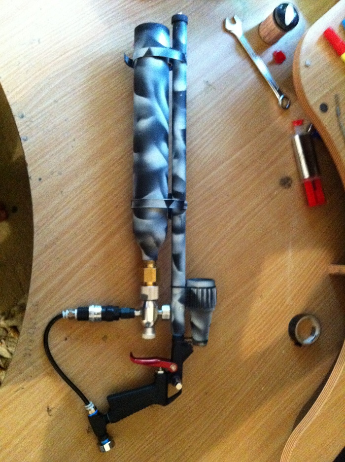

I finally achieved the awesomeness I was hoping for :D
With my setup, I can fire off single shots but adjusting the reg to my popoff value (using valveless popoff design), or I can get full auto at whatever rate I want by adjusting the regulator. A higher flow from the reg gives a higher ROF, and a slow rate is also achievable.
I know the paintjob isnt the best, but I like it.
The sodastream chamber is filled via my fridge compressor, using quick connect fittings. To fill:
1. unclip the airline
2. lock the gun into the fill station
3. fill
4. turn compressor off
5. turn reg completely off
6. release air between compressor and gun using ball valve
7. disconnect gun
8. reconnect airline
This whole process filling to around 500psi takes around a minute and a half.. from about 430psi I was getting around 50 single shots off.
Im really happy with how it turned out and its exactly what I wanted. If I want more shots, like lots more, I can put in a sodastream bottle which is full of co2. Would probably give something like 200 shots or so.
The scope I just whipped up using some $3 binoculars from a $2 shop down the road. It works surprisingly well actually. Though I want to buy a nice red dot sight off deal extreme, dont know if it would get through customs though..
let me know what you think :D

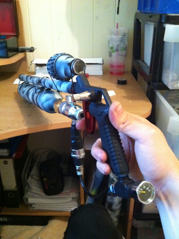

is it just muzzle loaded
Nope, if you look on the blowgun in the third pic, there is a little silver thing poking out to the left. This screws out for loading. I also have a big ass mag using the paint holder from a spray gun which can hold around 500 rounds which screws into the hole..its gravity fed with that mag.
Damage pics and vid, they'll come. Got a christmas party tonight so it will have to wait sorry.. But at 150psi damage is pretty crazy with a 6mm steel ball... Maybe not that crazy to some of you out there playing around with 500psi plus, but its more than enough for me.. I would NEVER take a steel ball at this power. I got shot with a piece of alfoil rolled into a ball and F*CK me it stung :D
Oh and the cost, probably around $100 for everything you need.. Which, with a regulator included, quick connect fitting, push to connect fittings and everything, isnt toooo bad. But certainly not cheap
