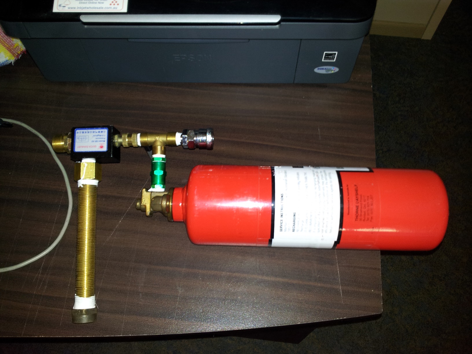

This is a 2.5kg fire extinguisher with a model QE-02 exhaust valve. I have a 7.5mm aluminium bolt action barrel which screws on to the QE valve.I wish to replace the extinguisher with a sodastream cylinder.
Would someone be so kind as to point me in the direction of any threads dealing with this, or any instruction would be appreciated.
The reason for using a sodastream cylinder is that one cannot purchase a paintball tank here. Criticism on this project would not be rebuked.
air to sodastream

That can be a good thing around here, but if I must.....Red don't match the rest.RAYZOR51 wrote:What!!!!! no healthy constructive criticism.
I should only fit facing in one direction and go back together just right. Try it both ways, you should have no problem telling.RAYZORS1 wrote:Also which way do i put the diagphram back in the QEV ?
The tapered piston ) goes in with the small end towards your pilot side, opposite your barrel. This site has some info on co2 tanks http://www.teamonslaught.fsnet.co.uk/co2_info.htm
That can be a good thing around here, but if I must.....Red don't match the rest.jrrdw wrote:RAYZOR51 wrote:What!!!!! no healthy constructive criticism.
Ok Ok I will change it to camo.
Thank you to all for your help (and criticism)
