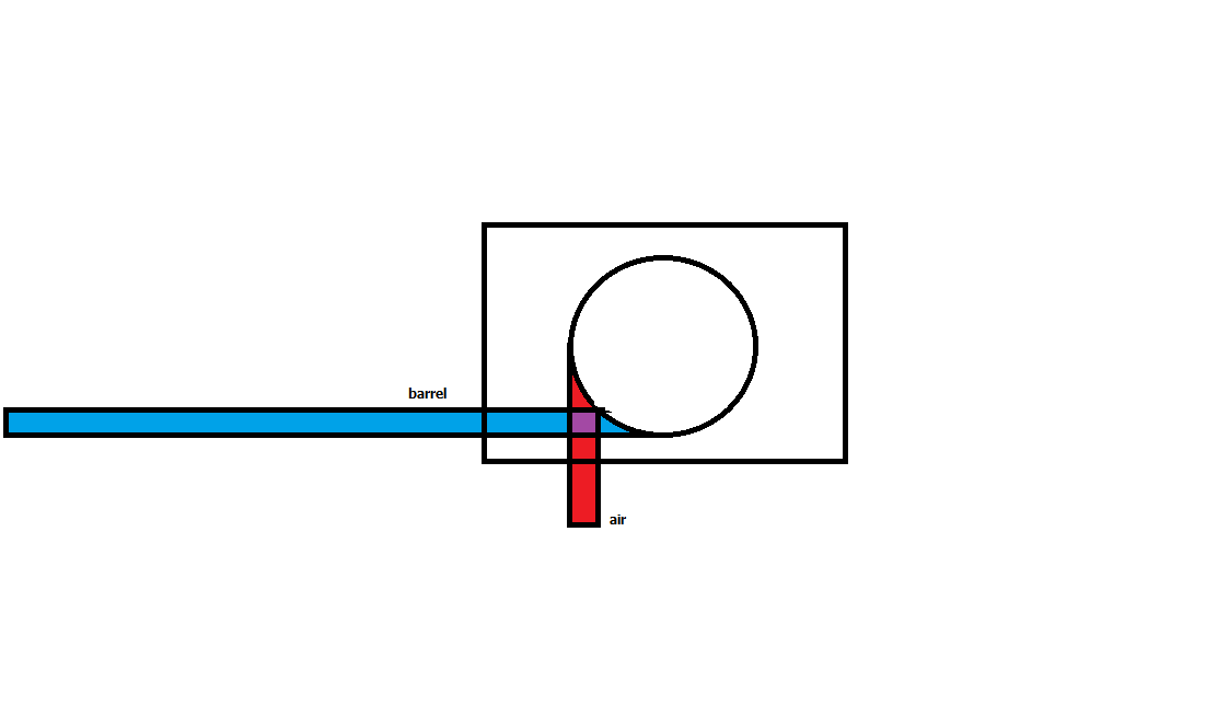

What if you do like this, putting the air input to the side of the breech?
- vblock.png (15.94 KiB) Viewed 3811 times

So are the suggestions pointing me to a vortex type system? If so, that won't be too hard to make.

vortex blocks are pretty easy to make, a block of wood with a few holes drilled in it is all you need. oh plus a bb skirt partially covering the block to prevent jamming. Just a hand drill and drill bits really

wood will wear out pretty quick i would put a bit of pipe and cast a block of epoxy around it.Cpt Obvious wrote:vortex blocks are pretty easy to make, a block of wood with a few holes drilled in it is all you need. oh plus a bb skirt partially covering the block to prevent jamming. Just a hand drill and drill bits really
