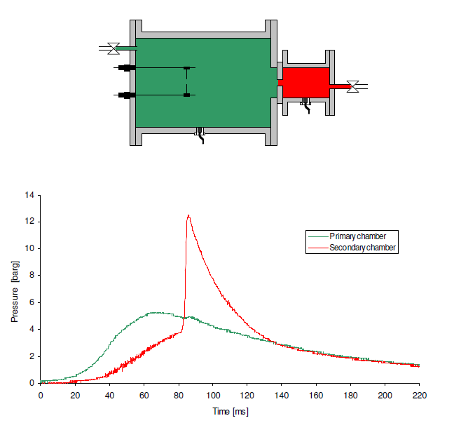

Looking at this in more detail, the paper describes what is happening in a closed system, with a significant pressure peak happening in the secondary chamber much higher than what occurs in the first one.
In our case the dynamic is a little different as we want the second chamber to open to the barrel, so ideally that peak happens while the projectile is accelerating.
Looking at the preliminary data from these tests with two effective chambers of approximately equal size, and the orifice being the same diameter as the burst disk seat, it appears that peak pressure in the secondary chamber is less than what is achieved by having the separation removed, because in the latter case a certain level of disk will burst while it won't with the separation.

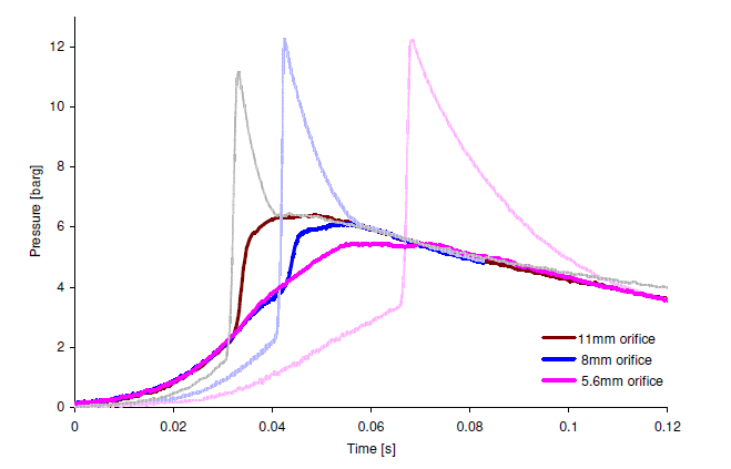

This graph suggests that with a smaller orifice the pressure spike will occur later and for longer, although with no significant change in peak pressure.

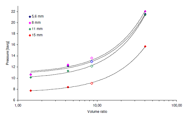

This graph suggests that the bigger the volume ratio between the primary and secondary chamber, then the higher the peak pressure.
I think on that basis it would be worth experimenting with a significantly smaller separation with a smaller orifice.

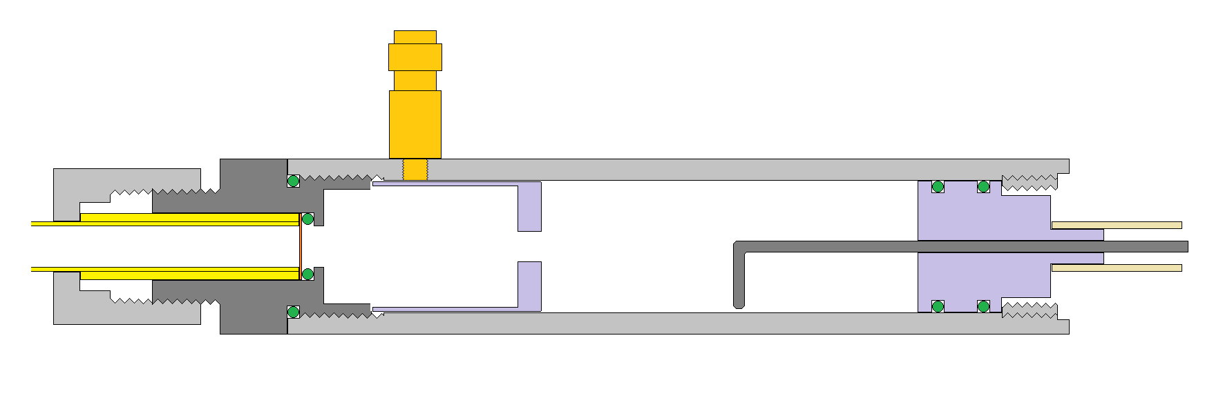

I made a second baffle that was both shorter and with a 1/8" orifice that looks something like this to scale:
