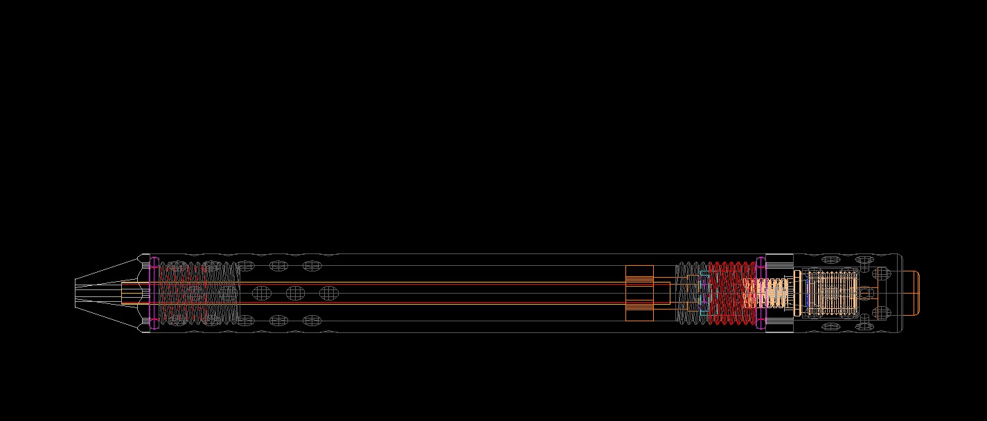

Mon Jun 13, 2011 11:02 pm
How about a wireframe model for now!
Made my own valve cover cap because some one was to slow to give me their dimensions.

dewey-1 wrote:How about a wireframe model for now!
Truly fapworthy Duane, nice!
I wonder who that might have been :D
