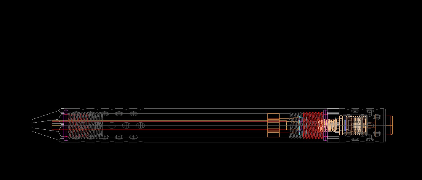

dewey-1
Posts: 1298
Location: NE Wisconsin USA
LeMaudit;
I too can make dimples!
Except mine has all the functional parts, not just a simple shell rendering. :D

LeMaudit
Any proof of that preposterous claim? :D

dewey-1
Posts: 1298
How about a wireframe model for now!
Made my own valve cover cap because some one was to slow to give me their dimensions.

dewey-1 wrote:How about a wireframe model for now!
Truly fapworthy Duane, nice!
I wonder who that might have been :D
