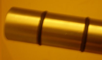

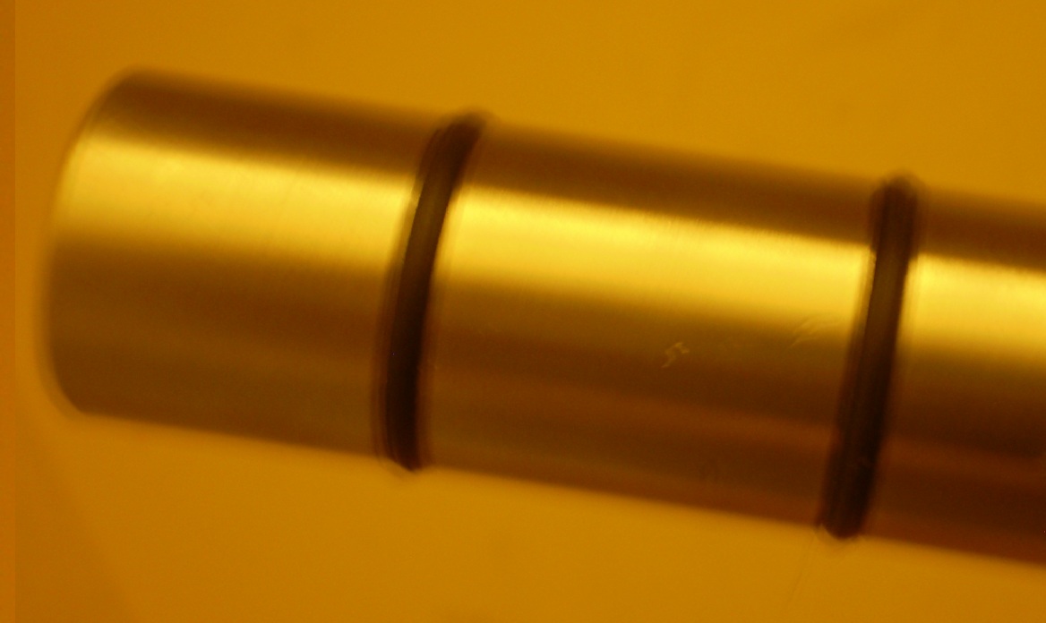

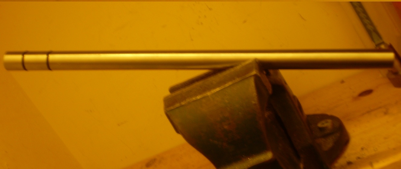

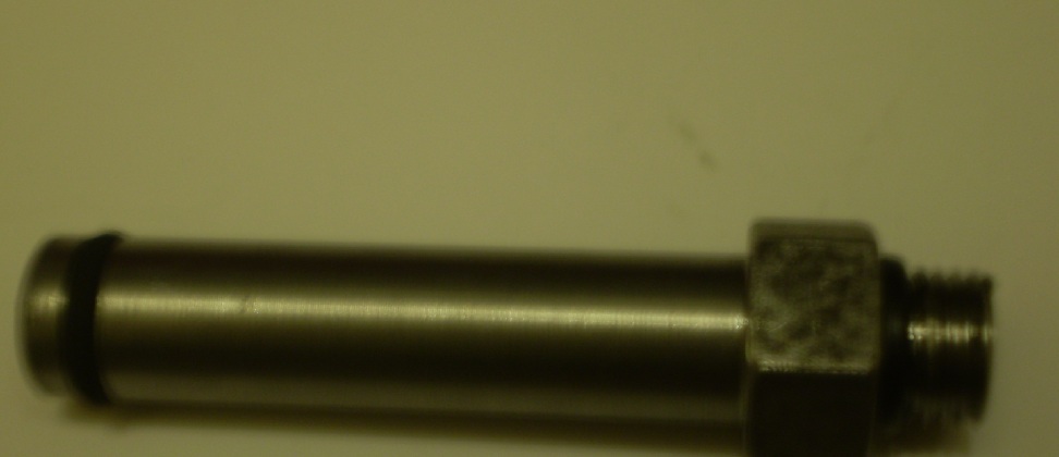

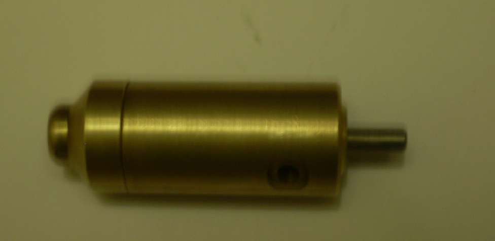

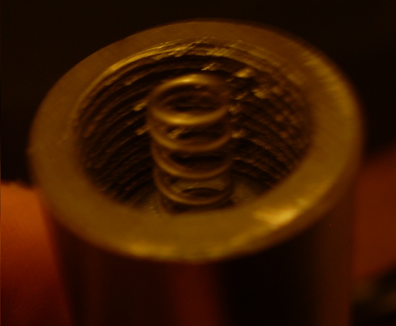

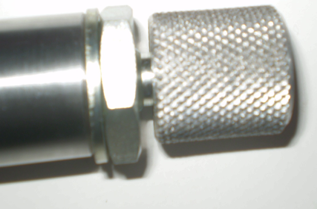

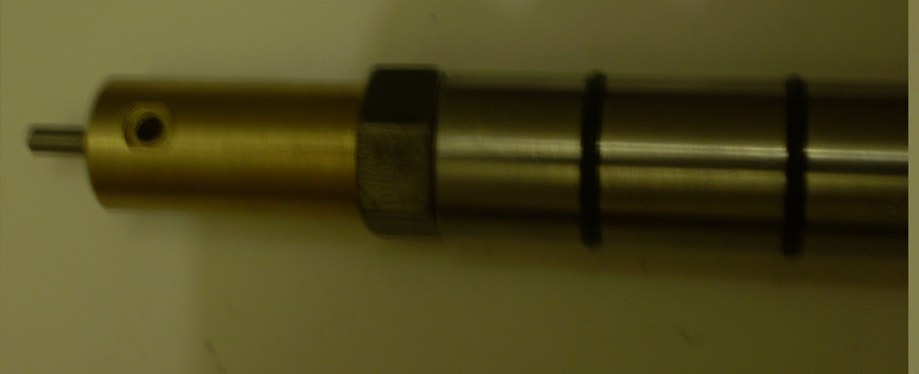

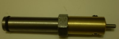

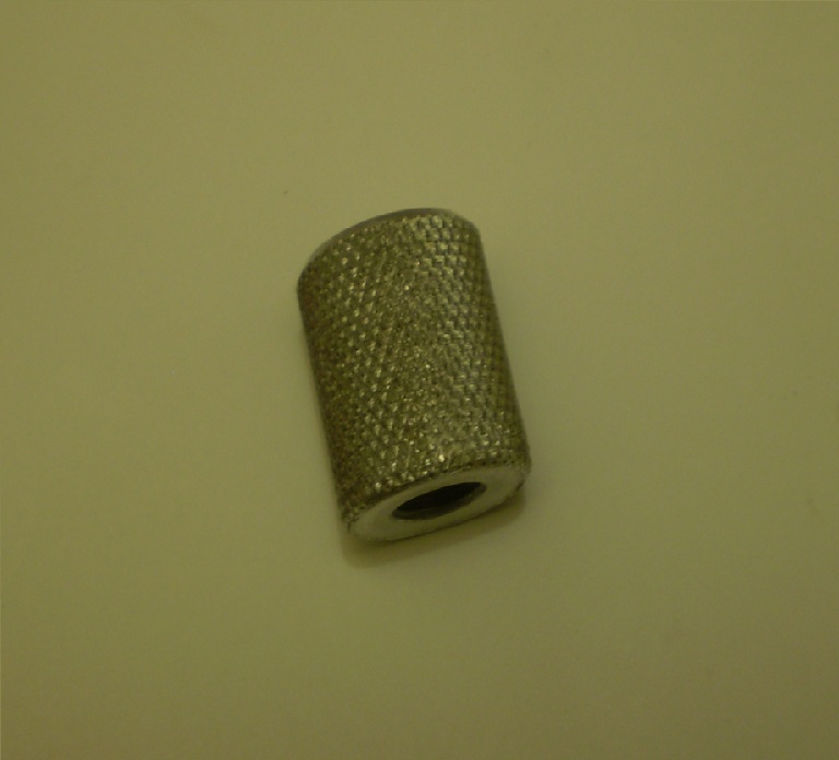

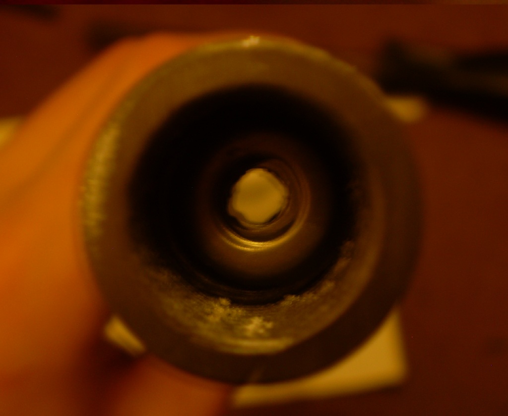

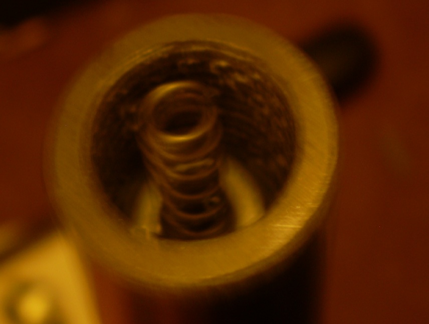

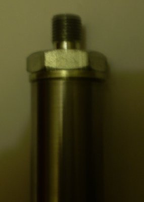

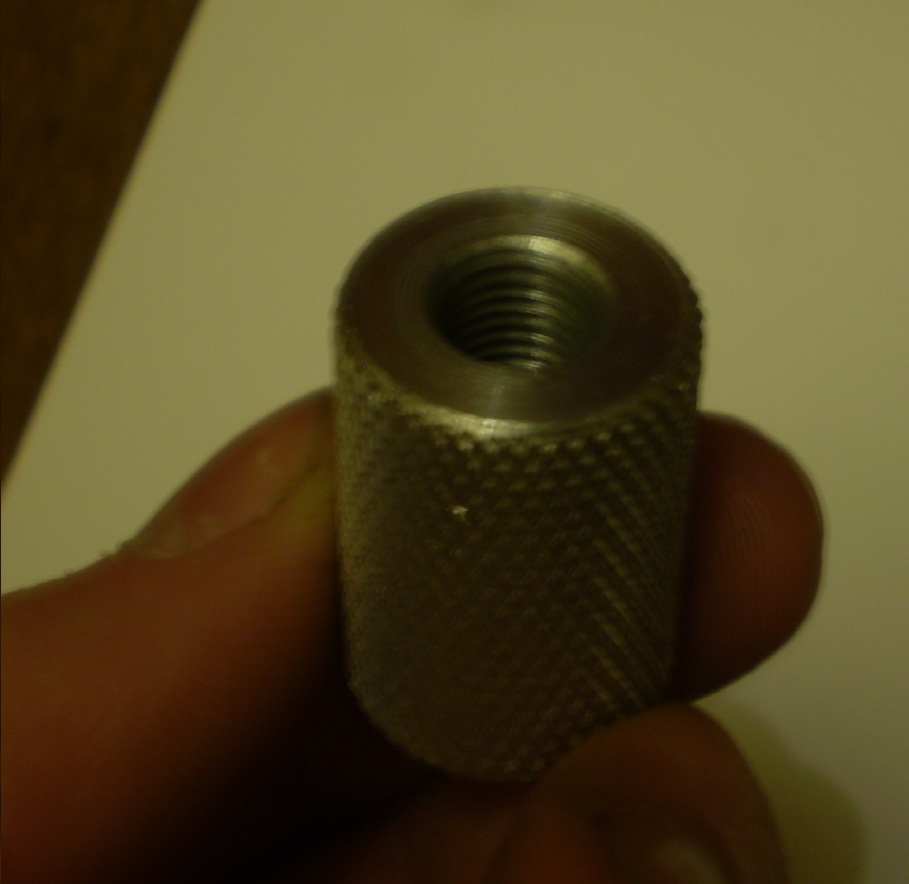

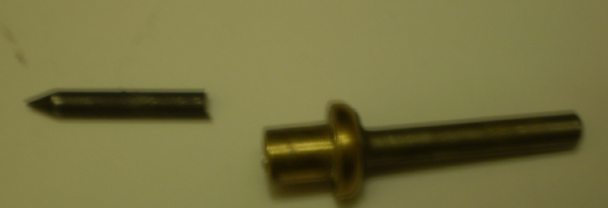

Heres my new pcp that im building, im getting the barrel next week and the grub screws to hold the valve in, all the parts were machined in a Hurco TMM10 except for the custom valve head which was made on a Myford super 7, also i will blue all the steel parts when im finished and hand craft a walnut stock or maybe a milled aluminium one.

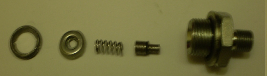

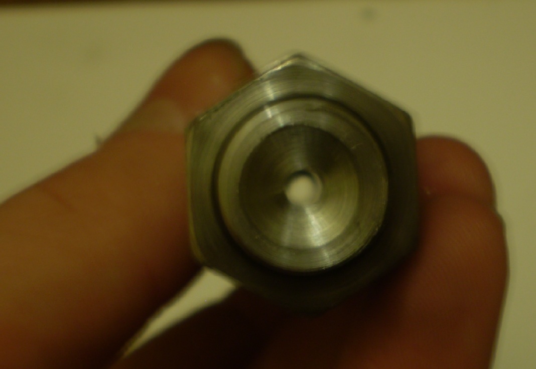

Did you spot the epoxy on the check valve?jackssmirkingrevenge wrote:Yay for machined projects, looking forward to see the finished results

No reason why high strength adhesives and machining can't go hand in handGoats spudz wrote:Did you spot the epoxy on the check valve?

seen as it dosen't bare pressure, well yesjackssmirkingrevenge wrote:No reason why high strength adhesives and machining can't go hand in handGoats spudz wrote:Did you spot the epoxy on the check valve?

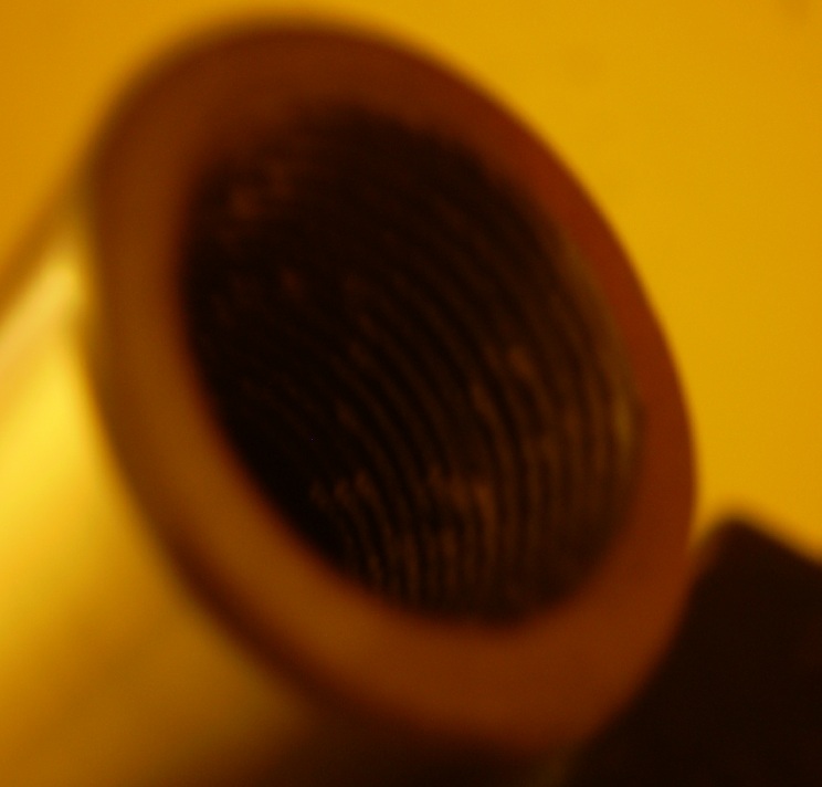

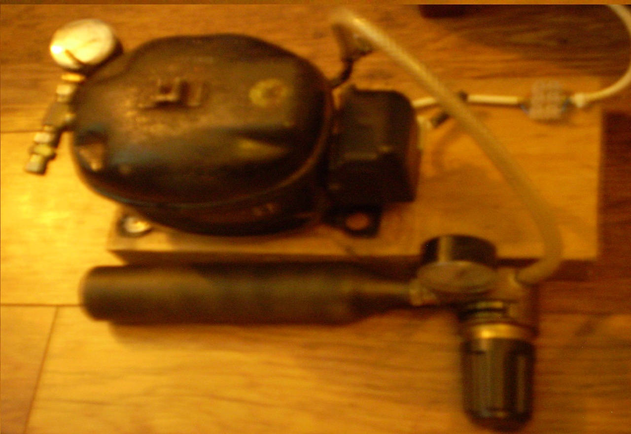

Did a quick function test at 70 psi held the valve in with my hand and its quite powerfull, bear in mind this things going to be run at 1500 psi also the grub screws and m6 tap im getting tomorrow and the 24" rifled barrel in .22 im getting next week for free with a steel breech courtesy of a good friend who owns a gun shop

edit: ok, just got back, i have drilled the grub screw holes and tapped them.

The idea of the tube inside of a tube is simply brilliant!
It solved my problem..
I've got the solution for a balance act between a chambersealing valve and a hammervalve inside a tube.
I could not figure out how to get the sealing edge inside of the main tube for the piston to seal on.
the hammervalve will be counterbalanced in the rear of the piston and the diameter will be balancing out the main piston to about 80 to 90%,
Not only cutting down the pilot volume to less than what you'd think would be minimal but also scaling up the pilot valve massively compared to this reduced volume..without making it harder to open...
you've just helped me to figure it all out!!

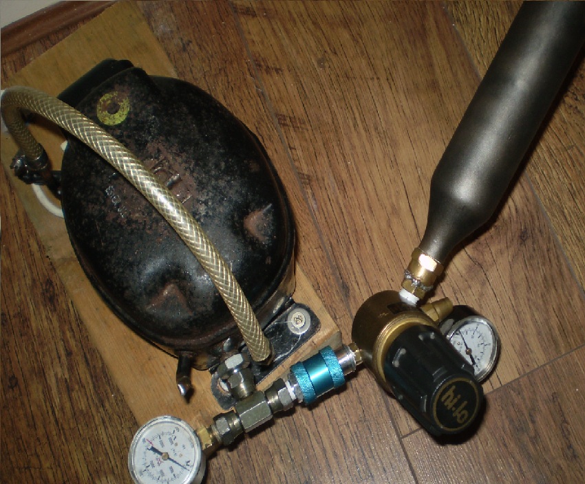

Also if you dont own a shop compressor you can fill a soda stream tank and reg it down like i did, eliminating the need for a first stage!Brian the brain wrote:The idea of the tube inside of a tube is simply brilliant!
