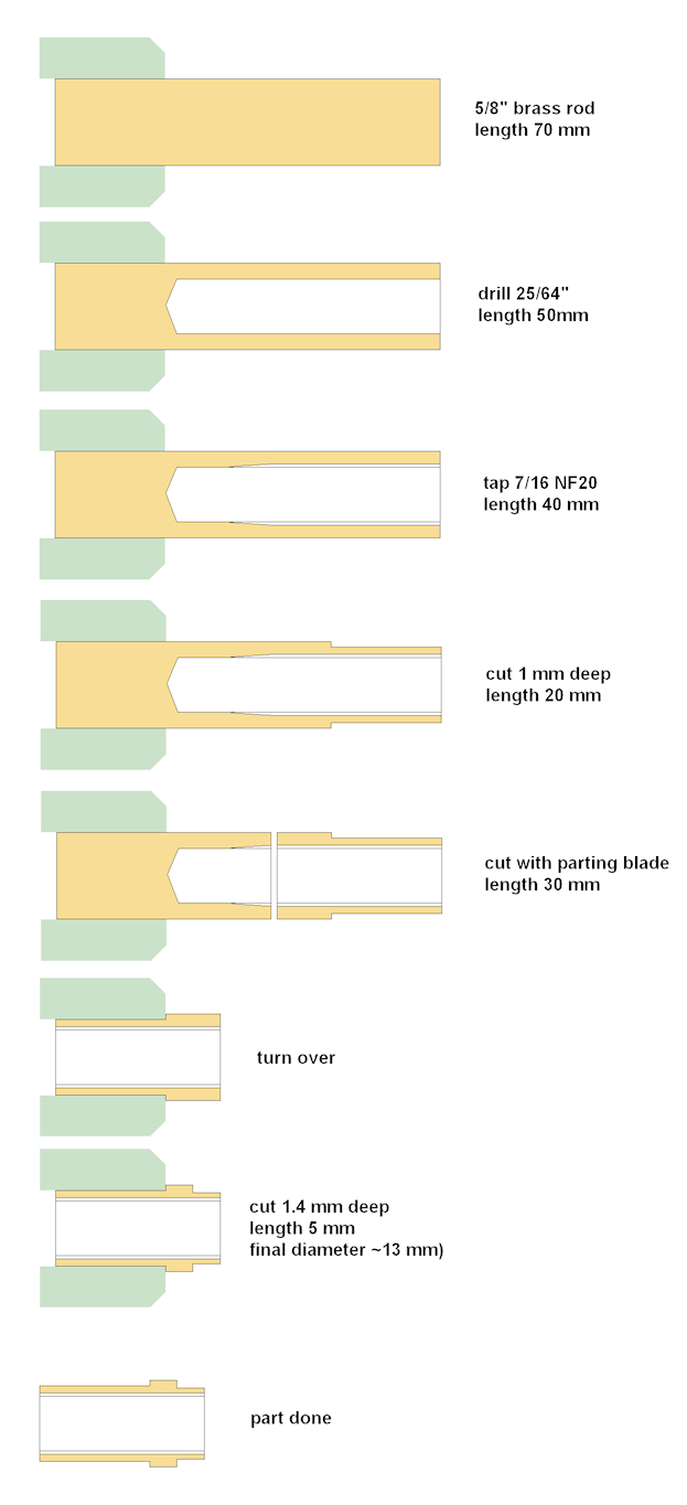

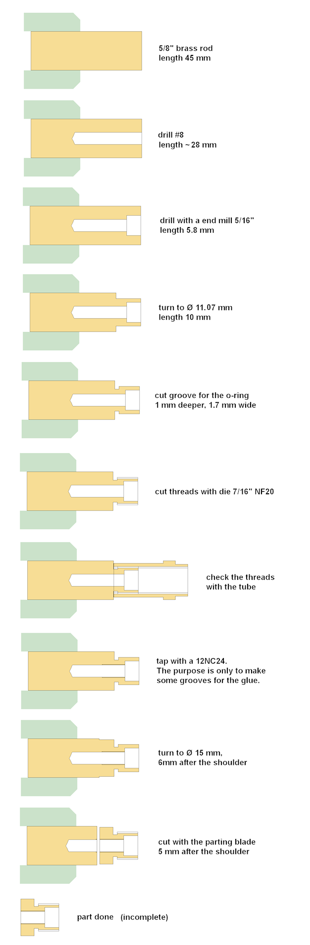

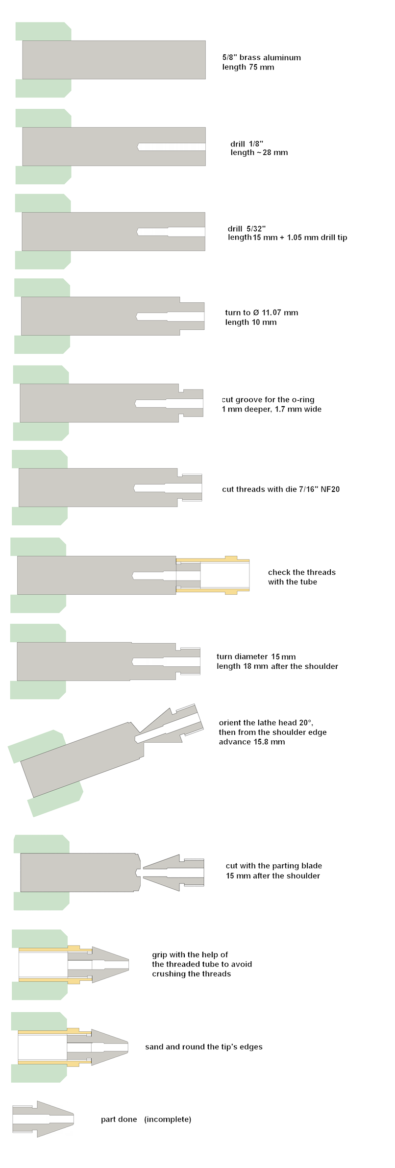

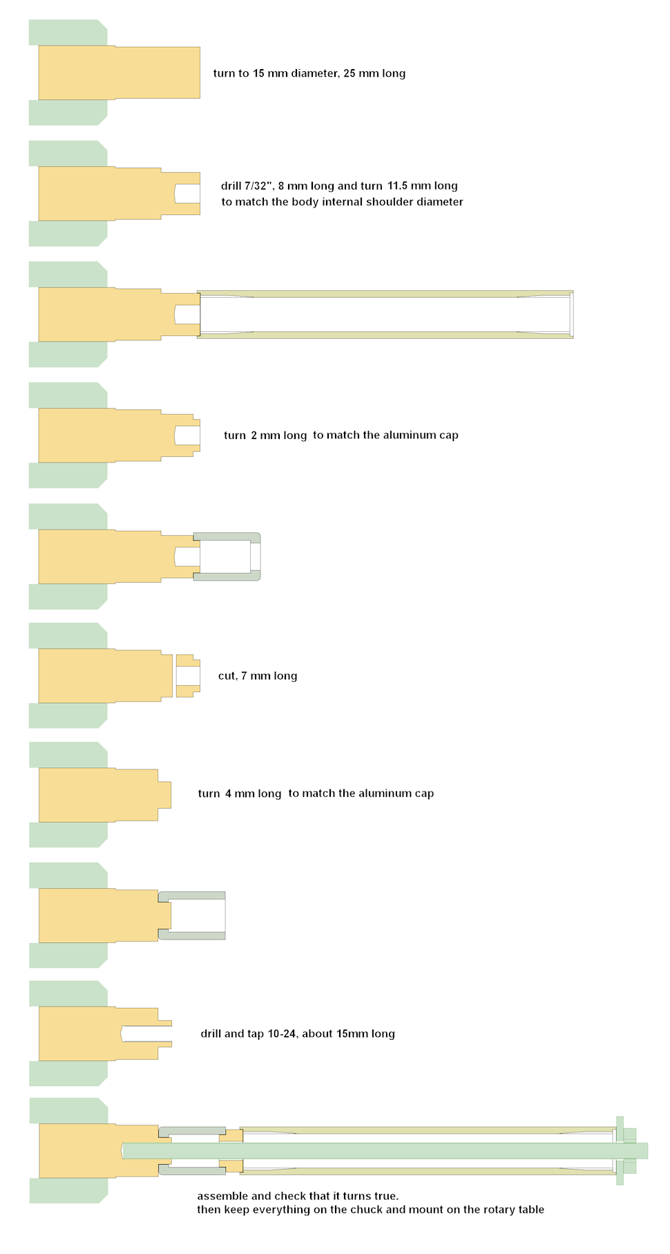

Hi guys,
Here's my very first pneumatic project, following a design JSR was kind enough to help me design and approve.
(guess who's fault it will be in case of failure?)
I'm happy to present you:
DIMPLY, the over engineered pengun
Well, that's the hypothetical and completely virtual 3D goal, of course... need some real work to do now ;-)
It will be able to fire 1/8" tiny ball bearings. Hopefully using pressure close to at least 400 psi (my shock pump limit).

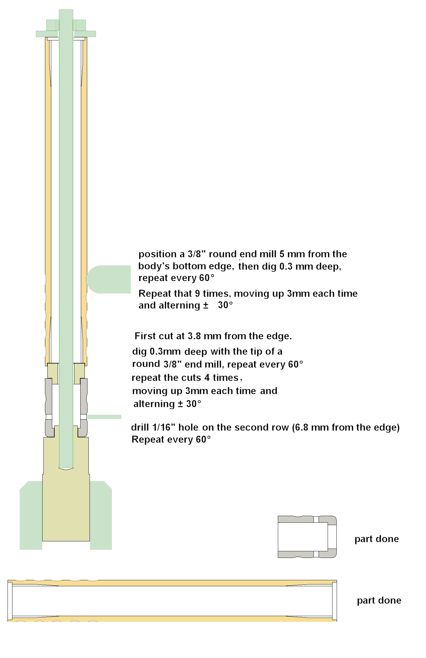

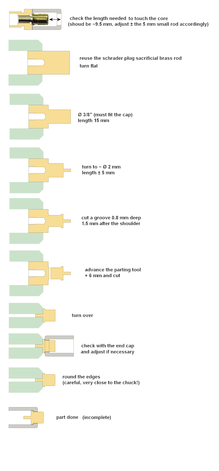

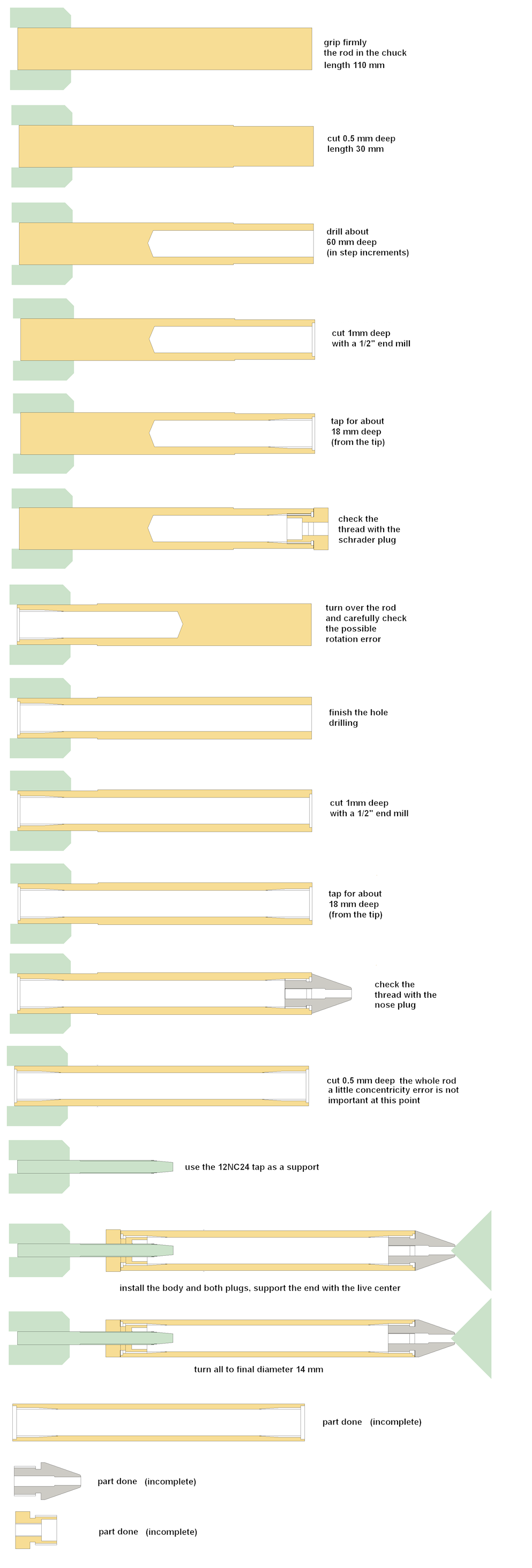

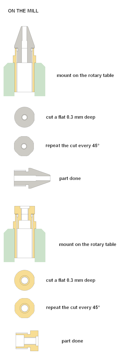

I have also prepared a plan with all the sizes, and I hope dewey1 or any 3D enthusiast will grab the pengun plan by its balls and make a cut drawing from that ;-) My 3D preview is really not more that a few rods and holes. Nothing is detailed internally. But I compensate the lack of detailed work using a shiny texture (in doubt, be shiny...)
Dimensional plan: 1 pixel = 1/10mm
Here's a great sectional view made by dewey1:
My intention is to post both picture results step by step, but also movies on YouTube showing the building process, so if you are curious about how someone that never learned of to machine properly can make a fool of himself right in front of a camera, please subscribe to this thread :-D

How do you intend to do the dimples? Ball mill and rotary table?
LeMaudit
Posts: 665
This is going to be pretty cool when completed I think.
I'll try to fulfill your expectations :D
Exactly!
I have cutting plans done, I will post them in parallel with the photos and videos so people interested can follow the building pretty much as if they were over my shoulder ;-)
And I'll be happy to read about criticism and suggestions for improvement of course. As I said, I'm pretty much self-taught, and my technique leave much room to improvement.

Do you plan on using a tailstock with the rotary table, or do you think it'll be ridged enough?
I just hope it will be rigid enough :-D I don't have a tailstock attachment for the mill... though this could be a VERY good reason to buy one ;-)
The dimples are only 0.3mm deep, that's not much, I think it will be okay.

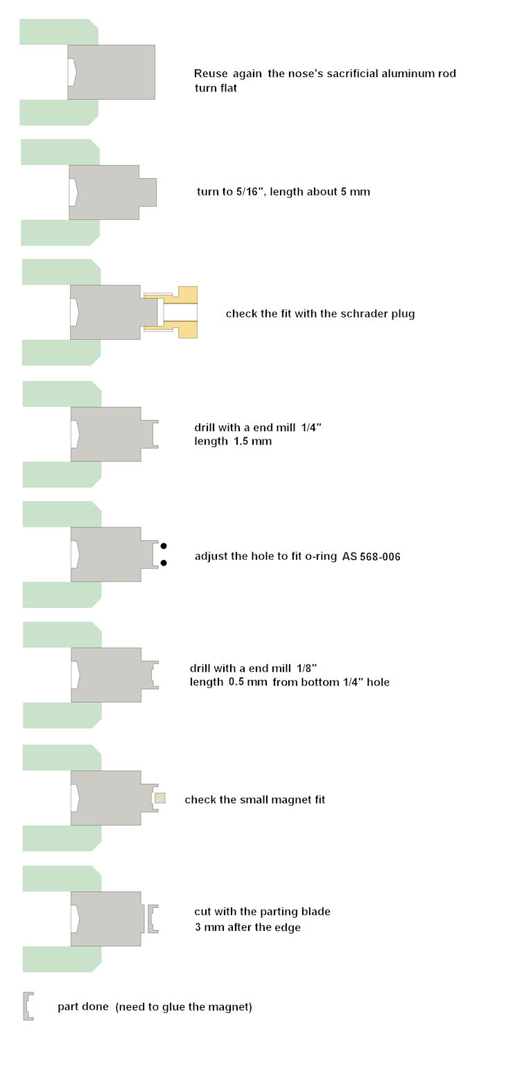

A chamfer on the magnet might be a good idea, as I imagine it will be glued on. The piston has quite a short bearing surface when in forward position so, unless you have quite a tight tolerance, it might mean the magnet could touch the barrel seat.
As I'm sure you can achieve quite a good tolerance, maybe a simple scratch down the side of the piston or bore will be enough for filling.

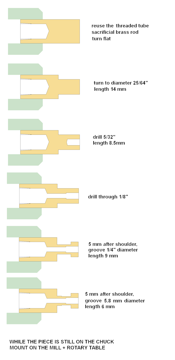

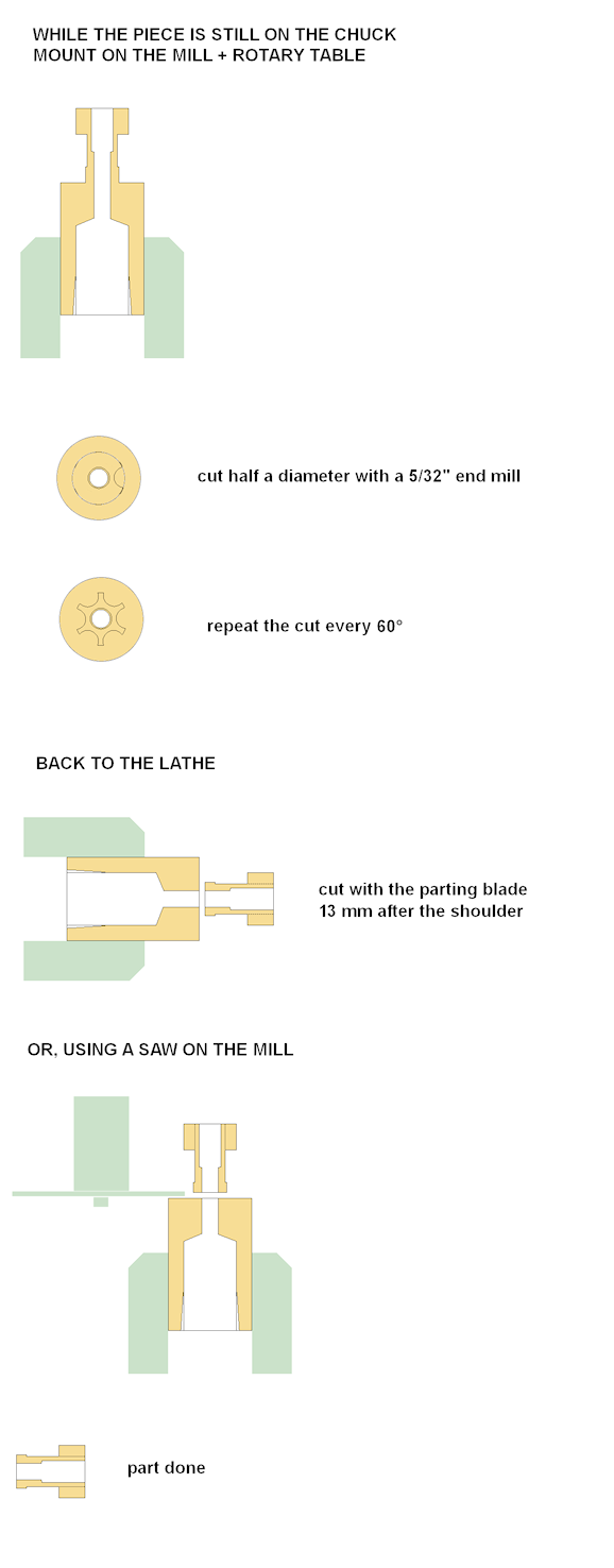

How are you going to do the cuts on the barrel support, drill first then turn down ? Or just a 4mm cutting head ?
One thing you could try is making a rifling button, a rifled pen gun would be amazing ;) Mmm or maybe save that for a bigger project !
Mmm in fact I should try and convince someone to machine me a rifling button, accuracy will always be limited if I making my tools with a dremel.
:roll:
LeMaudit
Posts: 665
al-xg wrote:A chamfer on the magnet might be a good idea, as I imagine it will be glued on.
Damn! You found the secret place where the epoxy will be... ;-)
neodymium magnet edges are a bit rounded. It should be okay. It will be pushed gently in place anyway, as the pressure increase below.
The tolerance should be very tight (I'll turn the diameter to custom fit whatever hole I drilled) and the magnet fit inside the barrel, so no problem if it is pushed a bit inside.
A 5/32" end mill cutting on the side. I'll describe that in details. For now I've almost finished filming the first step, I am learning how to make a niceeeee video out of it.
I don't think that will be necessary, without an o-ring it's not going to be a 100% seal anyway.
On the machined QEV I didn't get to finish, the max gap (on the diameter) between piston and the hole was intended to be 0.075mm, and the min gap 0.025mm with an N6 surface finish (Ra 0.8μm / 32μinch).
I did not want to post this after realising how creepy it was ;) (that steel bung, is just a fixture for machining, it is not part of the QEV design)
With any sort of lube on that, filling would be painfully slow or not even work.
