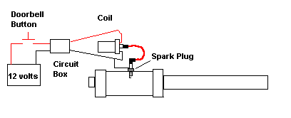

You could try my relay trick. Just replace T1 with the coil
A better way would be to build a 555 timer based pulsing circuit or a CDI circuit.
http://ourworld.compuserve.com/homepage ... m#buzz.gif
Assuming you gun is plastic, you will need to ground the screw base on your sparkplug or your opposite electrode to the - on the battery.
- Spud Gun ignite.GIF (2.45 KiB) Viewed 1685 times
