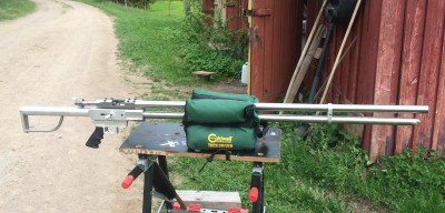

20mm PCP custom build from Finland...
I believe the barrel is from a 20mm cannon :shock:
Build Log on the GTA forums

uhhhh !!! awful! it sounds beautiful! :bounce: :bounce:

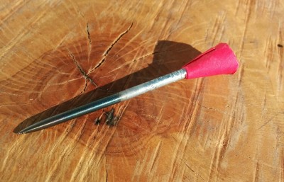

I realized last night I need to stop whining about not having a lathe and just use what I've got...
So I shoved a nail in my drill and turned it with files.
I tried to make a nice dart for my blowgun, and I even attempted bluing the tip. Anyone have advice on getting a better color throughout the piece?
I went for a "bullet" shaped tip and a gunmetal blue

Try heating the metal to pale red, (obviously, before inserting the plastic), and immerse it in dirty engine oil. There remains, the metal, a blackish color. For the plastic, paint it, simply. Your darts are very nice.
