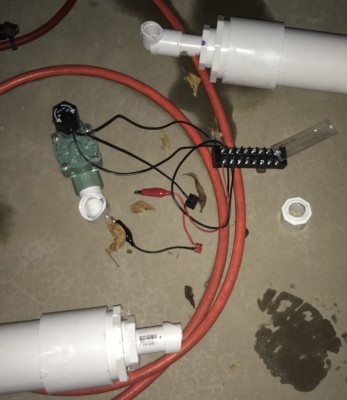

Hi, I’m a new member to the site and since my spud gun exploded when I fired it, I’m wondering why it exploded. I was shooting water filled halfway in the barrel at 90 psi. The cannon was Mede if 3 inch pressure rated pipe along with a 1 inch solenoid 2 couplings to step 3” to 2” then to 1”, then there was some 1” pvc for the female to female joints, and 2 couplings. All pressure rated and fixed with primer and pvc cement. I am completely open to suggestions. The barrel and air reservoir are both 5’ and 3” diameter. The cannon popped at the 2 elbow joints connection to the cannon neither the barrel or air reservoir was damaged.
The cement and primer had dried for 2 days before firing. Here are pictures of the elbows and cannon.

Your barrel was all clogged up and once fired the air had to go some where, out the weakest points. Live and learn...

Welcome to the forum and glad you survived your first spudgun incident!
Water is heavy, so trying to launch it is going to give you significant recoil. The joint that broke is the weak point in your circuit so it's almost not surprising that it broke.
Typically you'd want to attach the barrel to the chamber somehow in this configuration in order to remove the stress from that joint, something like this using a wooden spacer and a hose clamp:

I'm with JSR on this one. The recoil appears to be the main culprit from where I stand. I'd expect that little elbow to break if it's absorbing the recoil from a barrel full of water. I'd use a larger elbow and support the barrel so that it can't move up or down, nor back and forth.

In the spud gun world a lot of newbs seem incredulous when you comment on the choice of PVC. "It is all pressure rated" is a common response. It is also a naive response. Pressure rated for liquids is not the same thing as pressure rated for gases. PVC is pressure rated for liquids. It is NOT pressure rated for gases. Can you use it for gases? Yes.... But you must also be a lot more careful about how you do things and understand that you are NOT using the items as they were designed to be used. In other words, PVC is NOT rated for spud gun use. Act accordingly.
(And for some of us, "act accordingly" means we never use PVC.)
Oh, and sign me up as another who thinks unsupported recoil was the problem here.
