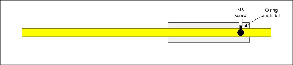

Tue Apr 09, 2019 6:29 pm
Would a piece of O ring material work as a hop up ? or would it be too hard ? I need it more to stop the BB's rolling down the barrel as well.

Wed Apr 10, 2019 7:21 am
It should work, this design is used in several airsoft models.

Wed Apr 10, 2019 4:07 pm
You could also just use a neodymium magnet if you are just trying to keep the BBs from rolling out'a the barrel.

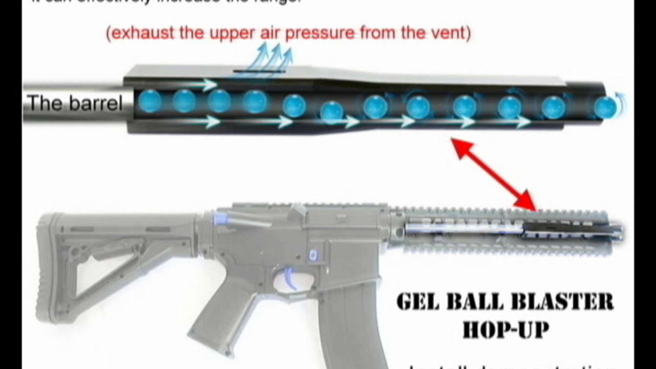

Fri Apr 12, 2019 7:06 pm

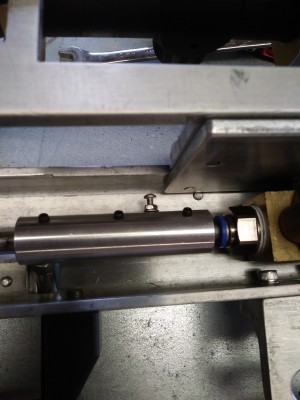

Anybody tried this air bleed idea as a hop up ? downside is it bleeds of some air but there is nothing to wear, a rubber sleeve covering the hole could be used as adjustment :idea:

Sat Apr 13, 2019 10:11 am
Oh boy if you start digging into hop up that amount of bullshit you're gonna find...

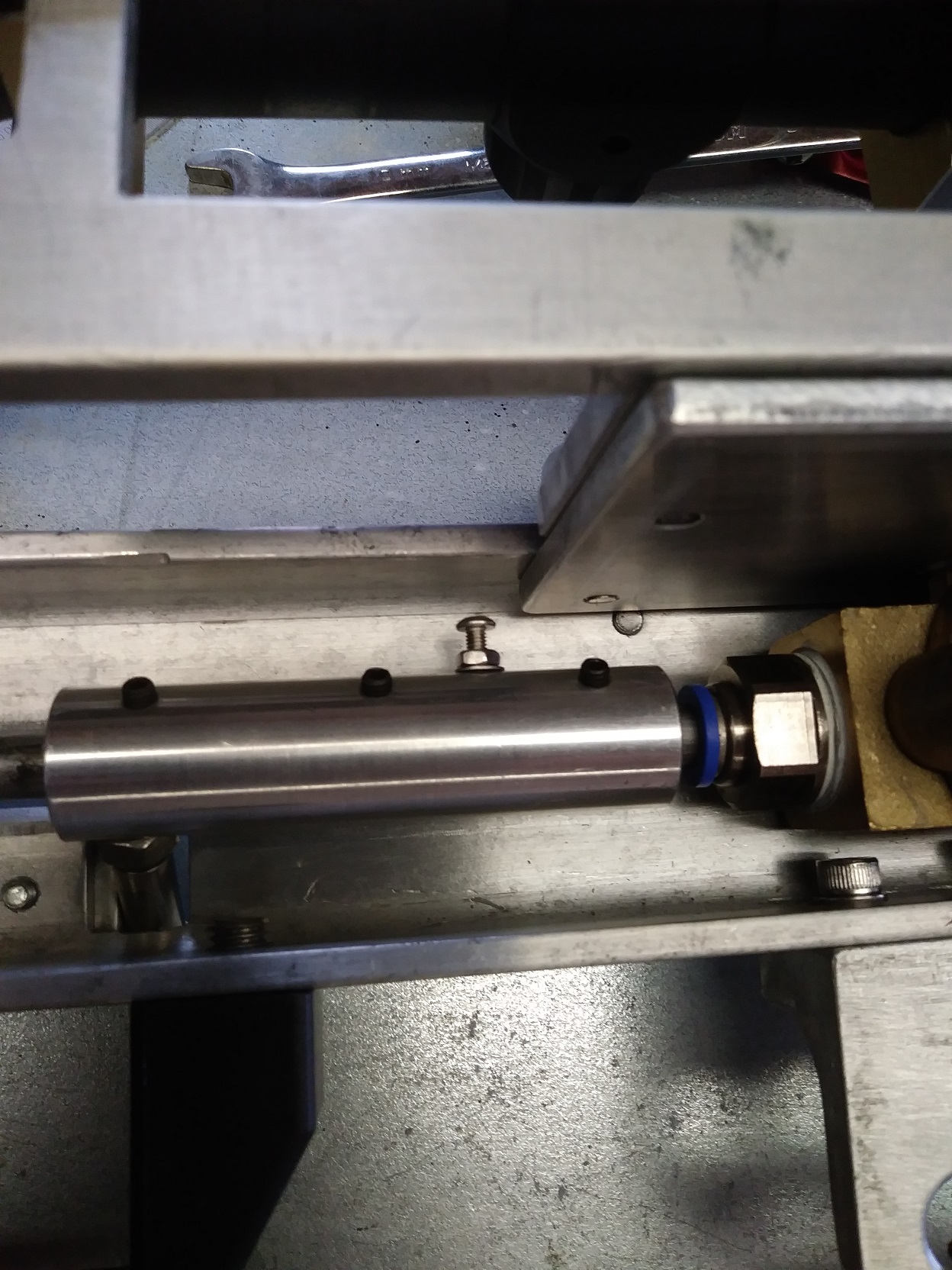

Sat Apr 13, 2019 12:17 pm
Tried the rubber hop up thing, it seems to work, at about 120 feet using the scope I can see the BB dip slightly then climb :D

Sun Apr 14, 2019 5:36 am
wyz2285 wrote:Considering the power output of homemade airsoft gun you should be getting considerable more range than before. Depending on BB weight 70m plus range should be well within your capabilities.
Agreed, the point of hop-up is to compensate for low projectile density and velocity by providing lift. If you're not limited by safety considerations for skirmishing, pushing heavyweight (0.45g+) BBs at higher velocity should give you longer useful range regardless.
Tippmann actually use a curved barrel in their "flatline" modification to generate backspin in their paintball markers:
I believe some early airsoft guns also used this system.
For "our" purposes however, I believe that using denser projectiles fired at higher velocities is a better path to longer range.
