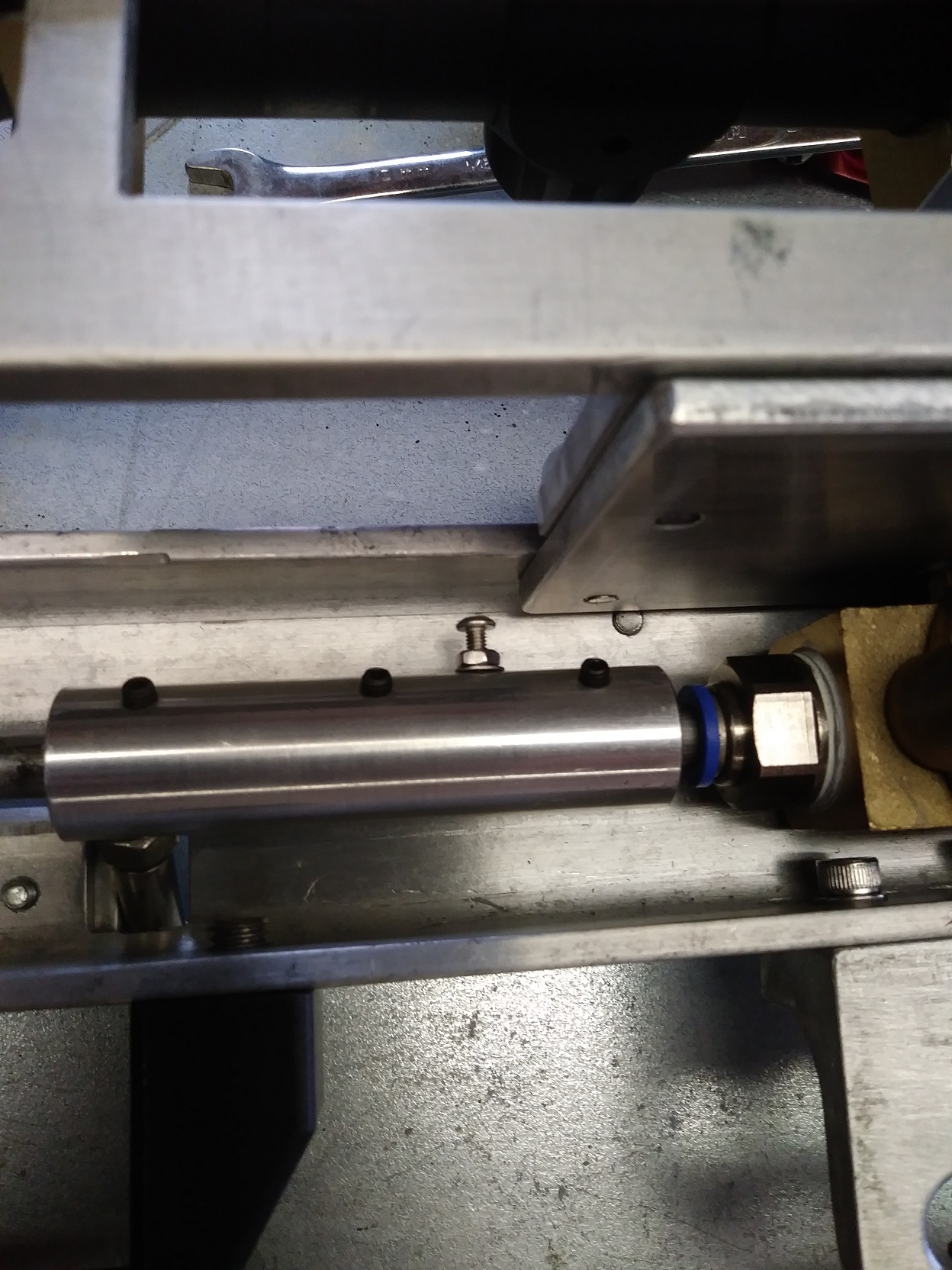

Would a piece of O ring material work as a hop up ? or would it be too hard ? I need it more to stop the BB's rolling down the barrel as well.
hop up.jpg (16.41 KiB) Viewed 11612 times
It should work, this design is used in several airsoft models.

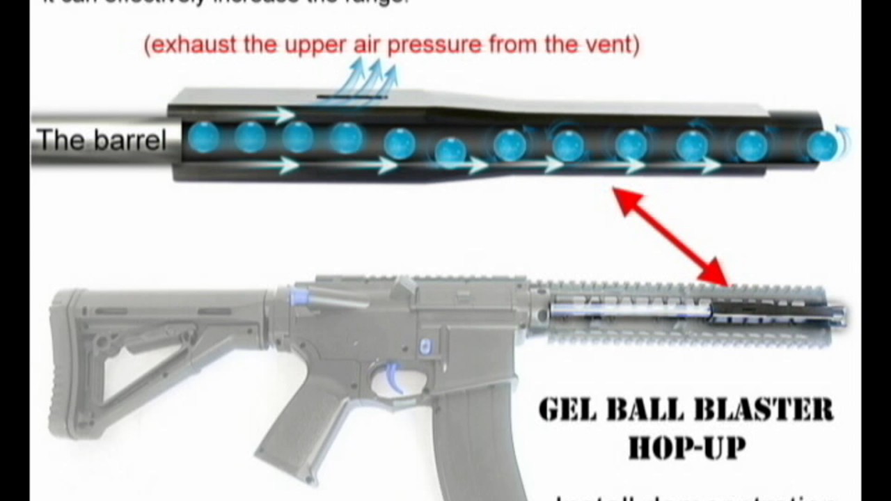

Anybody tried this air bleed idea as a hop up ? downside is it bleeds of some air but there is nothing to wear, a rubber sleeve covering the hole could be used as adjustment :idea:

Oh boy if you start digging into hop up that amount of bullshit you're gonna find...
