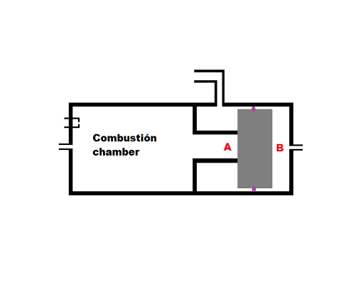

What is approximately the ratio of piston areas of a hybrid, between the pilot area and the opposite side, which seals the combustion chamber? I would like to have an idea of your experiences.
I mean this, to the ratio of areas between "A" and "B"
- pistón híbrido.png (9.28 KiB) Viewed 10243 times
As you drew it, assuming the piston is the same diameter as the chamber, you don't really want the piston to be smaller in diameter than 1.4 x A, because otherwise it will be choking flow. The bigger the piston, then the more dead space you will have. However, if you have the same pressure behind the piston, then the smaller diameter, the lower the pressure that it will "pop" at.
Let's say you have a 10x mix with a pre-ignition pressure of 150 psi, with the same pressure behind the piston. With B = 1.4 x A, then the piston will "pop" at around 295 psi. This is much less than the maximum pressure that a 10x mix can achieve. If the piston diameter B is 2 x A, that pop-off pressure increases to 600 psi, however there is a proportional increase in dead space.
For the best efficiency, you would want the piston that is around 150% the diameter of the chamber porting, but with a greater pressure behind it, say around 3 times the combustion chamber pressure.
