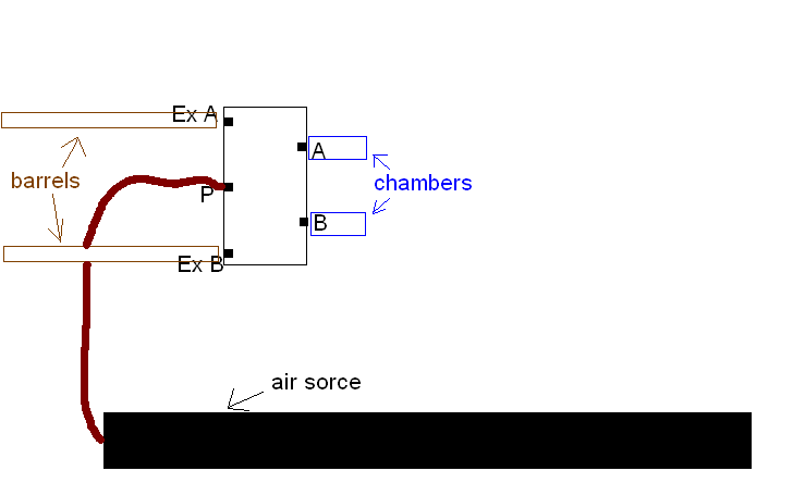

Jack does your full auto reaches a 600 rpm? Because in the fastest ROF I can choose from the chip is 10 Hz(10 Rps).
10 RPS is rather optimistic...
if you want to have 10 RPS whatever you're using as your air source has to be able to deliver 10 times the chamber volume in 1 second
though if you plan to use bbs that shouldn't be a problem
Ohhh and let me expand on my previous post... if you have a 5 way valve you could theoretically have two guns in one :D
if all you need is a nice little plinker for airsoft you could use the DCV itself as the main valve
and voila you've got two guns in one and effectivelly you doubled the ROF
since valves can be stacked toghter...
...as seen here
.... you could theoretically stack two valves to get 4 times the ROF... 3 to get 6 times the ROF of one gun... and so on :wink:

You blew my mind Poland! Hell yeah why not making a double barrel bbmg it would be spectacular :D
