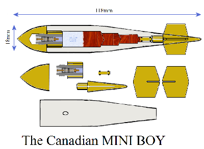

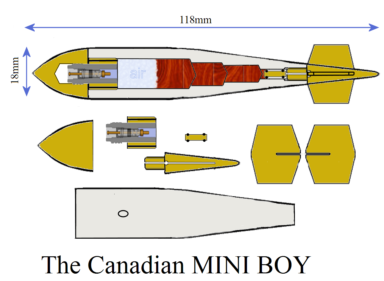

LeMaudit
Posts: 665
Mon Apr 04, 2011 8:22 am
MrCrowley wrote:Just thinking it might leave a rough trail on the beach,
I don't think it would make anything visible either. it's a very small quantity of dye stretched on a very long distance.
As I said in a previous answer, the only viable solution with dye I can think off would be to make it expel at the impact point. But because the shell will most certainly bury itself in a deep hole, I'm afraid the dye will stay inside the hole, without any visible effect at all from a distance. But it is worth thinking... hmmm...
jackssmirkingrevenge wrote:Something like this, basically two short cylinders, one of which has a central hole for the arrow shaft and is then cut into three or four "petals" that separate once the projectile has left the muzzle.
I have nothing against making the sabot simpler than my design because right now it's far more complicated to build than the shell itself :D But we have to solve one way or the other the retrieval problem, because with a sabot design that push a disk from behind, the gas will not reach the shell before it is outside the barrel.
And making smaller and denser the missile will most certainly improve the distance, I fully agree with every suggestions in that direction, but I'm afraid will make the retrieval quasi impossible without homing equipment... which is not that small on a reachable price, have a fair chance to break, and anyway too expensive unless one make its own... but that's a hobby in itself I think ;-)
[edit] I'm currently pursuing the idea of making a missile with dye expelled at impact. And without magic powder, only compressed air as it should be ;-)

Okay, here's some more food for thoughts.
You have a plunger (this little rod with 2 o-rings) that I expect to be kept in place by pressure, then dislodged at impact.
The internal cavity contain some bright liquid dye that can go through the holes in the tail if the plunger is moved.
To fill it, You unscrew the nose, drop the plunger inside (push it in place), fill with dye, then close and add some compressed air. I expect the plunger to stay right where it is, just by pressure alone.
At launch, centrifugal force will keep the plunger in place.
A impact, the plunger will sink close to the nose, opening the tail slits for a powerful dye spray. because the opening is just below the fins, I expect a widespread spray range.
What do you think?
This could be used as a valve that you can unscrew to fill the cavity. The cap would be replaced by the brass heavy nose

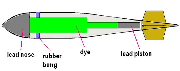

Mon Apr 04, 2011 11:41 am
Interesting thoughts... How about using the impact itself to spread the dye through a piston as per the attached diagram, which forces the dye out by popping the rubber bungs. Maybe the bungs should be moved more towards the tail in case the nose is buried in the sand.
Still, how easy is it going to be to spot a patch of dye on a sprawling beach?

LeMaudit
Posts: 665
Mon Apr 04, 2011 11:55 am
I didn't though about using the plunger as a piston... hmmm....
it simplify a lot things for sure :D
But I still think the spray must be through the tail an upward to have a chance to be visible, not on the sides as the missile will certainly be fully buried. I'll try to incorporate that in the design.
I would avoid lead to keep the hope of reusing the thing. Lead will just splat I think, even on sand. Or at least badly deform. But maybe as a filler, depending of the final weight. Brass is quite heavy, and I have bronze for bushings, I think it's even heavier (can someone confirm that?)
