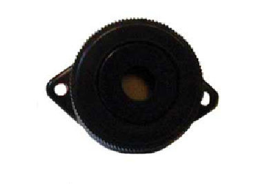

Small pizeo units can be quite loud. The come in back up beeper configurations. Just add a battery.
Operates on 3-28 Vdc. Continuous tone. 103 db sound pressure. 1.14" diameter x 0.93" ABS plastic housing. Can be bulkhead mounted with tabs on 1.31" mounting centers, or can be mounted through a panel hole of 0.7" diameter via threaded bushing and panel nut. 5" wire leads. Black housing
It is LOUD.

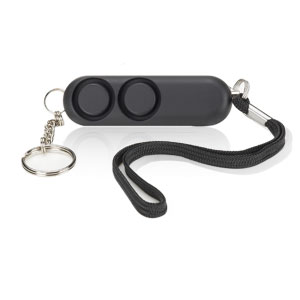

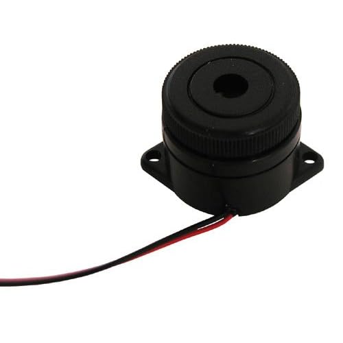

I bought 2 thingies today on the local stores that I found loud enough. Both have a very high pitch tone. And both are a bit too big to fit the inside of the 18mm missile that was planned :(
1st is a personal alarm thingy that sound when you unplug a strap. Works with 4 small lithium battery. 115db, fast pulsing sound, rectangular 24x13x80mm.
2nd is a Pulsing Piezo Buzzer. wired to a small 12V alkaline battery, it's maybe a bit louder than 115db, fast pulsing too. diameter 29mm, length 24mm. one battery dia. 12mm, length 30mm. Bulkier, and I have to fix the battery somehow.
I tried a few smaller piezo (they had a good selection at the store), but the sound was really not that impressive. Inside the missile body, I think they would barely be audible even with holes in it.
The piezo diameter seem to be a bit smaller than the plastic container diameter but not that much. That would fit in a missile body diameter of 1 1/4" (32mm). It's the larger aluminium tubing I have at hand. And with a thickness wall of 1/16" (1.6mm) I'm afraid it would not survive the impact and crush. Anybody have an opinion/experience?
The personal alarm thingy may fit a smaller tube, maybe 25mm, but those 2 round recess you can see on the photo are not for the battery, they seem to be resonance chambers. I wonder if the internals would work outside their plastic container.
No big deal to try to destroy them, it was only a few $, but I wonder if someone would have some idea to share before I cut them open?
MrCrowley, using the piezo + aluminum tubing 1 1/4" (32mm), that would make a missile about 9" (230mm) long.
If I use the personal alarm, I think I can fit it inside a piece of 1" (25mm) steel pipe for the main part of the body with a bit of sanding, if more strength is needed than aluminium. That would make a 7 1/4" (180mm) length.
Home Guardian mini Defender Personal Alarm.jpg (8.11 KiB) Viewed 3734 times
