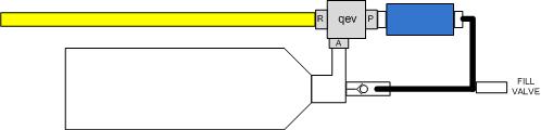

I think this might work :o with the slide valve open the chamber will fill through P, went it vents the QEV will operate, when it closes again the pilot air through the non-return will make sure it seats closed again hopefully before the chamber empties
:idea:
That's how it works in my head :wink:

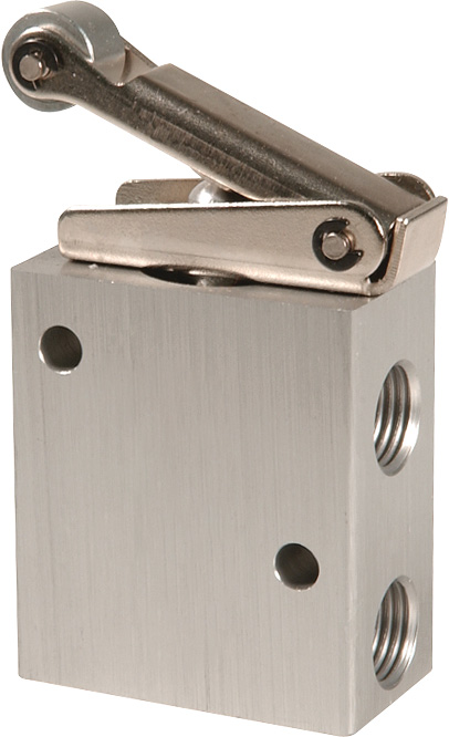

I would still recommend one of theses as a trigger valve, a 3/2 with 3 ports, it's basically a ready made QEV trigger

F1 that drawing looks exactly what i put together, but the fill point is on the opposite side..?
Does the QEV need to be modded for that to work?
The trigger looks good, but when i google search/enter-3/2 trigger i can't find it anywhere, would you have a link by any chance?
I entered pneumatic 3/2 trigger and i simply can't find it sorry...it must have a differen't name..? :?

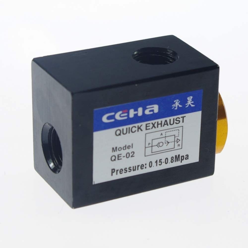

Quick question-Can a QEV still be used if the diaphram/valve can no longer be used?
Both of the valves have holes in them, i realized i had the hole in the wrong position, so i drilled a hole in the other one which i thought to be the right location but that never worked either. :cry:
Air2theBrain
Posts: 222
Tue Dec 19, 2017 4:52 pm
Ruined 2 more QEV's, but these smaller qev's are VERY weak, cheap pot metal.
Only air leak both times was on A, could never tighten it enough, and the photos show the result.
I wont be using those anymore...i couldn't believe they broke like that, wouldn't accept 100psi, it stopped leaking at around 50psi.
4 QEV's ruined... :roll:

wow, that's some poor chinesiem, the black block ones are pretty good, my 3/8 one was about $6 from Ebay. Sure someone here has tested these to failure to some really high pressures :shock:
If my circuit works the QEV can be standard, as god intended. But there must be a non return to make it seal when filling.

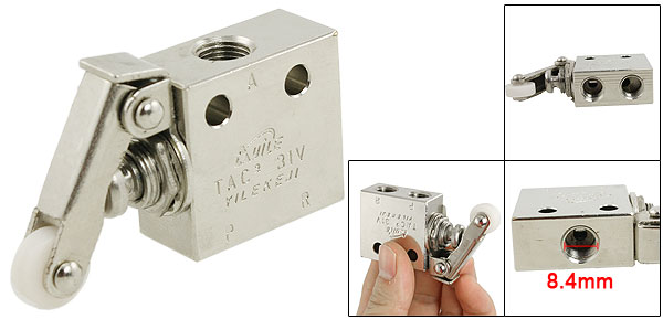

If you are near a Princess Auto they do a really nice 3/2 3port valve (roller lever valve) :idea:
https://www.princessauto.com/en/detail/ ... -p8192437e
Here's a nice one on Ebay
https://www.ebay.ca/itm/Air-Pneumatic-2 ... Sw2xRYRh0O

Do those triggers give the same performance as a 3-way/slide valve?

those lever valves are fine for triggering QEVs, 1/8 Npt ports should be big enough, keep the connections between the 2 as short as possible and small diameter so there is not too much volume to dump. I use 4mm OD air line, so it's 2.5mm ID, that would not take 1000psi though :shock:

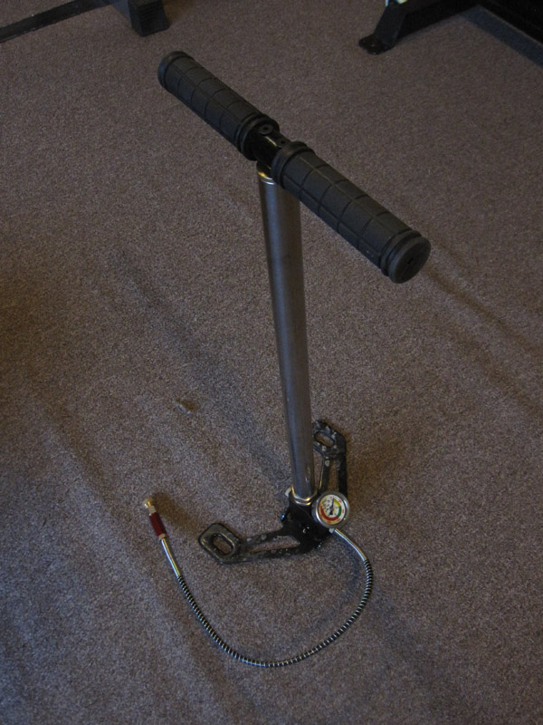

Not exactly an earth shattering bit of news, but after Joerg posted a review of a Chinese knock-off of the FX Airguns pump, I figured that the price was low enough to take a gamble on rather than just "one day" assembling the pile of pipe in the corner into a new pump.
I'm waiting on some proper fittings so I can swap my projects over from Type 21 to QC02 connectors, but the box included a Schrader adaptor that I've put together a fitting for in the meantime. (Initial impressions are fair. For my purposes it'd have been nice to have had a bit more volume and a bit less pressure, but it's still entirely acceptable for the job).
Now I've got a pump that should be able to reliably hit 40 bar, I might actually have an excuse to finish building Timberwolf.
