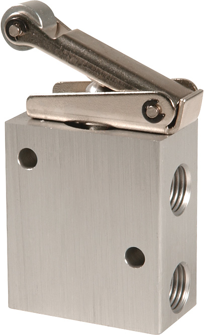

I would still recommend one of theses as a trigger valve, a 3/2 with 3 ports, it's basically a ready made QEV trigger

The trigger looks good, but when i google search/enter-3/2 trigger i can't find it anywhere, would you have a link by any chance?
I entered pneumatic 3/2 trigger and i simply can't find it sorry...it must have a differen't name..? :?

If you are near a Princess Auto they do a really nice 3/2 3port valve (roller lever valve) :idea:
https://www.princessauto.com/en/detail/ ... -p8192437e
Here's a nice one on Ebay
https://www.ebay.ca/itm/Air-Pneumatic-2 ... Sw2xRYRh0O

Ah thats awesome many thanks F1. :wink:
Do those triggers give the same performance as a 3-way/slide valve?

those lever valves are fine for triggering QEVs, 1/8 Npt ports should be big enough, keep the connections between the 2 as short as possible and small diameter so there is not too much volume to dump. I use 4mm OD air line, so it's 2.5mm ID, that would not take 1000psi though :shock:

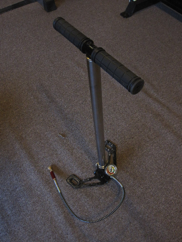

Not exactly an earth shattering bit of news, but after Joerg posted a review of a Chinese knock-off of the FX Airguns pump, I figured that the price was low enough to take a gamble on rather than just "one day" assembling the pile of pipe in the corner into a new pump.
I'm waiting on some proper fittings so I can swap my projects over from Type 21 to QC02 connectors, but the box included a Schrader adaptor that I've put together a fitting for in the meantime. (Initial impressions are fair. For my purposes it'd have been nice to have had a bit more volume and a bit less pressure, but it's still entirely acceptable for the job).
Now I've got a pump that should be able to reliably hit 40 bar, I might actually have an excuse to finish building Timberwolf.
