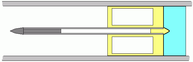

Most mortar shells seem to have a C<sub>D</sub> of around 0.1, but even if you had one made it still wouldn't address the issue of sectional density. If it was a full bore round, you could either have it light enough to be shot fast but with very poor sectional density, or vice versa.
That's the beauty of discarding sabots, they provide low density in the barrel, which is what you want for a fast shot, but high density outside the barrel, giving much better velocity retention.
This is how I envisage it being built - tube body, with a weighted nose section, a lightweight tail and fins made of thin blasa, ply or aluminium with low area but large contact with the barrel (hence the cutouts) to keep the projectile centred. This allows the use of a simple one-piece cylindrical sabot that doesn't need complex interlocking petals.
Care should be given to detail such as tapering the edges of the fins as these make a significant difference to C<sub>D</sub>, as well as sanding down any beads of adhesive where the fins are attached etc.

What part of the drawing are the fins, sorry? :D
To have enough weight I'm thinking of using 20mm PVC and possibly thin sheet metal (tin?) for fins. Say the dart is 200mm long, would you make the fins something like 80mm long and perhaps 20mm tall? I'll figure something out for the nose but it'd probably have a fishing sinker or two in the front and perhaps another two in the PVC tube where it attaches. Epoxy/filler would be used to smooth the exterior gap between the PVC pipe and nose.

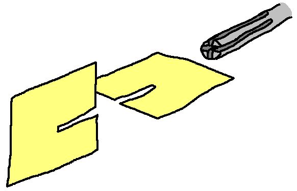

MrCrowley wrote:What part of the drawing are the fins, sorry? :D
The white parts, suspended by magnets on rectangles of creamy goodness ;)
Attaching the tin might be a bit tricky, you might need to slot them together and into grooves in the pipe in the same way a throwing dart is manufactured.
Great minds... :wink:

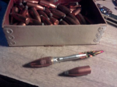

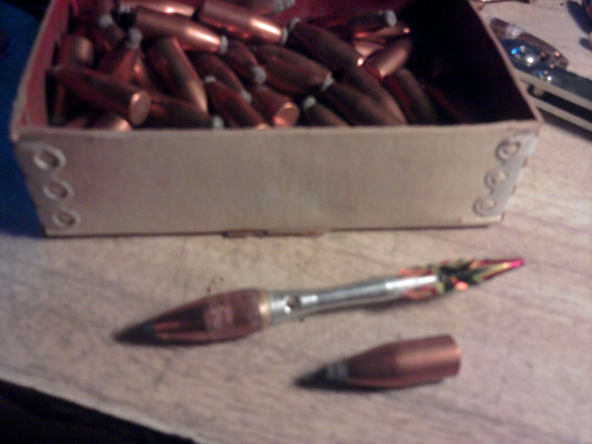

the dart thing gave me an idea, i took an aluminium dart flight holder thingy and cut of the threads, took the dart flight and cut it down, then took a bullet and glued it to the back, hope it works and sorry for the sh*t picture but i used my phone

ilovefire, looking forward to your results :)
