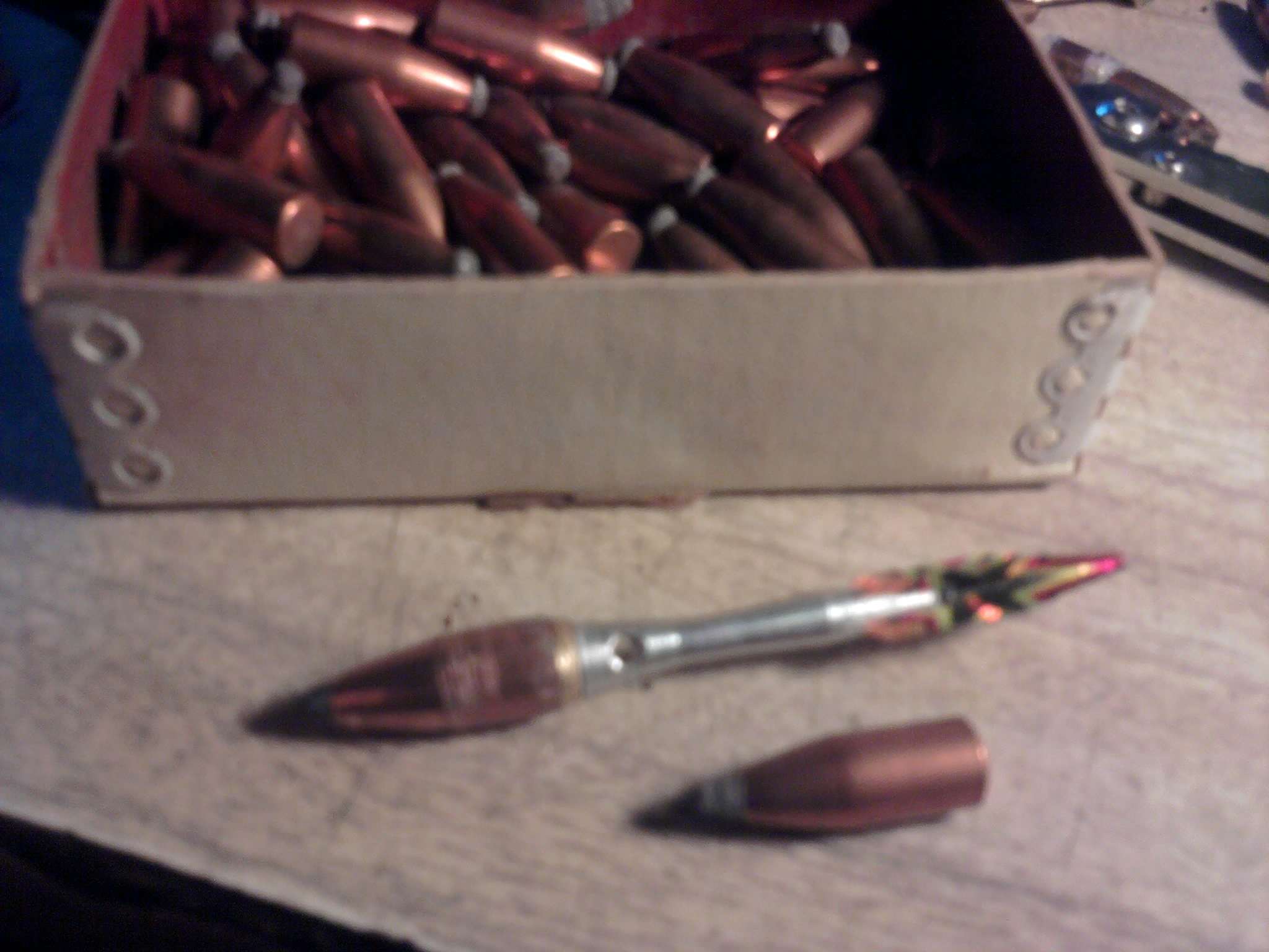

the dart thing gave me an idea, i took an aluminium dart flight holder thingy and cut of the threads, took the dart flight and cut it down, then took a bullet and glued it to the back, hope it works and sorry for the sh*t picture but i used my phone

ilovefire, looking forward to your results :)
