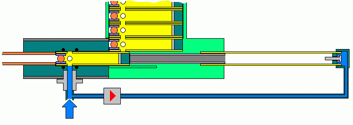

Something along these lines would fix the problem and reduce air consumption at the same time. The only problem is to find a valve that can handle 800 psi
EDIT
Oh before anyone asks I mean the mechanical valve that cuts off air supply as soon as the bolt retracts, not the air cylinder (though not that you can't use it... but Im pretty sure JSR won't do that)

Ah, but:
what if you used air to push the bolt back in place ? More less using the same method that I posted above?
ohh well forget about it - I know what you're going to say.... too complicated
Thu Nov 04, 2010 9:15 am
POLAND_SPUD wrote:what if you used air to push the bolt back in place ? More less using the same method that I posted above?
Actually, this time you might actually have a point, hmmm...
edit: added a check valve to make sure there's enough air for it to work

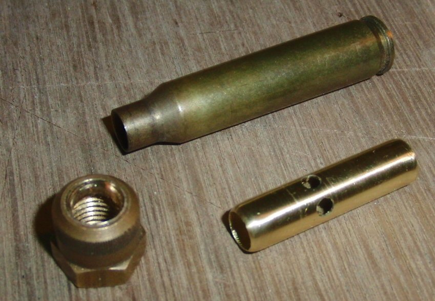

I tried to compressed the seal by adding a chamfered tube for my cartridge project like so:
Hooked up to my paintball tank at 800 psi the BB failed to pop though.
What I can do is try to crimp the mouth of the cartridge incrementally like so and see if that makes a difference, maybe using a drill chuck or by forcing into a suitable conical bore.

Fair point! Though now that I think about it, hammering the cartridge nose first into a tapered bore should be a good way to increase pop-off pressure, still at work but I'll give it a go when I get home, before I make any radical modifications to the breech and action.
edit: here's the v1.1 cartridge with a crimped nose (down to 5.4mm from the original 6) by hammering it into the fitting illustrated, and a 5.56mm cartridge for scale ;) I don't know how much of a difference it will make, watch this space
