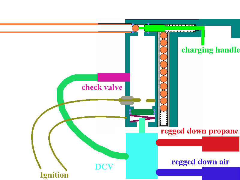

what if you used air to push the bolt back in place ? More less using the same method that I posted above?
ohh well forget about it - I know what you're going to say.... too complicated
POLAND_SPUD wrote:what if you used air to push the bolt back in place ? More less using the same method that I posted above?
Actually, this time you might actually have a point, hmmm...
edit: added a check valve to make sure there's enough air for it to work

Hell jsr, that would be easy.^
Striking the pin of a schrader or quick-connect in a tube with the bolt might be enough, though you might have to be particular about where you put your exhaust holes.

Fnord wrote:Striking the pin of a schrader or quick-connect in a tube with the bolt might be enough, though you might have to be particular about where you put your exhaust holes.
I have experience of using a schrader as a hammer valve with this project so that might be a good idea, as to exhaust holes I figure having the bolt that is a 6mm o/d tube riding in a 6mm i/d tube will make it an efficient "projectile" to ram the fresh cartridge into the breech and not having it perfectly sealed means that the air can vent past it once it seats.

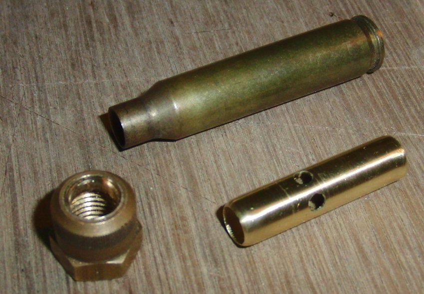

I tried to compressed the seal by adding a chamfered tube for my cartridge project like so:
Hooked up to my paintball tank at 800 psi the BB failed to pop though.
What I can do is try to crimp the mouth of the cartridge incrementally like so and see if that makes a difference, maybe using a drill chuck or by forcing into a suitable conical bore.

Fair point! Though now that I think about it, hammering the cartridge nose first into a tapered bore should be a good way to increase pop-off pressure, still at work but I'll give it a go when I get home, before I make any radical modifications to the breech and action.
edit: here's the v1.1 cartridge with a crimped nose (down to 5.4mm from the original 6) by hammering it into the fitting illustrated, and a 5.56mm cartridge for scale ;) I don't know how much of a difference it will make, watch this space
