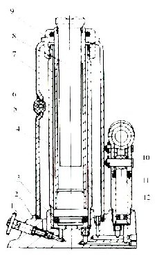

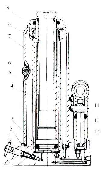

I had an idea for a really really high pressure pump made out of a bottle jack. I bought a bottle jack from canadien tire to have a look at it (it was on sale for $10). The pump has a small diameter and a lever like those old water pumps. You may say it is made for oil and scince that is incompressable check valve placement would be an issue. Well it would be because on the diagram I found on google images shows that the check would be at the base of the hydro cylinder a bit away from the pump creating dead space if it was use pneumaticly. Maybe you would be able to cut the pump off and use your own check valve I don't know. It would also olny be able to fill little chambers to high pressure but even that would be powerful. Just throwing my thoughts around. EDIT: I think that there is a check valve right at the base of the pump shaft that I didn't notice before I guess you could put the output on that tube.

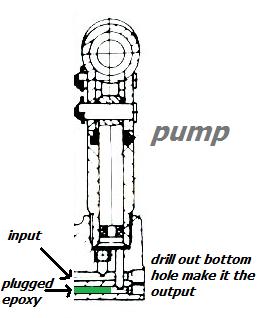

I don't think it would be very dangerous with the pump lever and the small diameter and the short sroke. I think I might do this with my hydrolic jack could get interesting results. Any ideas about how I should go about this?
EDIT: I have an idea

Mon Feb 02, 2009 10:11 am
Then there is only one way to find out! Go ahead and do your thing.
If you can take it apart and look down onto the dead volume you could try to fix that up with a bit of epoxy.

I am not sure but i would be careful with hpa and epoxy, expecially pluggig holes with it, i am afraid it could either shatter or be puhed out(seeing as how all he tubes will be lubricated), so clean very well before using the epoxy i guess, i am not sure at all if the epoxy can handle such pressures though...
