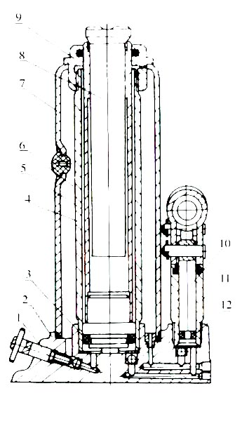

I had an idea for a really really high pressure pump made out of a bottle jack. I bought a bottle jack from canadien tire to have a look at it (it was on sale for $10). The pump has a small diameter and a lever like those old water pumps. You may say it is made for oil and scince that is incompressable check valve placement would be an issue. Well it would be because on the diagram I found on google images shows that the check would be at the base of the hydro cylinder a bit away from the pump creating dead space if it was use pneumaticly. Maybe you would be able to cut the pump off and use your own check valve I don't know. It would also olny be able to fill little chambers to high pressure but even that would be powerful. Just throwing my thoughts around. EDIT: I think that there is a check valve right at the base of the pump shaft that I didn't notice before I guess you could put the output on that tube.

I don't think it would be very dangerous with the pump lever and the small diameter and the short sroke. I think I might do this with my hydrolic jack could get interesting results. Any ideas about how I should go about this?
EDIT: I have an idea

It would be easy to add lube through the input.

Then there is only one way to find out! Go ahead and do your thing.
If you can take it apart and look down onto the dead volume you could try to fix that up with a bit of epoxy.

I am not sure but i would be careful with hpa and epoxy, expecially pluggig holes with it, i am afraid it could either shatter or be puhed out(seeing as how all he tubes will be lubricated), so clean very well before using the epoxy i guess, i am not sure at all if the epoxy can handle such pressures though...
The handle on a pump like that gives you an advantage, like a lever. Say for instance 10 to 1. If you put 10 lbf on the handle, it pushes the piston down with 100 lbf. Say the piston is 1/4" total area. That will give you 400 lbs/in^2 in the hydraulic fluid, max. It pumps into a larger cylinder. Lets say that cylinder has a piston with a face of exactly 2 square inches. This means that you can lift, or push a load of 400 lbs/in^2 x 2 in^2, or 800 lbs.
The pressure you are going to want will have to be generated on the outside of the jack. Using the jack to push against another piston and cylinder setup with a check valve into a small tank. The jack and cylinder will have to be placed in a strong frame to allow the pressures to work. What you're looking at is a hydraulic press, like for use in pressing bearings. You would probably have to unload the jack and start over to finish pressurizing your tank, depending on the size of the tank/charging cylinder, maybe several (hundred) times. A 4" steel pipe with a piston, check valves and return spring would eliminate a lot of repetitive unloading of the charging chamber.
To get 500psi into 1 cubic inch you would have to compress 34 cubic inches of air. A pump up gun with a small cylinder, a large stroke, and a large lever would be easier to use, even though it may take 34 strokes with a total volume of 1 inch in the cylinder. But, the hydraulic pump would take at least that many strokes to do it as well.
