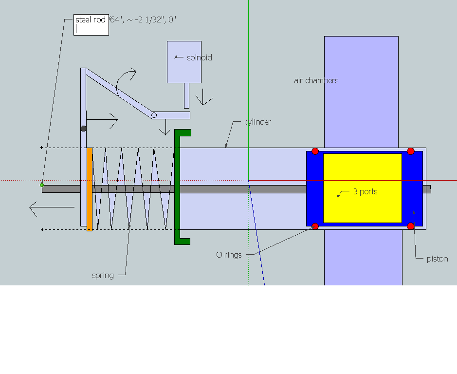

here is my first draft of trigger mechisim.
A fork is holding the spring against the cap.
the solnoid pushes the klever thus releasing the fork thus triggering the piston back.[img][img]http://i992.photobucket.com/albums/af44 ... rigger.png[/img]
curde but basic idea.[/img]

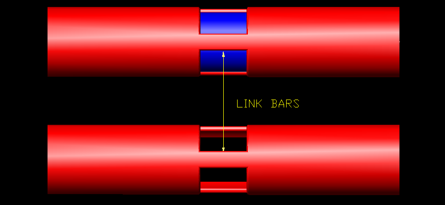

several questions
What are these link bars that Technician1002 talking about on his piston to keep the O rings on
Poland-spuds idea of a ported air chamber to trigger the rod to move back is good BUT maintaining the seal on the rod moving in and out? A rotating rod seal is easy but in and out, different animal for sure.
may just go with the spring trigger.
on the piston cylinder using galvanized pipe, I hope you are using a cylinder hone to get a smooth interior wall?
I was contemplating on using muffler pipe?
just need to do some welding.

Here is an explanation. Note there are 3 of them.MrDEB wrote:several questions
What are these link bars that Technician1002 talking about on his piston to keep the O rings on..
Click to elarge
- "LINK BARS' IN PIPE
- link-bar.png (17.12 KiB) Viewed 5515 times
