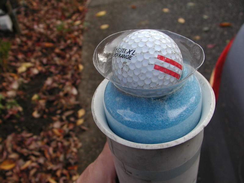

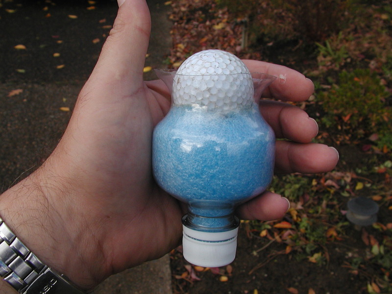

You may wish to find your basic design accuracy before investing highly in precision. Sometimes buying a micrometer to use with a chainsaw is a poor investment. Start with the basic build and lob a few rounds. See if they land within 5 yards of each other, then you will know the level of accuracy you are working with in your launcher. Playing with an attempt at precision golf ball launching showed the first thing needed was getting the launcher to have high repeatability at all ranges. Dropping a golf ball into a bucket at 10 yards isn't easy.
Friction in a barrel adds a huge variability. I had to discard a foam sabot for that reason and went to a freely moving rigid sabot for repeatability.

Like Tech said, reproducibility is the key and friction between the ammo and the barrel may be the trickiest thing to get to be consistent.

thinking of a foam sabot (sabot = something like wadding in a black powder rifle?)
