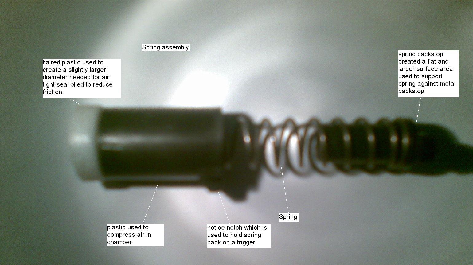

Helo. I really need some plans of the inside of this kind of gun. I am a NOOB so make it clear.
oh and it has to be whit a spring.
THANK you all
First bb rifle/sniper need help

u need a spring, a piston, a chamber for the piston to slide in, a small bore barrel. Design it to these limits: small sliding movement of piston (esp if barrel isnt long). Very high spring tension, lightweight as possible piston.
the exact design is up to the personal tastes of the builder. Id say an inline system would yield most power, but an over under design woudl give u a recoil feel as the piston bottoms out

while i would prefer a fully auto bb gun using an air compressor, what sniper josh is saying is correct, also note that your maximum projectile velocity will be severly limmited i would say around 120 - 200 FPS for a 0.012 g projectile (std BB gun ammunition) approx. 20FPS slower for the heavier 0.2 g projectiles. anyway here are some pics of the internals of my BB gun, this should give you some ideas on how to create yours. n.b. i have left out the trigger mechanism as it is very complex in my BB gun i also lack plans.
sorry abould the shocking quality
i forgot to mention that you should aim to have the lightest materials possible in the construction of your means of compressing air as it is required to mover very fast to generate any considerable pressure
