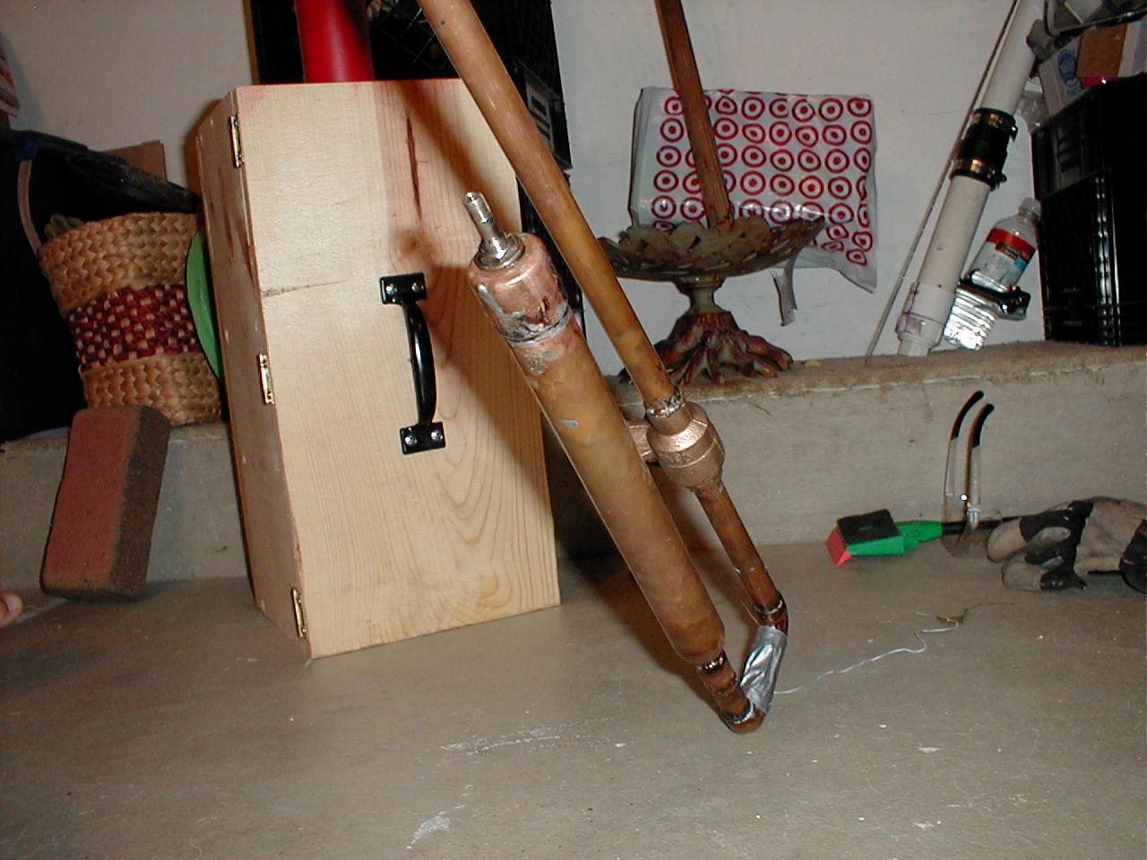

i used one on my first pneumatic which i still need to post... anyway they work great. if you want to put a filling valve on it you have to cut off the back and get an end cap the same size and stick the valve through the whole drilled on the end cap. i will get pics of my gun in a sec. it works great though. i recommend it.
heres a pic of my messy soldering.
here is the chamber with the end cap on it. it works wonderfully. oh and the duct tape is protecting me (there was a sharp piece of solder (sp?) that cut me so i just taped it).
