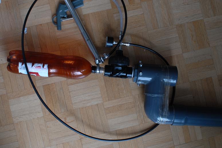

I have completed assembly of my Schweizer-Valve. It's a 63mm barrel leaking/sealing tee valve, hand made in Switzerland.
OK it did not quite seal. I could see that by placing a powerful lamp at the barrel port, and looking into the chamber port. I wanted to be sure that was in order before solvent welding on the chamber - after all, access to the valve seat is best from the chamber port. So I just siliconed the chamber on, assuming that I could just tear it off again, or maybe that it would shoot off by itself as soon as the thing was able to hold a little pressure.
Problem: Valve seals beautifully (well opening and bumper are not tested), and the chamber is stuuuuuuuuuuuuuuuck in the tee.
What the sch%ç&*!! can I do? More pressure? It would probably just do damage to itself and its surroundings when finally coming off.
Well I have these 40 ft of hose .. guess I have to dump the gun in a scenic Swiss lake, discretely inflate it from 39ft away, and pretending to have nothing to do with the depth charge like blast that will follow when I finally the enough pressure on it.... (but the damping effect of the water should keep the valve intact)...
ARGH. To have to put a hacksaw on a new and working valve....

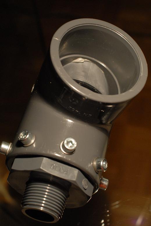

- What not to do ... chamber is siliconed on, "so I can just test and remove it if necessary".. Right. I have too slow flow from the pump to get it to seal properly, so that is why I put the 'bird on the wrong way around: To slam the piston shut with air from its chamber. Unfortunately, I don't have a second bird around to trigger the main gun.
OK, next time I take it apart...

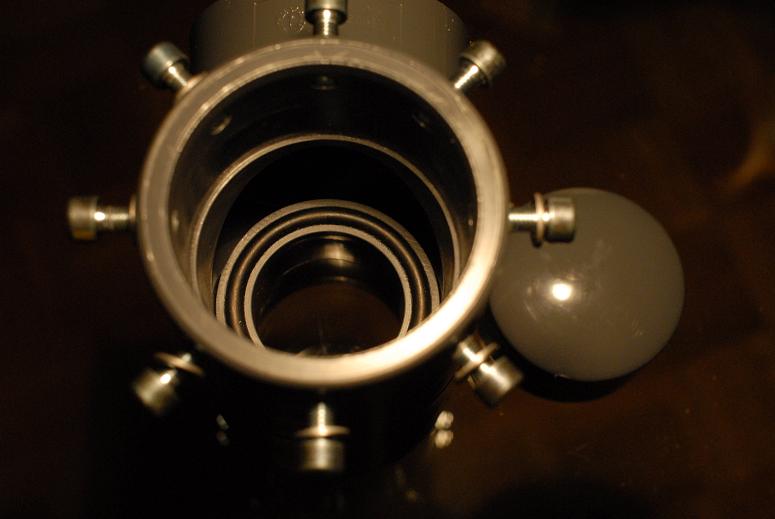

It's a 50 mm ID / 60 mm OD curved end cap == piston.
Thick 62 mm rubber gasket thingy == bumper
A 63 mm OD to 1 inch threaded reducer, with a 50 mm to 40 mm reducer glued into it == end cap. A groove is cut for an O-ring.
The valve seat is a 50 mm bushing (I think it is called -- a female to female thing for joining pipes) cut in half, with a 50 mm to 40 mm reducer glued in. A groove is cut in it for a 43.82 mm ID x 5.34 mm O-ring.

Hi,
Finally, I managed to twist loose the silicone and then blast off the chamber @ 1 bar ... will now weld it on properly. (I can't find any good threaded fittings to cut apart and use for threaded sockets in the valve).
The piston fits so damn well in the tee body that no extra sealing on its sides is necessary. It's almost as if the designer of this series of parts is a spudder himself. Just needed to grind a tiny bit of material off the inside of the tee body; it is not quite round. And anyway, in a barrel sealer, the seal between the main chamber and the pilot chamber is uncritical; as long as it leaks less than an open sprinkler valve it is OK
The piston seals against the seat at the end of the barrel with the said 43.82 x 5.34 mm NBR 90 hard-rubber O-ring, yes.

PS: Can anyone tell me if my bumper is too small .. .. it is about 10 mm thick (argh, there is no good view of it on any of the pictures).
The alternative is 2 softer dampers of each 6 mm stacked, but that will impede piston travel somewhat.

It is probably OK as it is, but why dont you cut the hard bumper in half, and cut a soft bumper in half, glue them together... and Viola! (This might be a very stupid idea though!)
I think the hard one should be fine though.

Naaah I don't like to make irreversible changes to parts, assuming without really knowing, that something is wrong with them
The piston is very light compared to those solid epoxy ones and what else we see, and the end cap is heavy. That lead me to assume (hmm) that if anything will get smashed, it is the piston. So I'll try to go with just the hard damper right now.
Waiting for the PVC cement to cure now .. 24 h. After sitting with pressure on for an hour, the valve now seals with just the air from the bike pump alone.

Hi
The piston is a PVC end cap with a rounded end. ID is 50, OD is 60 mm.
I might want to fill it up with balsa wood in a restless moment, to reduce pilot volume. But there should really not be any need of that.

Yeah, I would fill it with something light to reduce pilot volume, it makes quite a difference actually. What you can also do is fill it with foam, then make a thin hot-glue layer on the top to seal it off, it works well.

Jam a piece of round PVC sheet into it.
